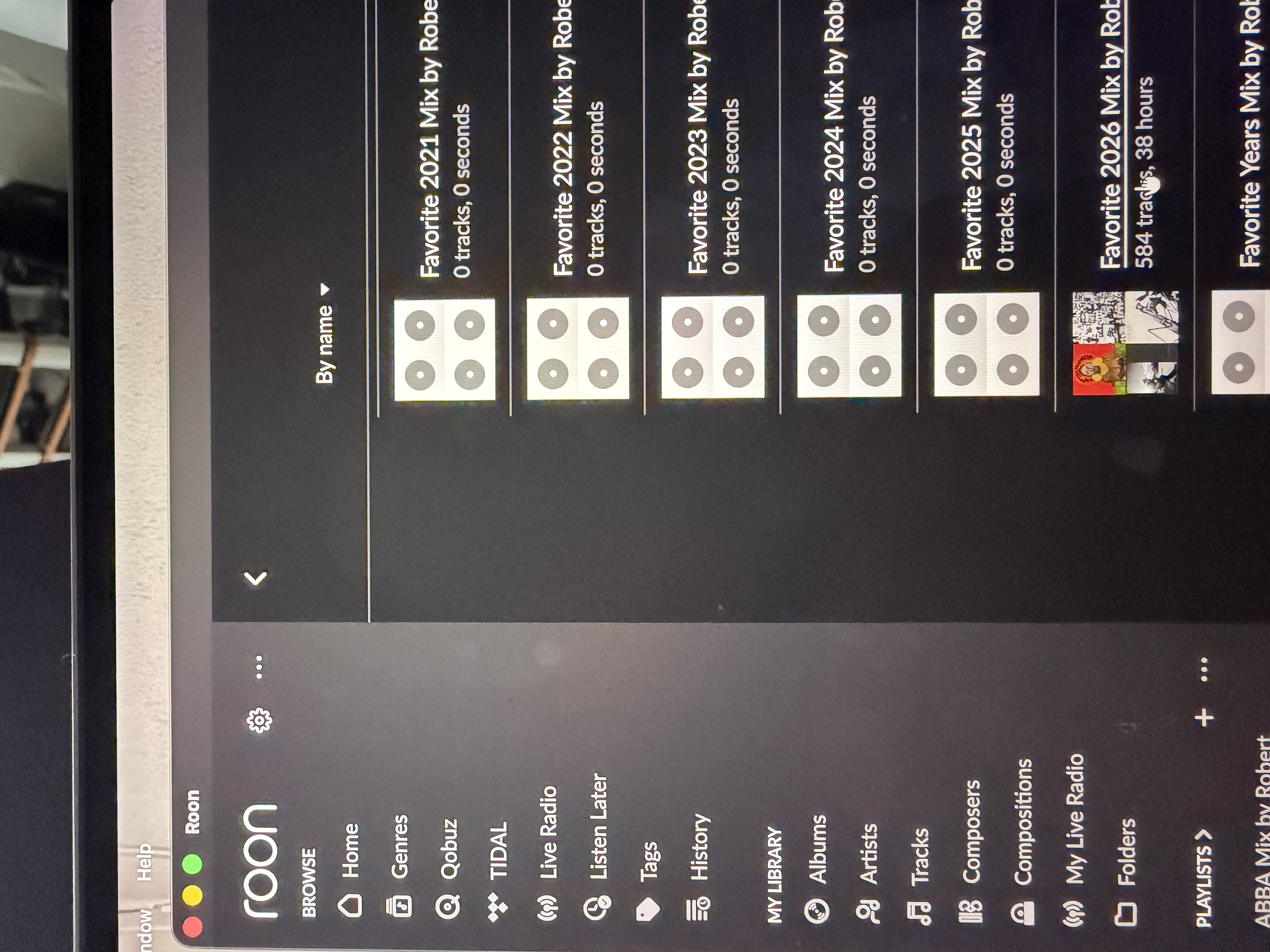

·I am experiencing a problem with Qobuz playlist synchronization in Roon.
I have approximately 130 playlists in my Qobuz account.
When I navigate to:
Roon → Qobuz → My Qobuz → My Playlists
all playlists are displayed correctly, and every playlist contains the expected tracks.
However, when I navigate to:
Roon → Playlists
only 9 of the 130 playlists contain their tracks. The remaining 121 playlists are listed but show 0 tracks.
All playlists are present and fully populated in both the Qobuz app and under Roon → Qobuz → My Qobuz → My Playlists, so the issue appears to be limited to how they are synchronized into Roon’s Playlists section.
The playlists are visible in both locations, but only the playlists under Roon → Playlists lose their contents. This suggests the issue is not with Qobuz itself, but with the synchronization between the Qobuz library and Roon’s internal playlist database.

Additional observation: Since reporting the issue, I have noticed that the number of playlists containing tracks is (very) slowly increasing. Yesterday only 7 playlists appeared correctly under Roon → Playlists; today that number has increased to 13 without any intervention.
I also noticed that playlists I recently modified in Qobuz (by adding or removing tracks) are among the first to reappear with their contents. Likewise, several Qobuz editorial playlists that are updated regularly also contain tracks. Older playlists that have not changed remain listed but still show 0 tracks.
This makes me wonder whether the background synchronization process is stalled, incomplete, or only updating playlists whose modification timestamp has changed.
Additional troubleshooting:
I created a brand-new Qobuz playlist containing five tracks. It appeared immediately under both Roon → Qobuz → My Qobuz → My Playlists and Roon → Playlists, including all tracks.
This suggests that creating and syncing new playlists works correctly. The problem appears to affect only existing playlists that were already present before the issue started.

Important update
I have discovered a potentially serious issue while troubleshooting.
One of the affected playlists originally contained approximately 700 tracks in Qobuz but appeared as an empty playlist (0 tracks) under Roon → Playlists.
To test the synchronization, I added two new tracks to that playlist in Qobuz.
After opening the official Qobuz app, I found that the playlist now contains only those two newly added tracks. The original ~700 tracks are no longer present.
I have stopped all further testing to avoid any additional data loss.
At this point, I cannot determine whether this is related to Roon, Qobuz, or the synchronization process between them, but I wanted to report it immediately because it may be important for the investigation.
Please advise before I make any further changes.
Important clarification
The two tracks were added from within Roon, not from the Qobuz app.
At that moment, the playlist in Roon → Playlists appeared empty (0 tracks), although it still contained approximately 700 tracks in Qobuz before the change.
After the synchronization completed, the Qobuz playlist itself contained only the two tracks that were added from Roon.
I have now stopped the Roon Server to prevent any further synchronization until I receive guidance.

Hey @Robert_Kuijs,
As @Suedkiez mentioned, we are tracking this issue here:
Do you have any backups of your Roon database from when the playlist was at 700 tracks? In the native Qobuz app, how many tracks are showing for that specific playlist? Please do not make any further edits to your Qobuz playlist until this issue is resolved.
Hi @noris, thank you for your response.
Yes, I have automatic Roon database backups from 1, 3, 5 and 7 days ago. I have not restored any of them because I wanted to preserve the current state until I received your guidance. I believe at least one of these backups was created before the incident, when the playlist still contained approximately 700 tracks.
In the native Qobuz app, that specific playlist currently contains only 2 tracks.
As requested, I will not make any further edits to the Qobuz playlist until this issue has been resolved.
Could you also advise whether a Roon database backup contains the complete contents of synchronized Qobuz playlists, or only references to them? I would like to understand whether restoring a backup could potentially recover the original playlist if necessary.
Hi @Robert_Kuijs,
As it stands right now, even restoring a prior backup will result in the current issue. This is beacuse Qobuz will perform a fresh re-sync that will revert any changes made to it’s current status.
Less than ideal for sure, but we’re aware of it and working with Qobuz on a fix. Any updates will be posted to the issue tracking thread linked above.
Thanks so much for your ongoing patience in the meantime. :+1:
