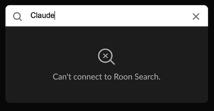

My roon is accepting ´ima´ or ´imag´, but have the very same thing happening with typing ´Clau´, ´Claud´ or `Claude´ - the moment I type the last ´e´, roon search cannot connect:
I suspect it has to do with my roon search not liking ´Debussy´ or `Claude Debussy´, although he is showing up in the results when typing ´Claud´ as hit No. 1. Maybe it has to do with an overflow of results or the cooperation of local plus cloud search or something with not being able to filter relevant results. Highly speculative, of course.
I get a response that looks right for all , ima, imag and clau, claud, claude
