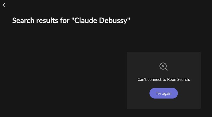

I experienced a similar issue with a different keyword. ´Bill Evans´ works instantly with all desired results. My roon seems not to like ´Claude Debussy´, on the other hand:
Seems to be a pretty selective issue as other queries which used to cause some delay with the previous builds are pretty fast today. In general roon appears to be pretty snappy and is really fun to use since build 1358.

My parallel problem with ´Debussy´ or ´Claude´ has been solved. Claude Debussy is back on the search list again and search is faster than ever.
Thank you very much @ Roon team!
