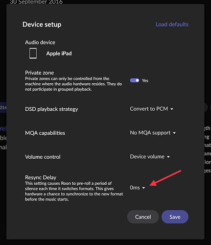

This “pop” problem has been reported a number of times and, in many cases, has been due to the change of bit rate and/or sampling frequency (track to track).
In these cases the solution was to increase the resync delay in device setup…it’s worth a try…
Ok thanks, I’ll try this :pray: how much time I should allow for the resynch?
I would experiment there’s nothing to lose, I started at 500mS and then played with the setting until the pop stopped using the minimum delay, fingers crossed :crossed_fingers:
Thanks everyone, I’ve come to a conclusion: the very small pops were caused by the WiiM amp going into sleep mode. I had it set to 30 seconds, so every time there was silence for 30 seconds, I’d hear a little pop. It’s not Roon’s fault then, I just had to set it higher. After careful testing, the loud noise at the start of a new album is only present if the album is in a different format. So this is a common problem for Roon users. Unfortunately, the resync delay isn’t any help and I’m guessing it’s the WiiM’s internal DAC that’s causing the noise (not too loud, I’ll settle for that). The only solution will be to have the Roon readiness for the WiiM Amp and I’m pretty sure that will come one day, but I hope that day comes soon :smiley:
