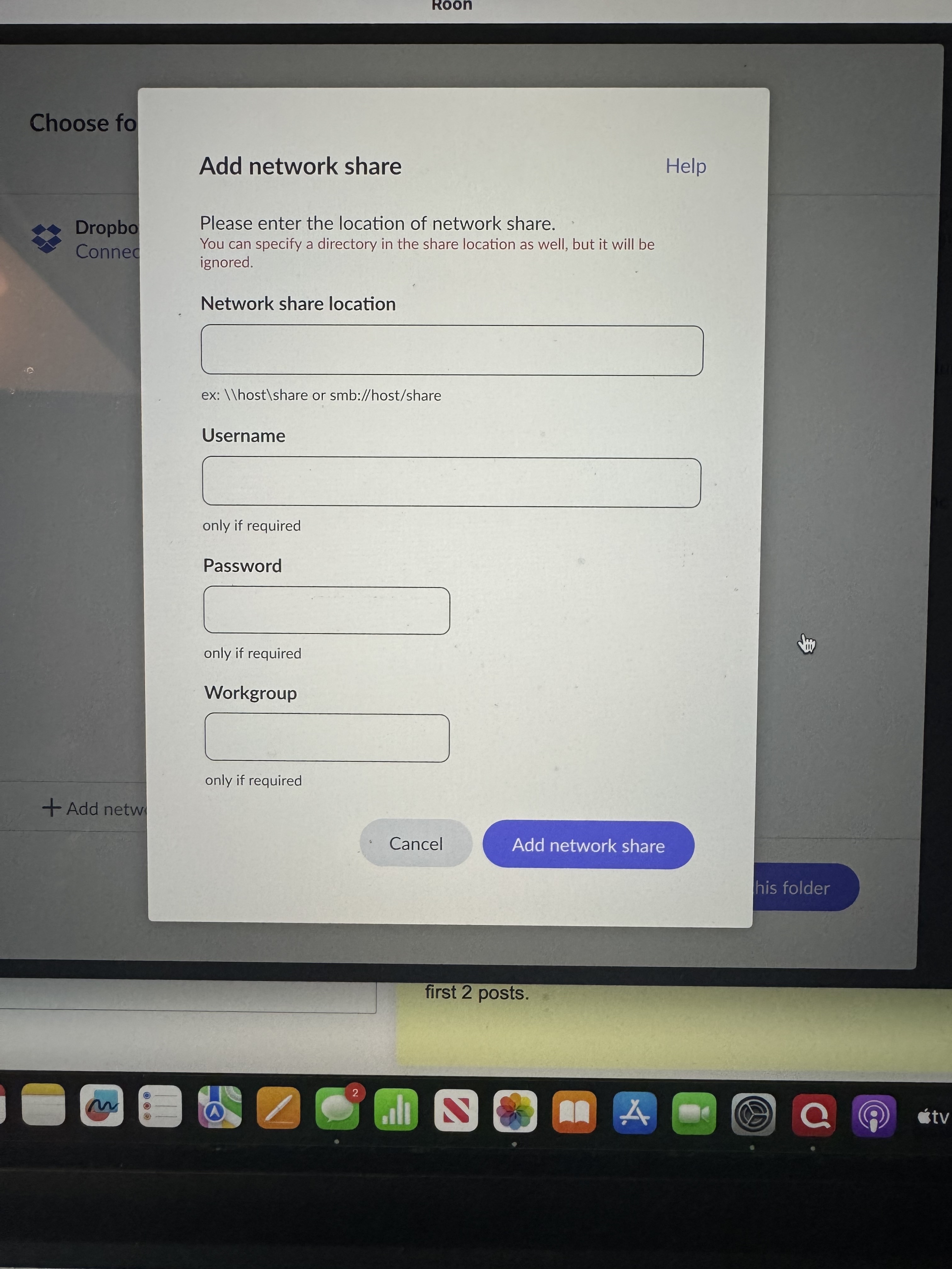

Thanks for the update. Can you please share a screenshot of the network share window from the Settings → Backup page in Roon?
The log trace we see shows the CIFS mount failing due to invalid permissions. It’s clear you’ve already checked, but I would double-check that you’re using the correct username and password once again and that they match what MacOS expects for this location. It might not be a protected location.

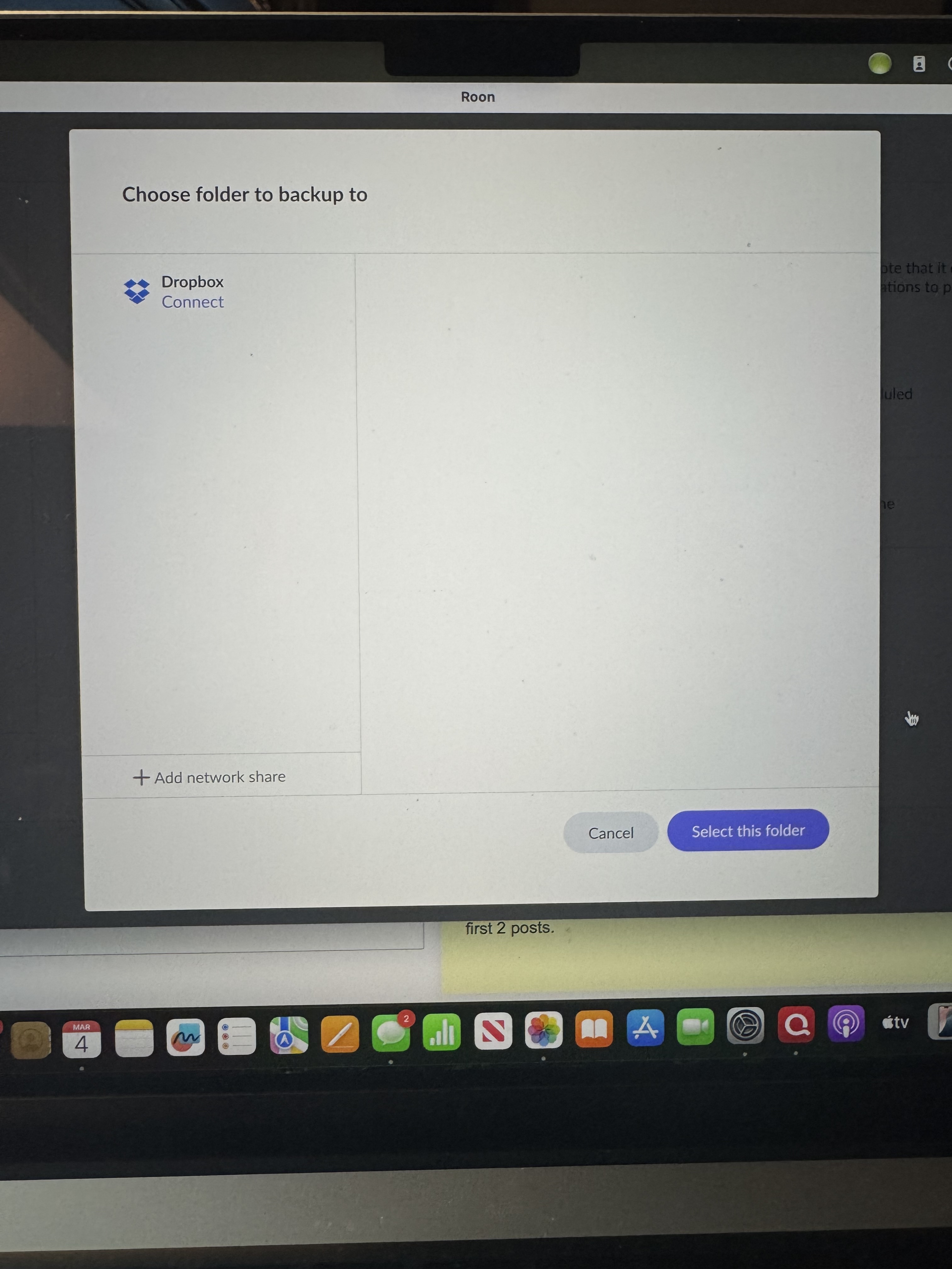

Hi Connor - Sorry for the delay. See attached. Is this what you were referring to?
If not let me know and I’ll get to the correct spot for an update for you. Thanks for your help!
Mark

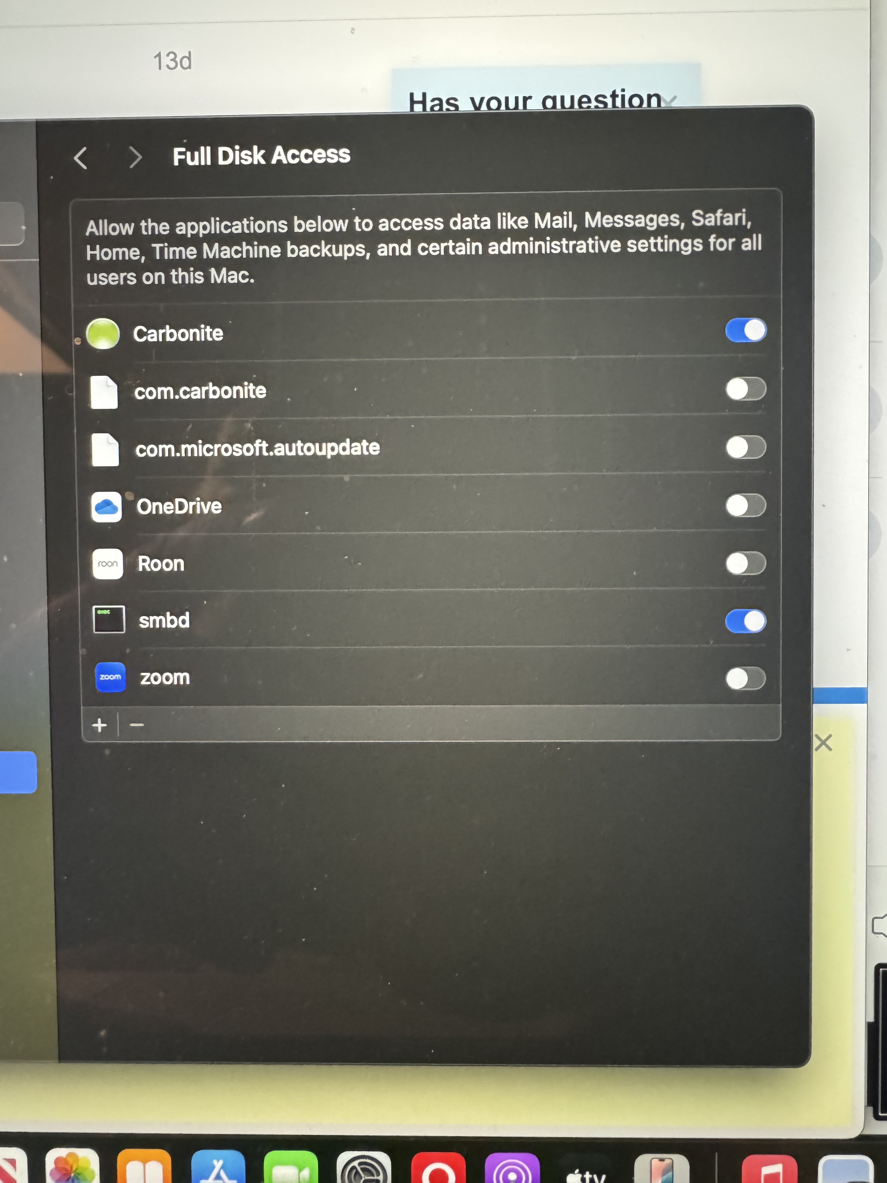

Just to confirm here, you’re trying to save the Roon backups to the Mac that you sent the screenshots from? If so, you’ll need to turn on Full Disk Access so that Roon can access the disk to save the backups to (+ removable volumes access if you are saving them to a hard drive).

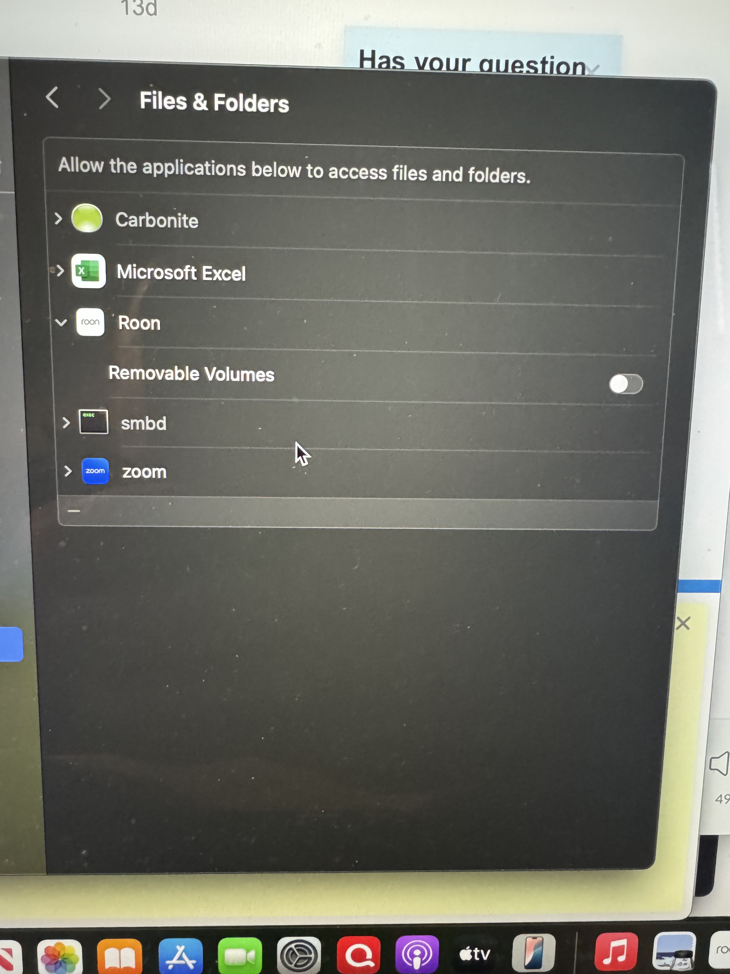

First head back into your Mac settings > Files & Folders > and toggle on Roon (removable volumes)
Do the same for the Full Disk Access settings > toggle Roon on
After that, reboot Roon and your Roon Server.

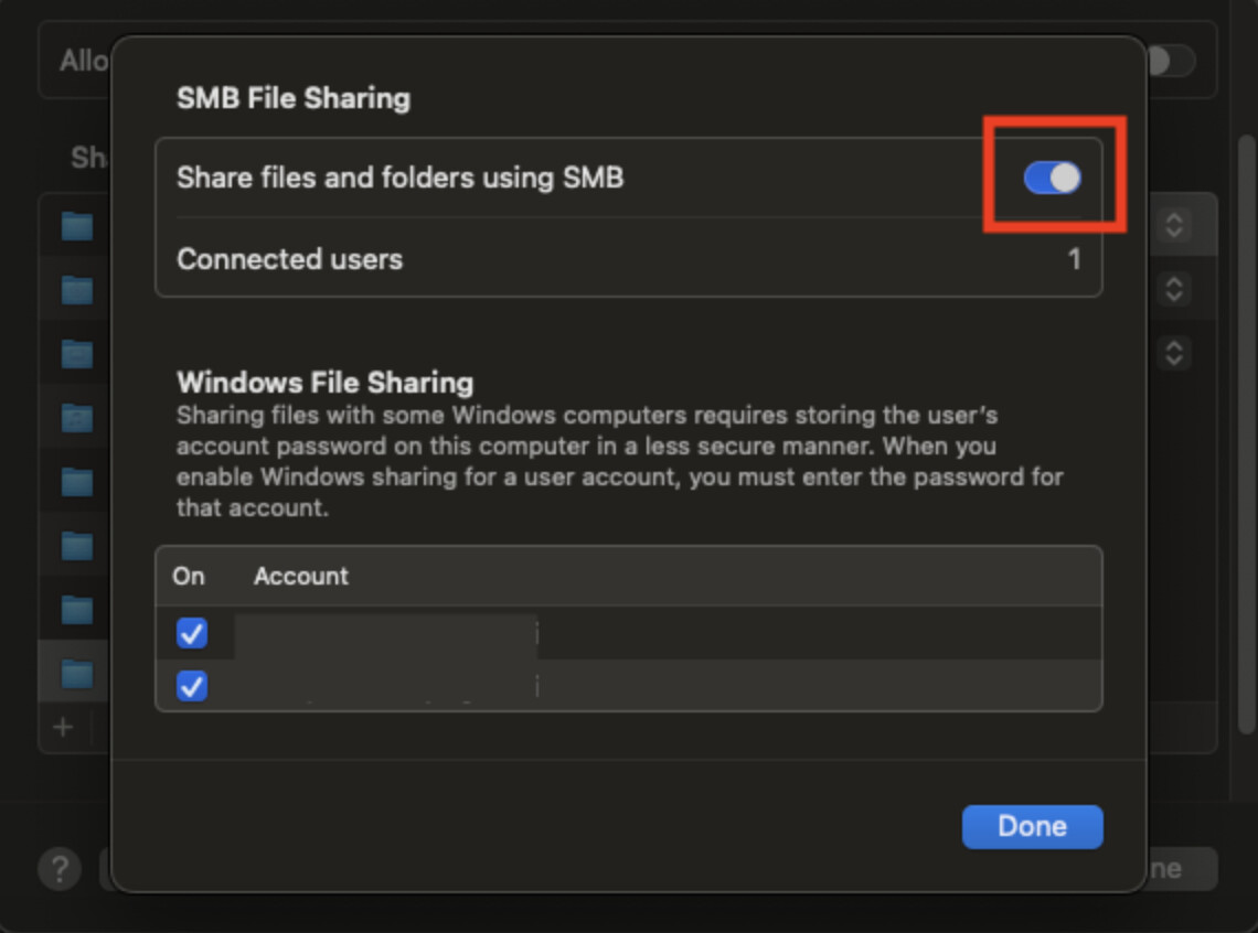

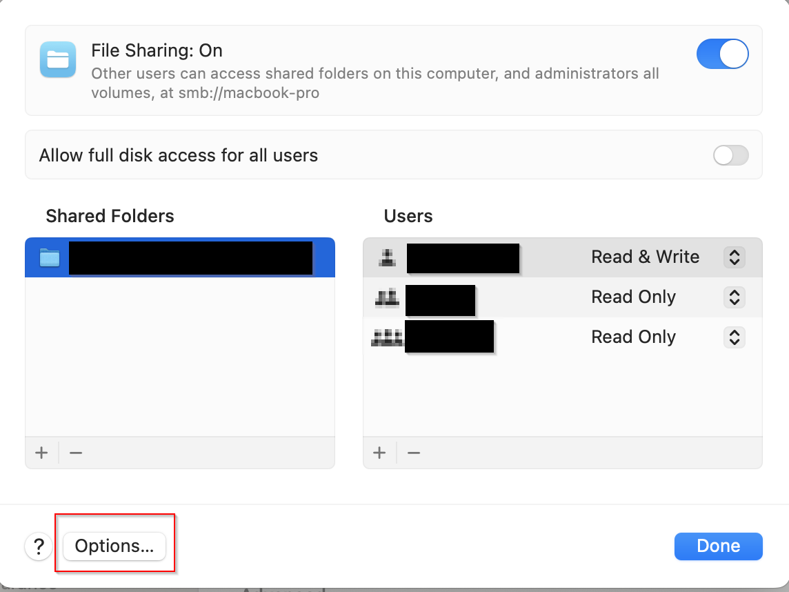

Great work with this! In addition to this - head back into your file share settings on the Mac. Sometimes it is helpful to re-enable Account specific Windows file sharing by clicking the checkboxes (see the image below) off and on again.
In your case, you’ll see your specific Mac user profile under the ‘Account’ area - toggle that check mark off and on again.
After all of this, see if you’re able to successfully set up your network share for your backup location. We’ll be monitoring for your results :nerd_face:

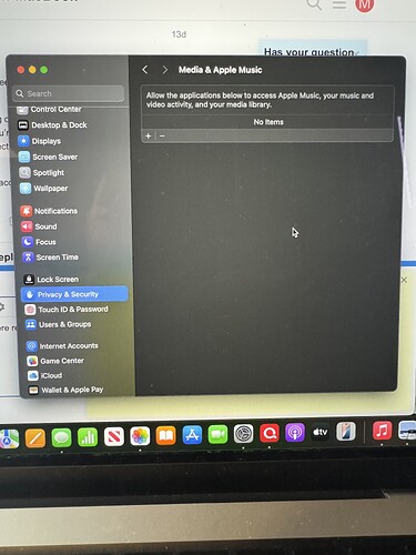

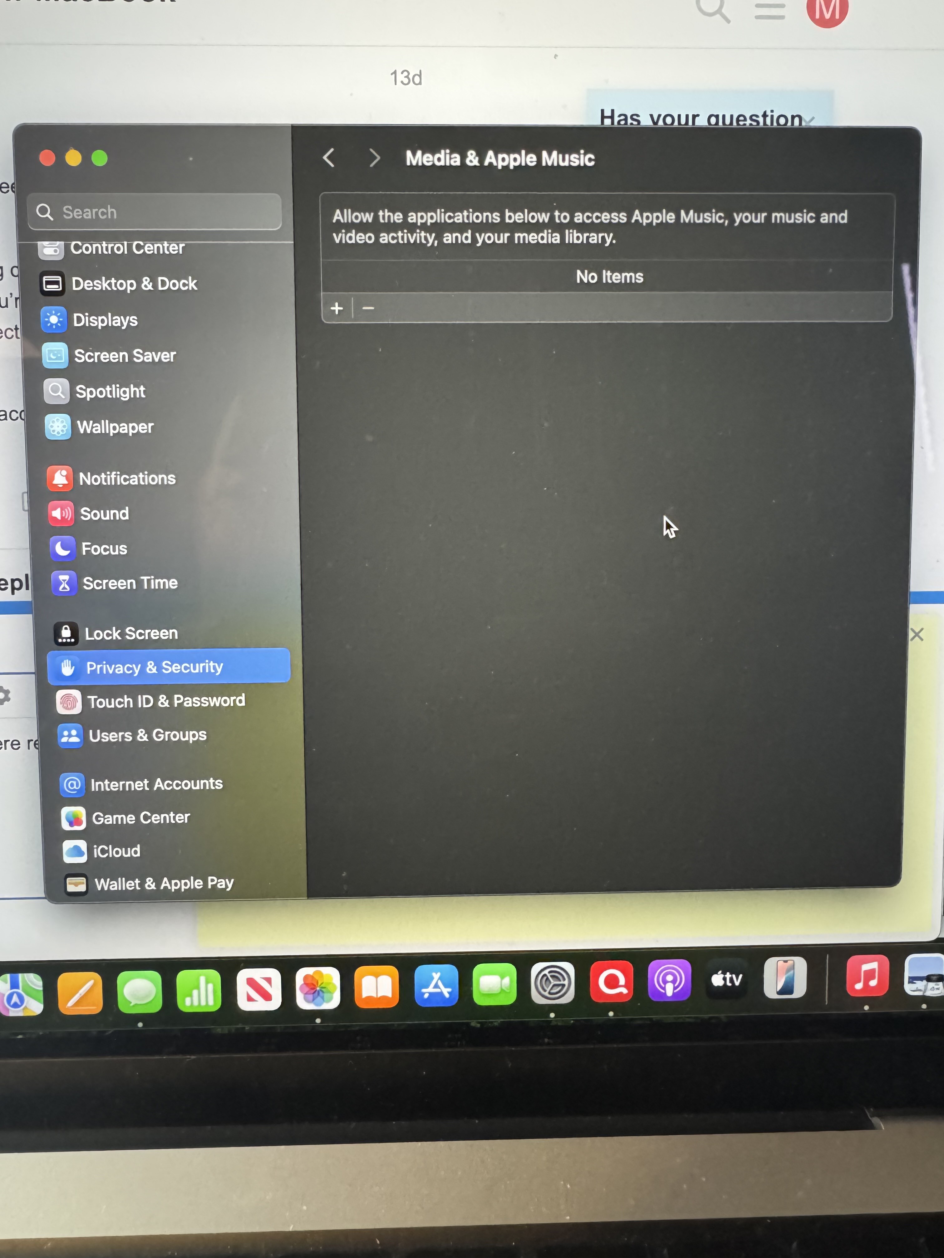

Thank you. I have enabled Full Disk Access for Roon, and restarted both the App and the Server. I have also enabled Roon Access to Apple Music and media library.

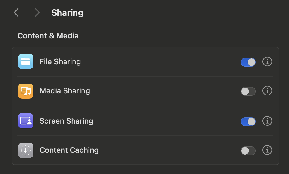

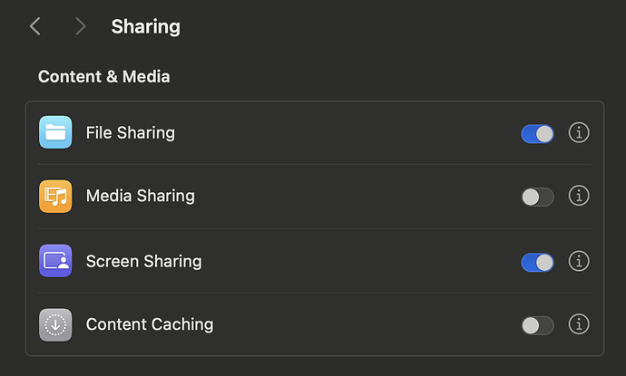

As for the next step, where do I access the area of settings that you reference in the screen shot above?
When I go to Settings > General > Sharing I see the following under “Content and Media.” I can’t find any settings for “share files and folders using SMB.”
Thanks.
Hi @Mark_Osborn,
You can find that screen by going to the Apple menu, selecting System Settings, then Sharing, and turn on File Sharing. Click Options and enable “Share files and folders using SMB” to allow access from Windows computers.
Let us know if you need any more clarification.

That error usually means that there is an issue with the host name or path that you supplied. Can you double check that you supplied the proper path?

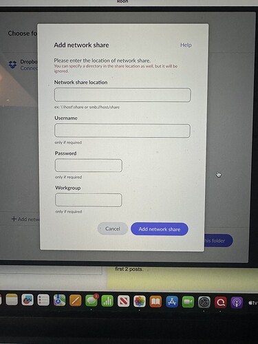

Hi - I’ve followed the instructions for adding the pathname that were supplied earlier in this thread. The folder I’m using is names “RoonBackups” and is located in Macintosh HD > Users > markosborn > Music. I’ve tried going to finder, opening the file folder location, clicking “Get Info”, copying the file folder location as a pathname, and pasting it (/Users/name/Music) into the network share location field in Roon settings.
I’ve also tried formatting as follows:
smb://Users/name/music
smb://Users/name/music/RoonBackups
\Users\name\music
\Users\name\music\RoonBackups
I get the same “host not found” message for all four entries above. Any guidance appreciated. Thanks.

Thanks for the update - sorry to hear your issues persist. A quick side note, based on the path you’ve shared:
I’d suggest keeping your backup location completely separate from your local library folder.
You’ll also want to include two brackets for host sharing, for example: \\host\share
It looks like maybe you’ve only included a single bracket based on your reply above. Let me know if this makes any difference! :+1:
