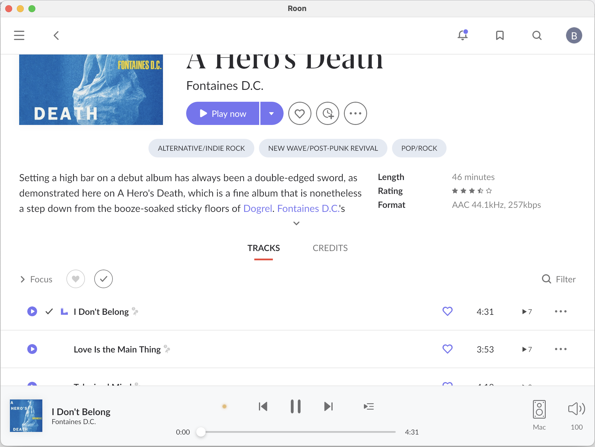

Hello,
Several of my records have stopped playing entirely. When I hit play, it gets stuck at 0:00. This affects different formats. Files are OK though: I can play them with other software…
Roon is updated. Not a client issue either, since the same problem affects the same records, whether launched from Mac, iPad or iPhone.
Thanks for your help.

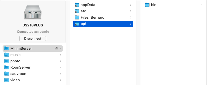

I was trying to install FFmepg, as per the thread recommended by @Mr.Flibble. Unfortunately, I’m unable to connect to the NAS server from Firefox (that’s new and I’m not sure why. It seems changing Macs broke many things). I can see it from the Mac Finder though. There is a bin folder located at: afp://DS218PLUS._afpovertcp._tcp.local/MinimServer/opt/bin
Is this where I should drop FFmpeg?

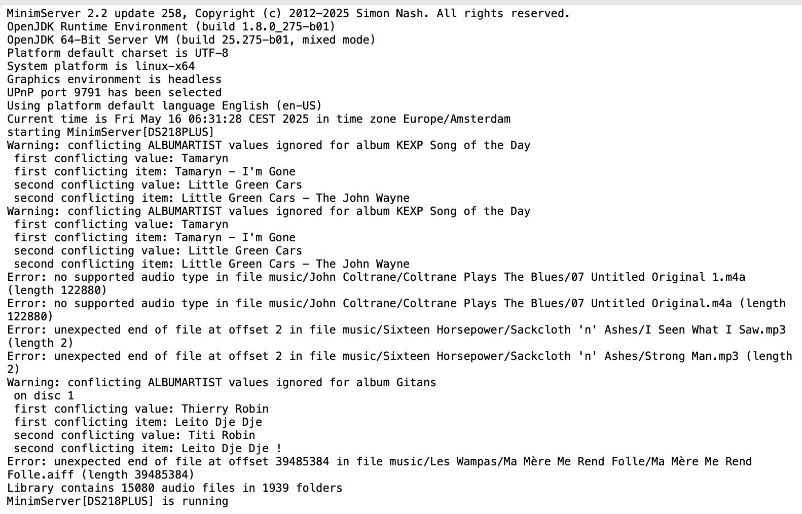

I attach a screenshot of the log file of the server just in case.

I put FFmpeg under MinimServer/opt/bin because it’s the only place with a bin folder. But RoonServer is in another folder. See picture.
Also, the thread I was pointed to mentions that I should chmod 755 for FFmpeg. I haven’t because, as mentioned above, I can find a terminal on the server. Can I do it on my mac before copying it to the server? That is, are privileges copied along?
