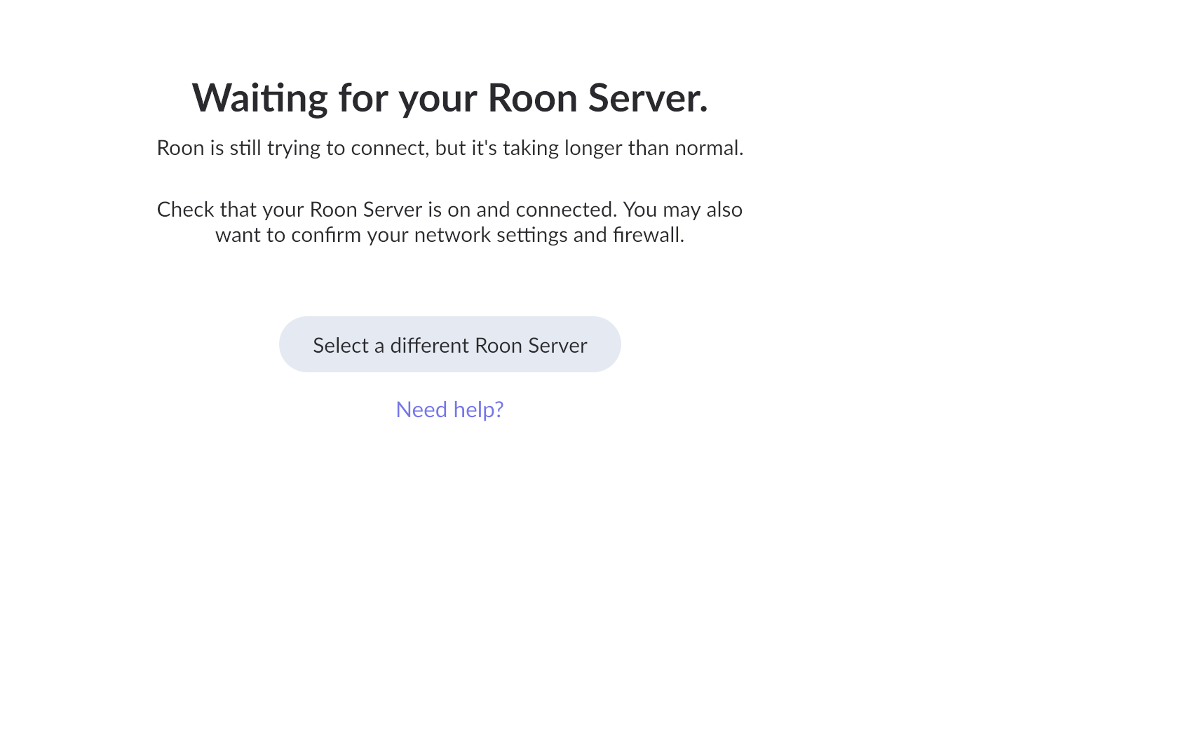

I'm not sure which Nucleus hardware version I have. I consistently have problems where Roon says it can't connect to the database. The only way to fix this issue is to unplug the Nucleus and plug it back in. Is there some more permanent fix that can obviate the need to do this?

The last time it happened was today (1/26/26) at 7:42 AM Pacific. When it happens, it’s an issue across all devices (my computer, iPhone, iPad).

Hi guys, this is probably getting beyond my technical expertise. I don’t see any of the settings you mentioned in the ASUS router.
I just had an issue at 1:50 PM PST. Can’t connect. I also can’t access my Nucleus through the web interface.

I tried moving the Roon directly to the router. Dropped connection after 30 min. Then I replaced the Ethernet cable. Same problem. It is currently connected directly to the router (which is hardwired to the modem). If I repower the Nucleus it’ll connect again, but only for 30 min. It doesn’t seem like having it connect to a mesh node was the cause of the problem.
