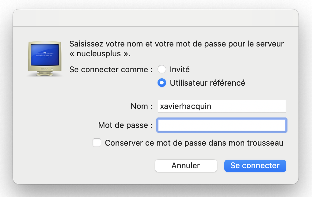

@Xavier_Hacquin, your image failed to upload. The point, @Suedkiez made is that the Nucleus does use a password for access or file shares.
There is no administrator user or password for the nucleus. The web interface requires nothing to access. To access its samba share to access music or system logs the user and password is guest . Nothing else on the device requires anything else.
Does not :wink: except guest/guest for smb file share, at least from Mac
That must be a relatively new requirement; never had to on my departed MBP 2016. I stand corrected! :smile:
I seem to recall that I had to use guest/guest on my macOS when I connected to ROCK’s file share for the first time, and the documentation also says so. But anyway, the main point for @Xavier_Hacquin is that there is no administrator password for the Nucleus :slight_smile:
Always been guest guest for as long as I have used ROCK on Mac or windows.
Well, I must be mistaken, but I stopped using macOS in 2019-2020.
@Xavier_Hacquin, please ignore our ramblings.

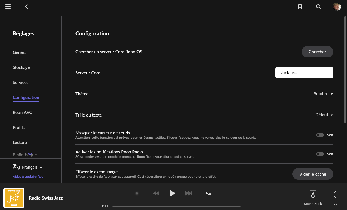

Hello and thank you for following.
My environment:

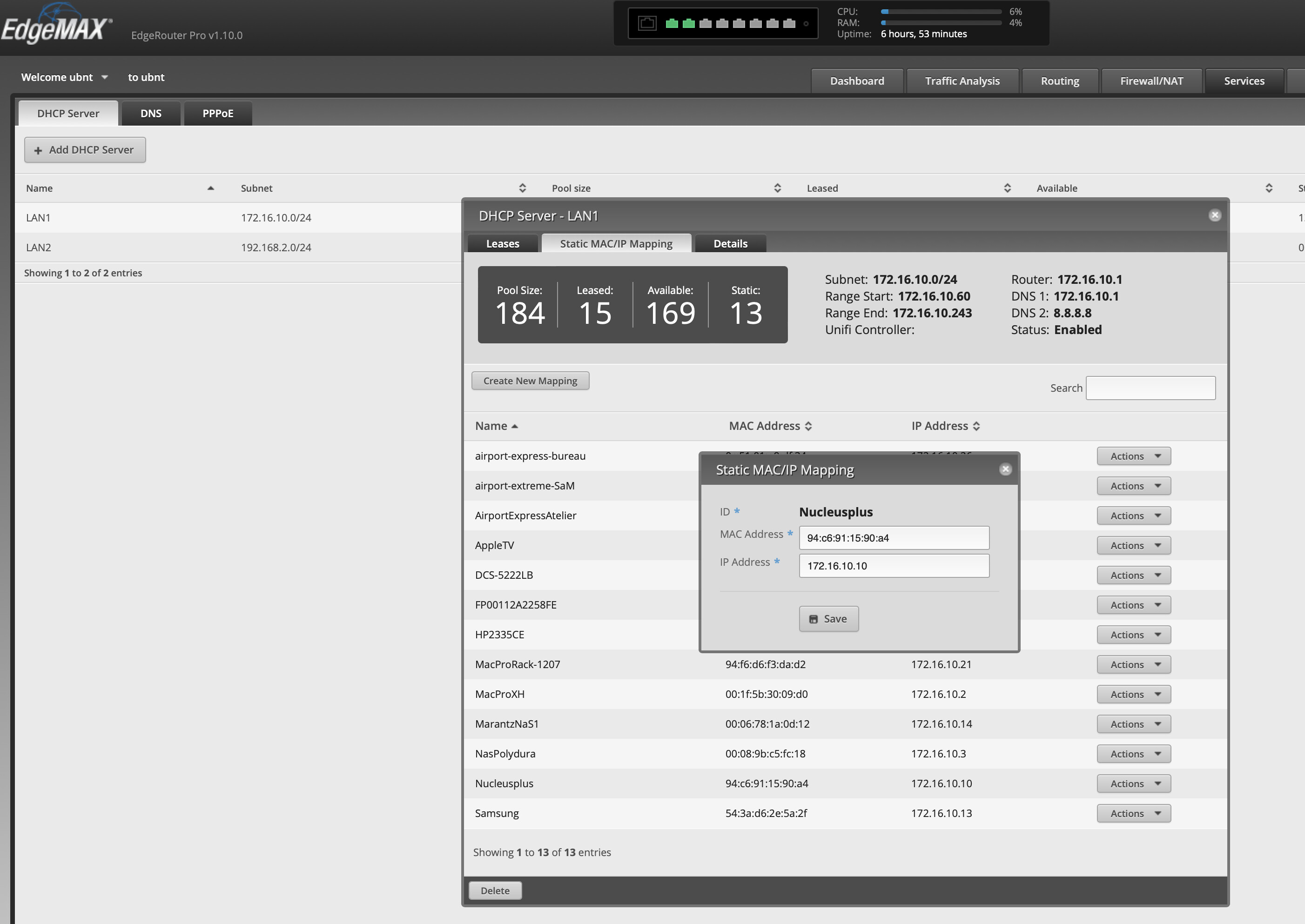

My ROON CORE (Nucleusplus (first version with 2 Terra SSD) is connected to my local network in Ethernet via fixed Ip address (static)
EDGE Pro 8 router followed by an EdgeSwitch 24.
WFI network provided by UNIFI terminals

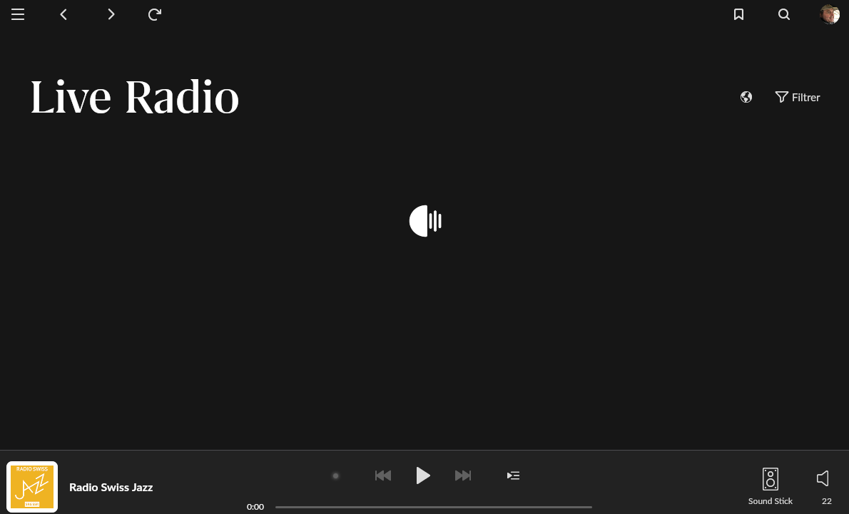

The Roon app periodically quits the connection with Roon Core.
After a quick message from the application telling me “waiting for Roon Core” it crashes and no more streams pass!
This happens both when playing Live Radio and a Qobuz playlist or an album from my library.
Then the application window remains frozen and displays 0 album, 0 artists
in my library You will receive notifications because you created this topic.
I was never able to use Roon Arc?? I can’t configure
If you can help me
This seems to be the login for SMB file sharing, when accessing the internal storage of the Nucleus. This should work by entering the username “guest” and the password “guest” as explained in the below link in SMB Connection (Alternate Option). You may have to select InvitĂ© in the login window as well, I think, instead of Utilisateur rĂ©fĂ©rencĂ©.

  2. Additional network dropouts likely arising from the way you’ve set up your LAN

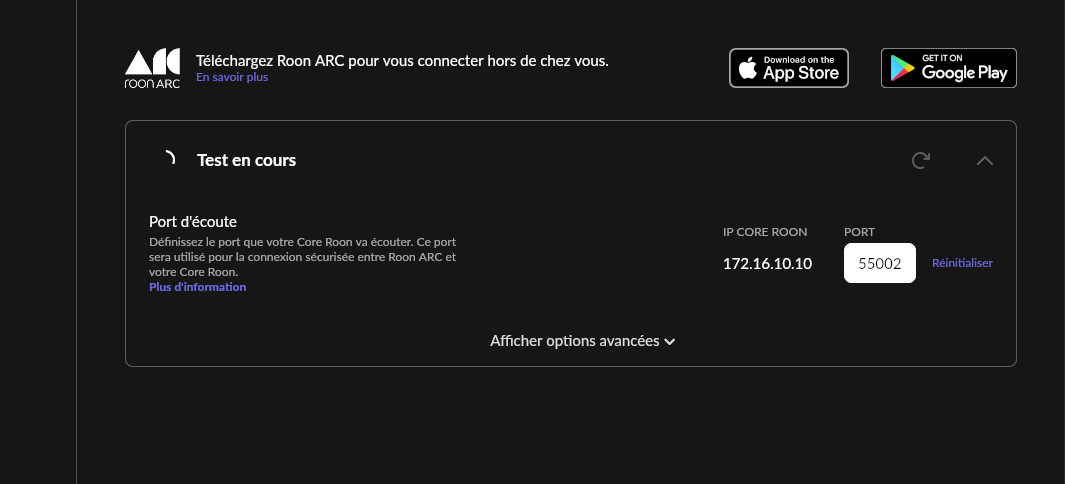

  3. Port forwarding failures with ARC, probably a secondary symptom of the broader networking structural problems in 2) above

Concerning issue #2, we need to identify where packet loss is occurring on your network. It’s more than likely that the managed switch is involved. At your convenience, please answer the following to help us diagnose what’s wrong:
  • Where in your network have you hardwired the Nucleus+?
  • Do you have any additional routers in this setup, like a modem/router combination provided by your ISP? If so, you’ll need to create a manual port forwarding rule identical to the one you’ve already created.
