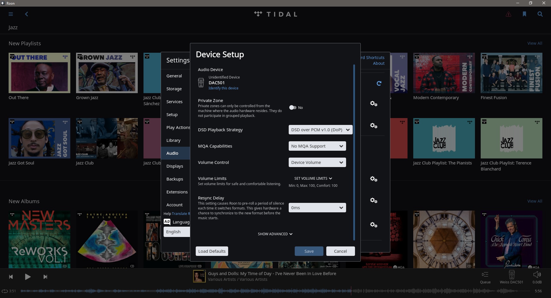

The next test, I remove the Concero HD from Nucleus and connect the Weiss DAC501 to Nucleus USB output. I named this “Weiss DAC501 USB” in Setting > Audio, so that it’s separated from “Weiss DAC501 RoonReady” zone. Reboot all devices in my system, Roon Nucleus, control on my Dell, and the DAC.
The Weiss DAC501 USB is identified in Setting > Audio but still appear as a Zone.

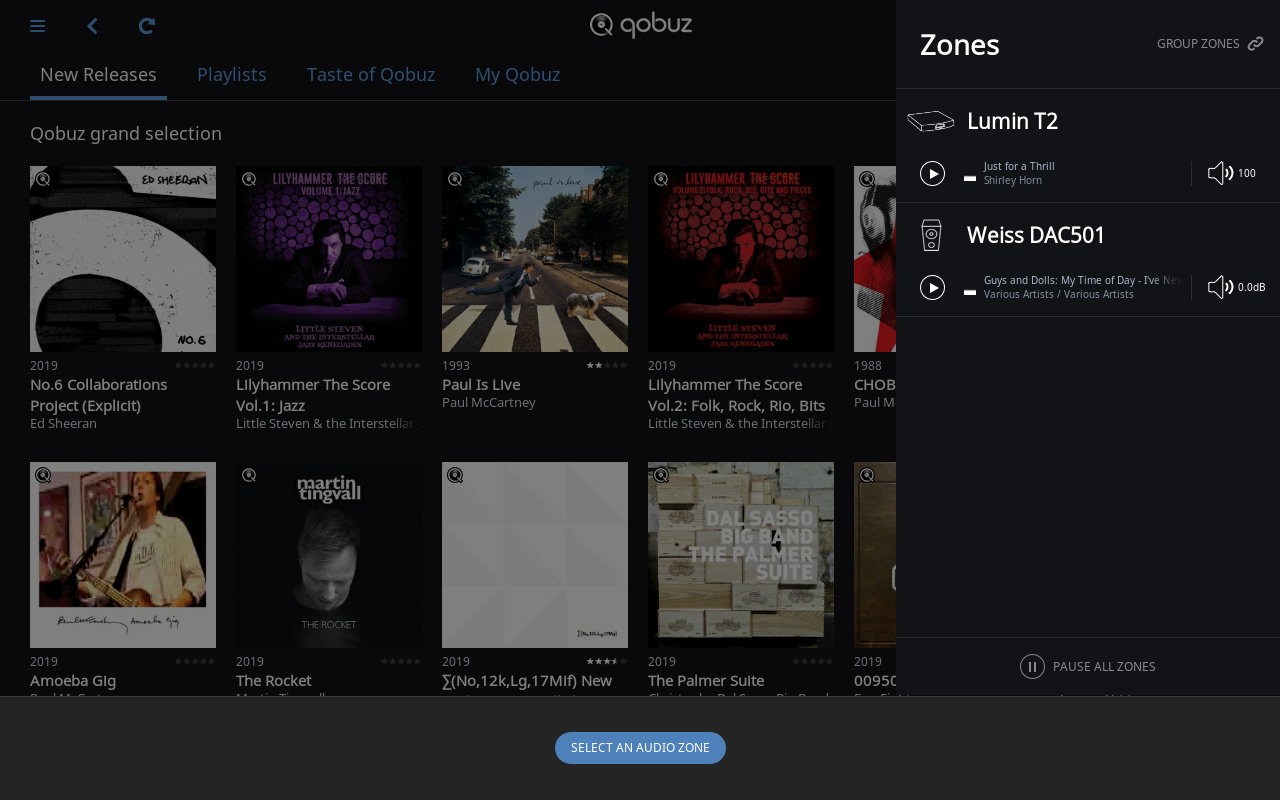

While this analysis occurs on our end, I am hoping to find out one other piece of info here. Can you let me know if other local zones work properly when you have your Mac set as the control device? Are you able to locate the Weiss DAC in the zone picker if connected to the MacBook? If you enable System output for the MacBook, does that show up?
I enable System Output for my MacBook, it doesn’t appear in Zone. I reboot Nucleus and Roon Server already. Still not appear in Zone. (I enable both System Output and Built-in Output.)
