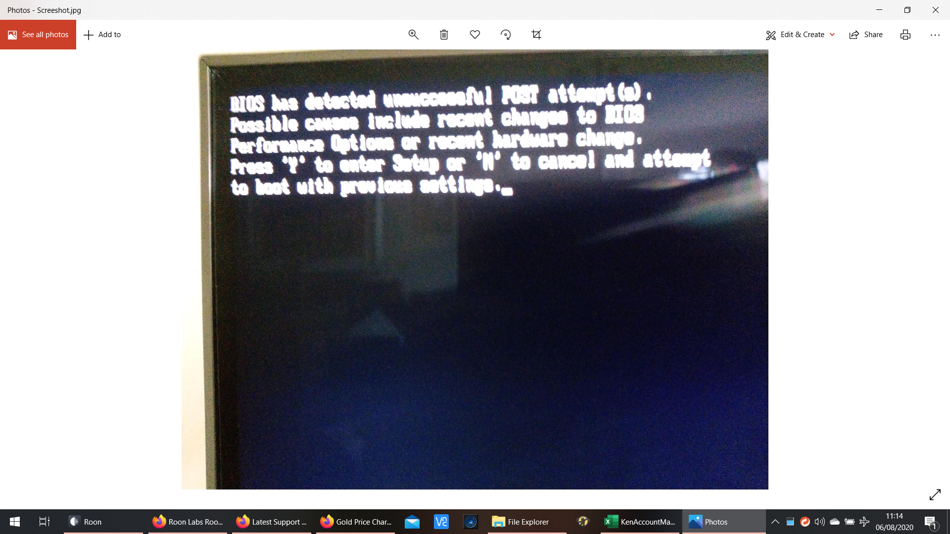

It would not reboot and I received the following message via an attached monitor
"TS120GMTE110S
S.M.A.R.T. Status Bad, Backup and Replace
Press F1 to resume"
On pressing F1 I received the following
Pressing either y or n did not seem to have any effect
But eventually this message appeared
This meant I could control ROON again via a remote

That looks like a disk hw issue?
I would try replugging the ssd drive and perhaps the ram module/s too. If that doesn’t solve the issue you might need to get an ram on the ssd drive as it appears to have perhaps the culprit here.
Agreed.
That message is coming from your drive’s error checking firmware.
Here’s one example -
Probably that cheap Transcend drive you’re using is going south.
Hope your Roon library is backed up.
Might not be too late to backup right now.

The fact that you are having trouble on boot and because of this -
I am thinking that it is the Transcend Nvme drive.
This is coming from your NUC’s BIOS. Probably because it can’t boot from the boot drive.
It seems like if the Seagate external drive were bad you wouldn’t have the boot trouble that you do.

Hi @Ken_Talbot,
Yes a SMART issue indicates a hardware-related error, most likely with the boot SSD or RAM as the others have noted. I would try re-seating the RAM and making sure that the connections for the internal SSD/NVME Drive are securely connected.
