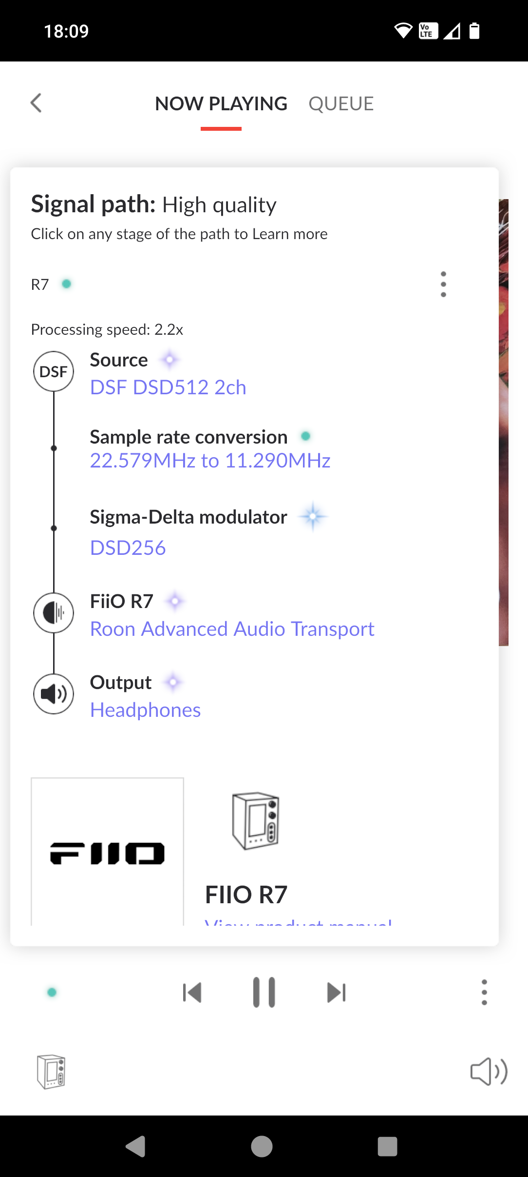

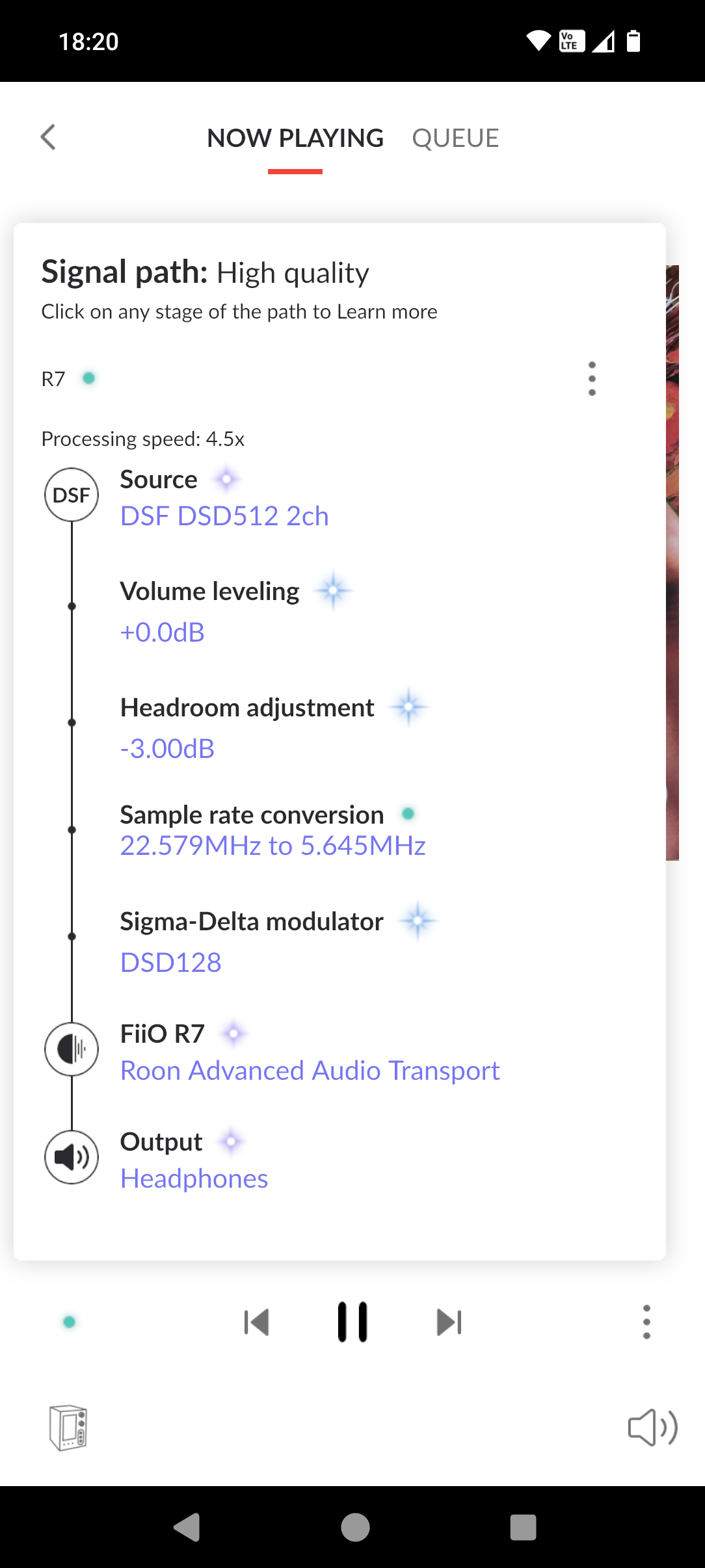

I’ve use a N100 Intel computer with Roon CoreKit installed but it can’t drive a large DSD file through LAN connect to DAC + Amplifier.
Thus guessing the Nucleus at least built on i5 or above chip.
