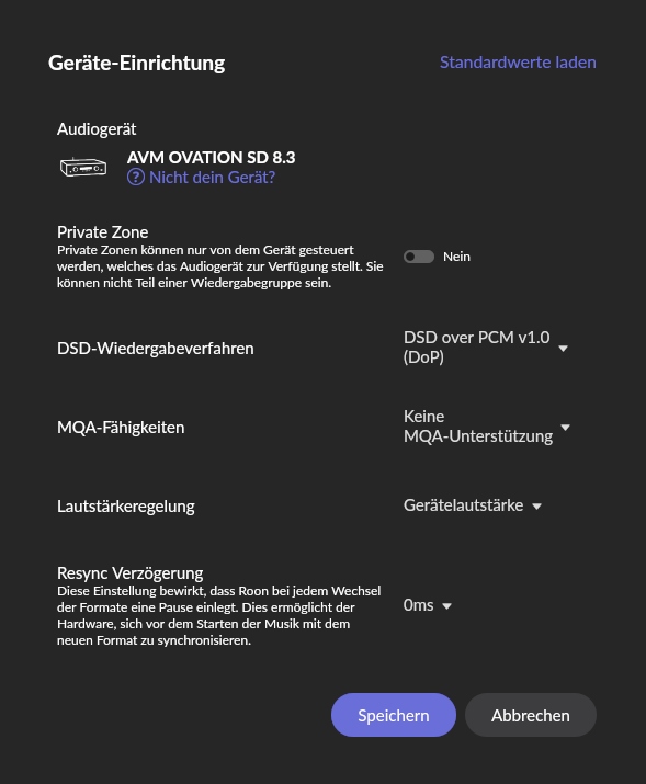

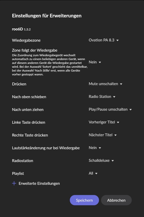

@DrCWO I’ve recently noticed that the set volume changes when the resolution of the music files changes. So it’s not noticeable when you hear it within an album. It occurs when switching to another album. The volume is reset to 100% from the value x. Likewise, muting is deactivated again if it was previously muted.
I can’t say since when this happened. I normally listen to my Linn Klimax over the network, but it is currently in Glasgow for repairs. So now I’m using the USB port of the digital module on the AVM Ovation PA 8.3 - The Roon server is directly connected with a USB cable. By default, I listen with full input voltage, i.e. 100% device volume. Sometimes I want to turn down the volume a bit without having to use the remote control. I had never noticed that with the Klimax. So much for explaining why I’m noticing this now.
rooExtend release: v3.1.7
Device: Raspberry Pi 4 Model B Rev 1.1
Here is a screenshot of my settings:
This sounds strange to me as I never saw that before.
Did I get it right that you have a USB cable running from the Raspberry Pi to the AVM?
If not please connect it this way as rooExtend includes Roon Bridge so I have a scenario that I can reproduce.
Did you use device or DSP volume in the device settings?
Best DrCWO

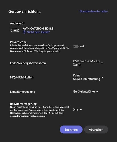

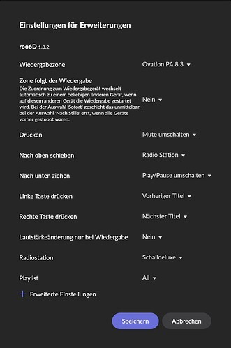

No. I run a single USB-Cable from my Cirrus 7 with roon rock to the AVM digital input module. And yes, I use the device settings for the volume. Screenshot:
I have now tested the behavior several times. It changes whenever the sample rate of the files changes. E.g. from 44.1 kHz 16 bit to 24 bit, also from mp3 to FLAC or DSD and vice versa.
Would you please switch to DSP volume for test purposes and check if the issue persists.
I doubt there is something wrong with device volume of the AVM digital input card.
Have you observed if the volume slider in Roon also jumps up when format changes?
Edit:
One more question. Did device volume change the volume shown in the front display of the AVM or did this only change if you turn the knob?
Friend of mine runs an elder AVM and uses Ethernet input with rooUPNP. This works with device volume even if format changes…
This works without the volume changes described. It stays as it is set.
Yes, this moves when the volume is reset. If the muting is deactivated, the cross on the volume symbol also disappears.
No it doesn’t change. It shows always the same volume.
Since the issue with the DSP volume works perfectly, I think that the issue can now be considered resolved. Many thanks!
