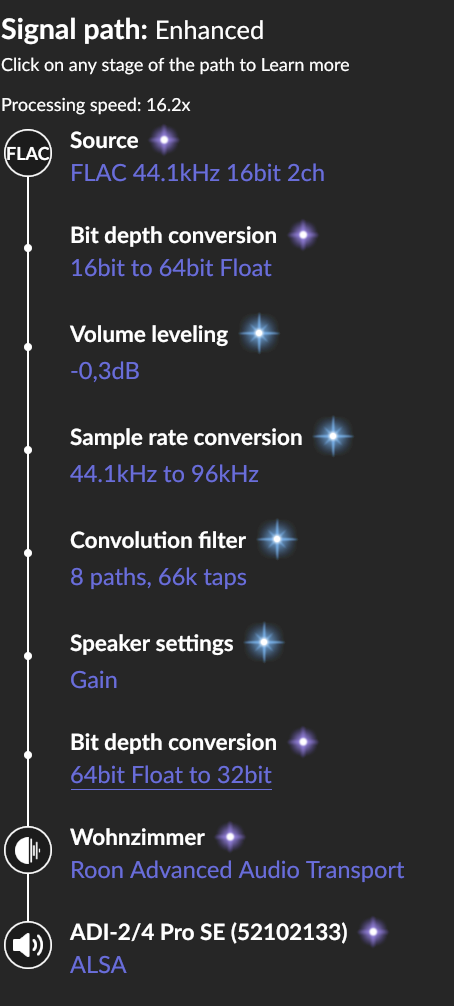

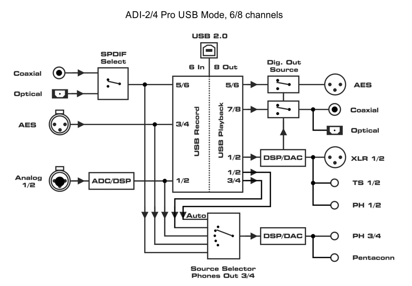

  • First of all you need a RME ADI-2/4 Pro as this device only has RIAA capabilities for the turntable.

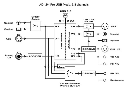

  • You also have to run the ADi in Multichannel USB-Mode. This is the schematic of the unit in this mode (see manual)
    In this mode the ADI has eight output channels. four analog, two S/PDIF and two AES. I use the four analog outputs to drive my active woofers and a stereo amp for my horns.
  • Input Channel 1/2 is for the turntable.

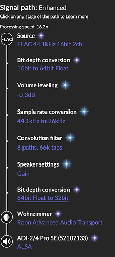

  • In Roon you have to setup a convolution filter with two (stereo) inputs and eight outputs. This filter includes the XO. Also you have to disable downmixing and enable 7.1 in Roon. Doing this the signal path looks like this:
Hope this helps.
Best DrCWO

Your turntable is connected to the ADI Riaa, which sends the turntable signal to Roon for XO processing etc. and from Roon it goes back to the ADI and out to your amps?
Brgds,
Peter
This is exactly how it works :+1: :smiley:
