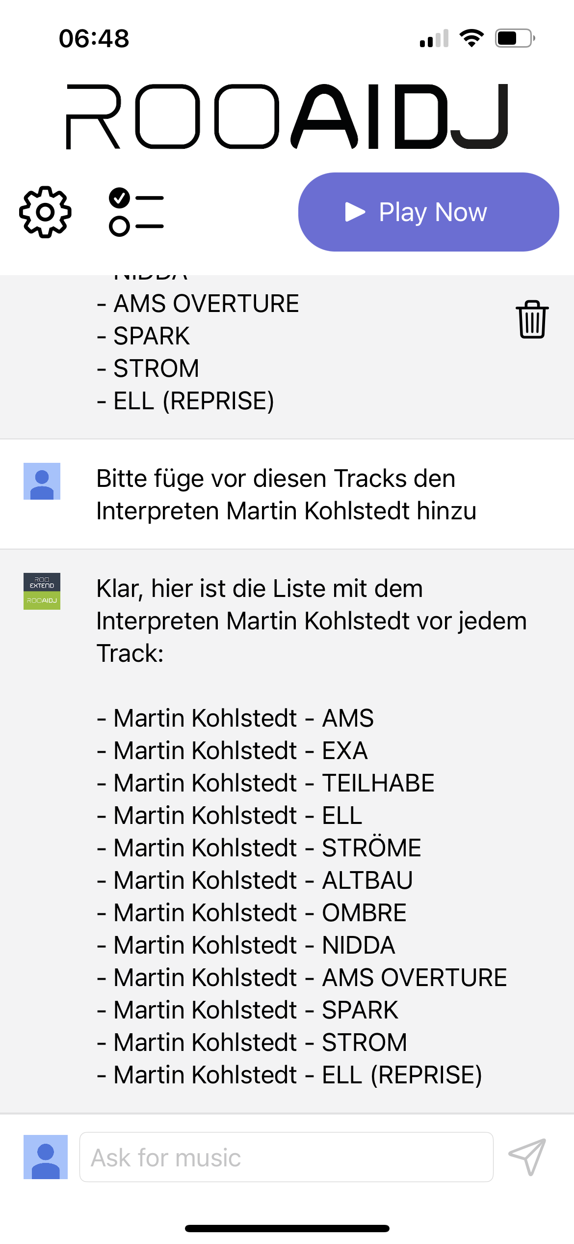

I’ve had a similar problem for a few days. This may be related to the update to iOS 16.5.1, but I can’t say for sure because I don’t use rooAIDJ every day. Regarding the problem: The results so far have been quite satisfactory and the playlists have been generated correctly. Recently that is no longer the case. Although rooAIDJ displays the process correctly, the transfer to the playlist leaves a lot to be desired.
Here’s an example:
Although I ask in advance to format the list as “artist” followed by “title”, he only does it after asking again.
One track appears twice, another has nothing to do with Martin Kohlstedt. The list ends up in Roon’s rendition, but overall the result is unsatisfactory. The “Safe” and “Freeze” options are set.
What else is striking: the titles used to be listed according to the pattern
  1. Interpret - Title
  2. Interpret - Title
  3. Interpret - Title
Now only a hyphen can be seen here. hmm…

My screenshots show the full conversation…
I mean in text not as as screenshot. I hoped I could avoid typing all in by my own :wink:
I don’t have the text anymore, cause i shot down rooAIDJ. Moreover I don’t know how to copy text from rooAIDJ ? But I can write it for you :innocent:
Text 1.
Ich hätte gern ein paar Lieder des Pianisten und Komponisten Martin Kohlstedt. Bitte formatiere die Liste so, dass zuerst der Interpret und danach die Tracks aufgelistet sind.
Text 2.
Bitte füge vor diesen Tracks den Interpreten Martin Kohlstedt hinzu.
Thank’s :wink:
If you long touch the text you get a “copy” option…
Klar, hier ist die Liste mit dem
Interpreten Martin Kohlstedt vor jedem
Track:
  • Martin Kohlstedt - AMS
  • Martin Kohlstedt - EXA
  • Martin Kohlstedt - TEILHABE
  • Martin Kohlstedt - ELL
  • Martin Kohlstedt - STRÖME
  • Martin Kohlstedt - ALTBAU
  • Martin Kohlstedt - OMBRE
  • Martin Kohlstedt - NIDDA
  • Martin Kohlstedt - AMS OVERTURE
  • Martin Kohlstedt - SPARK
  • Martin Kohlstedt - STROM
  • Martin Kohlstedt - ELL (REPRISE)

Hello,
using your prompt I get some tracks from Martin Kohlstedt but not the one you requested.
You must know that rooAIDJ uses the Roon search functionality. If I enter here for example “Martin Kohlstedt EXA” as shown below I also get wrong results. This means: Tracks not available or findable with the Roon Search can never be put in the Roon Queue no matter what rooAIDJ proposes.
Even if I change the order to Title - Artist i don’t get the right result from the Roon Search. You should ask Roon why it delivers not the expected result.
Best DrCWO
