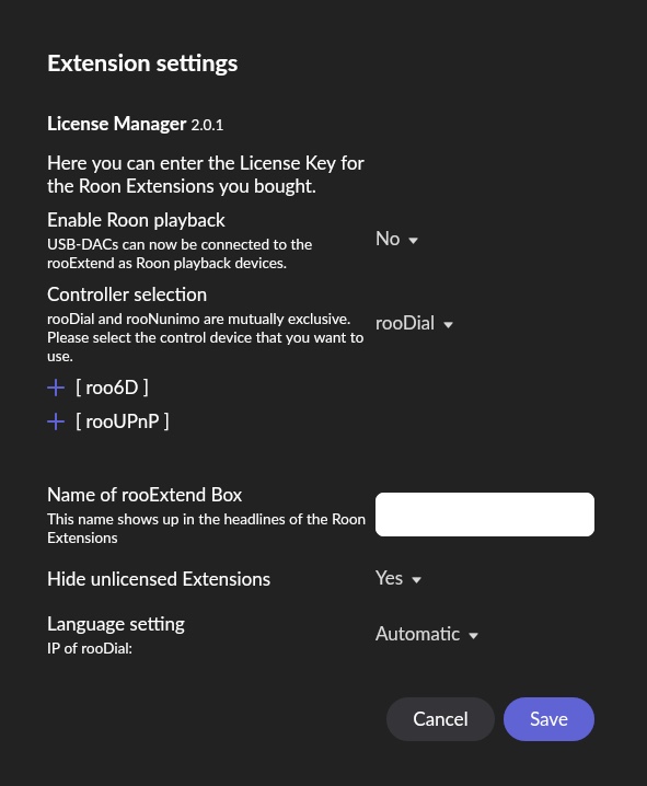

Please reflash the SD-Card with the v2.1.0 beta 3 (you got the link in PM) and reboot with the USB license stick attached. rooDial should be visible now.
Best DrCWO
Thank you DrCWO, its working perfectly now. The license worked, the roodial setting showed up and it is still working as a roon end point, I am a very happy customer and even with what went wrong, my fault knowing that the zero 2 w was not supported yet, but you really came through. Thanks

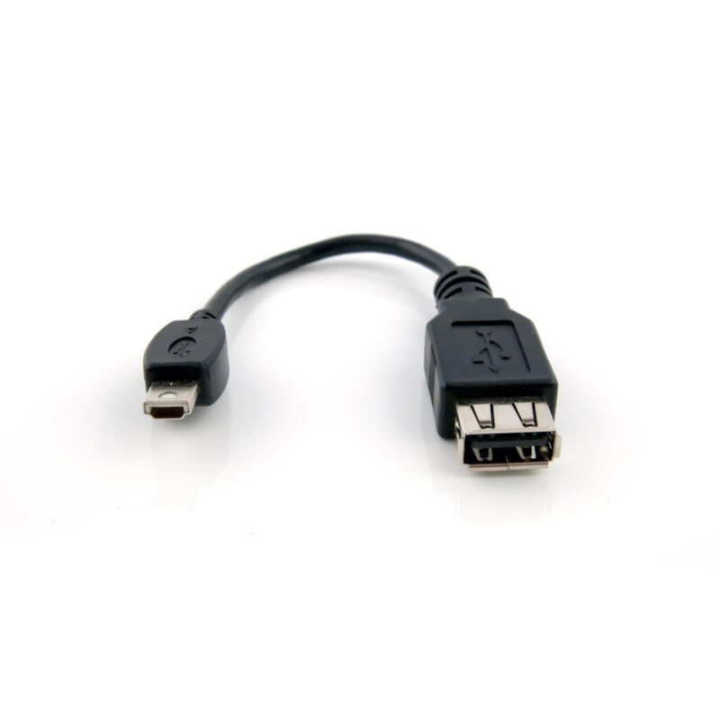

How do you back up the license to a USB? do you install the USB in the Pi Zero?
Thanks and excellent work
Personally I keep the Lic in a Note (MacOS) or just a TXT file is fine too…copy and paste when you need it but its also maintained in the sellcodes account details too
If you connect a usb adapter you can save it on a USB memory stick.

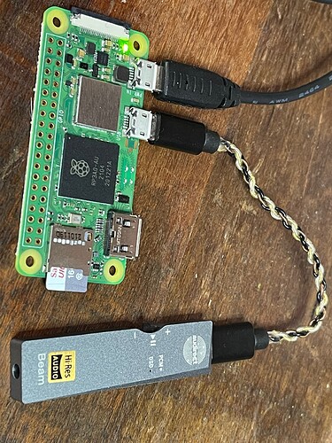

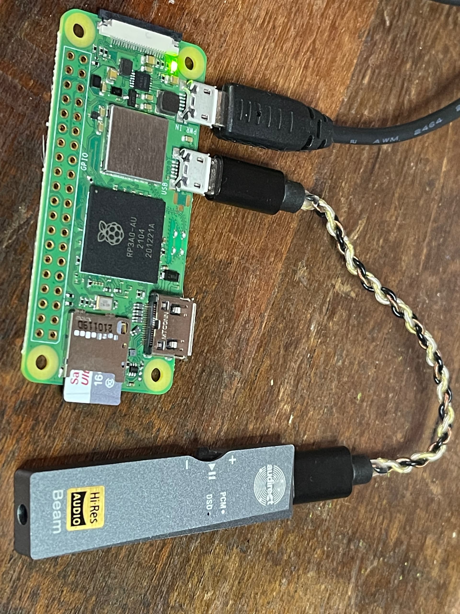

Some good news…while I am waiting to get my hands on a 3rd M$$ dial I tried the most recent installer on the newly released Raspberry Pi Zero W V2 and seems to have booted up fine and installed no issues
@DrCWO just a datapoint for you if you haven’t got your P0WV2 yet. And tested with roon-bridge too with the smallest DAC I have…sweeeeeeet

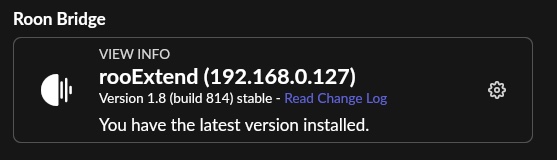

Update needed and done from 806 to 814
Grab 2021-11-12 at  14.35.15
Smallest portable Roon Endpoint I can make right now…with a roodial controller to boot.

I think I have a problem with the V2 its seems to be already on a factory reset even with RooDial selected but option to add a lic. maybe you can PM me the latest beta and Ill try flashing that. RoonBridge works fine
