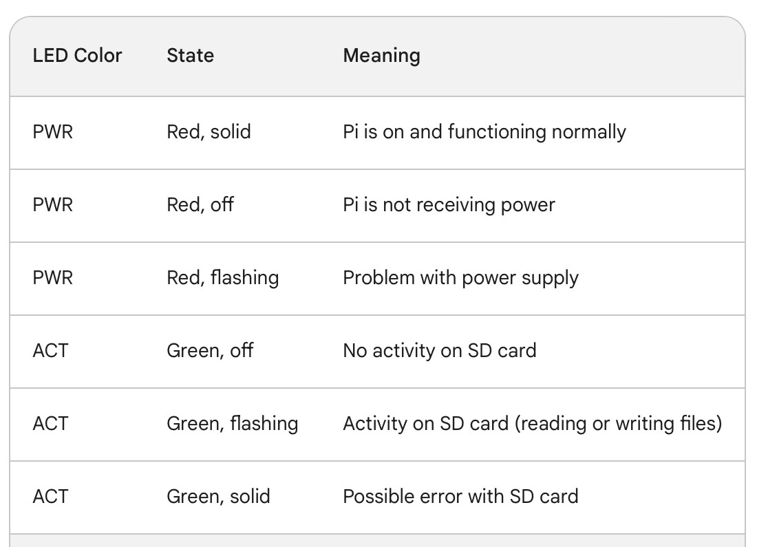

I currently have roodial installed in a raspberry pi 3 b wired via ethernet. I originally had it via wireless and got it to work but after a bit the license manager and roodial would disappear. Even with hardwired it was disappearing for a time now seems to be stable. What does it is mean when the green light it solid? I also have a problem with the dial waking from sleep. For about a day i couldn’t get it to wakeup. Yesterday and today it has been working just fine. But I hadn’t done anything to wake it differently.

If ethernet is connected the option to connect to WiFi will not show up. Maybe your Ethernet Cable is bad or got disconnected. As I’m traveling I can’t check for PI3 LEDs at the moment :smiling_face:
The PI 4 has a red and a green LED. Normally rooExtend switches the red LED off and the green is blinking. Blinking means no connection to Roon, short flashing means rooExtend is connected to Roon.Steady gren LED means at PI4 an update is in progress so don’t shut it down during this time.
Maybe with the Pi3 the colors differ.
Best DrCWO

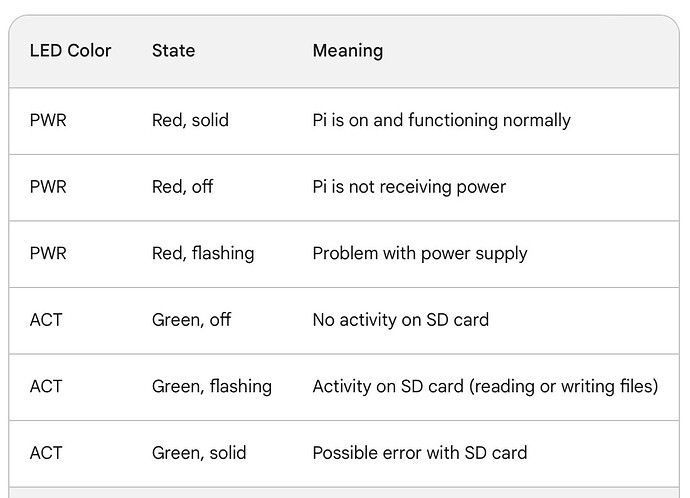

The generic LED meaning for a 3B…
