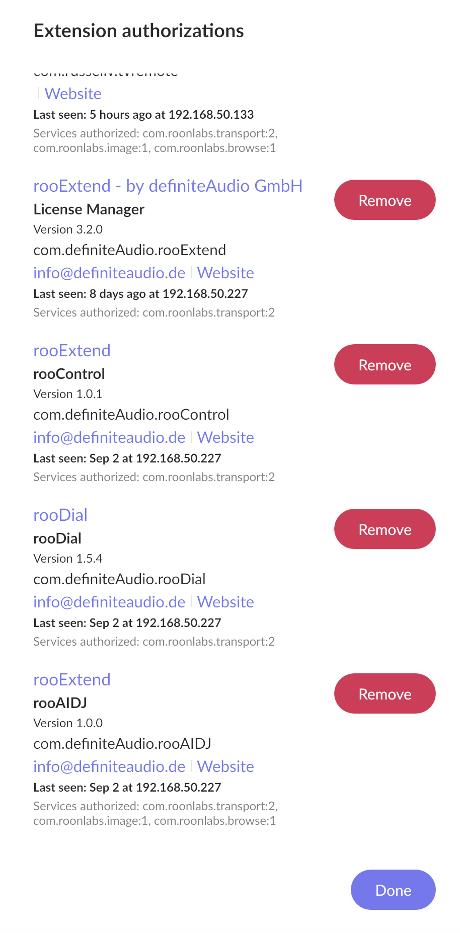

hi @DrCWO - first of all thanks for all the work you’ve put into the services, they are simply awesome!
sadly, I can’t figure out how to overcome a glitch that appeared a couple of weeks bakc - and can’t get the services back to operation, so would be grateful if you suggest ways to troubleshoot.
the gear I use:
I used to enjoy rooDial and rooAIDJ for some good weeks, but then all the rooExtend extensions have disappeared from Roon (see screenshot from roon/settings/extensions)
I tried rebooting rooExtend by unplugging the Pi and plugging the power back in - see the attached video for LED indicators play. the video starts exactly when I plug the Pi in after unplugging.
I tried to plug in a separate USB stick (formatted NTFS) into the Pi to get the licenses backed up, but it shows empty after sitting there for around 10 minutes.
if it wasn’t for the licenses for the rooDial and rooAIDJ (I have the keys saved), I would have just re-flashed the microSD with a fresh image - but wanted to check in here in case someone else experiences this in the future and there’s a more elegant solution.
looking forward to your answer,
cheers from HH (writing in English to make it readable for everyone :))
If you are not changing RPI hardware you don’t need to backup the licenses. If you are moving to a new RPI just revoke the license before you reflash. I login to Sellcodes to find my keys whenever I need to find them. So, as long as you revoke (or don’t change RPI) you are ok. Reflash should fix this, if that doesn’t work make sure your Core and RPI are on the same network subnet and also rebooting your core is sometimes necessary.
-H
@meeting
Henry is 100% right: you will not lose your licenses when the same RPI is re-used.
But if you want to backup the settings of rooExtend, I would first try to use an USB-stick which is formatted in FAT, and not in NTFS. I don’t know if NTFS is supported by the Linux if rooExtend. You just have to put the USB-stick into a USB-slot of the RPI and you should normally see in Roon that it copies the config-files to the stick. But in you r case, Roon cannot see rooExtend anymore, so wait 1 minute (is more than enough). Than you can take out the stick on which the configuration is stored, and check on a PC if rooExtend has stored the configuration-files on it.
Now you should flash an SD-card with a fresh installation.
Good luck, Frank.

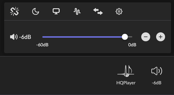

I ran into an issue where my internet was down for about 18 hours and knocked roon out straight away. I have prepared for this by having HQP as a backup and using a RPi4 running Rooextend to provide NAA access to my Chord m-scaler via USB.
However when I went to activate it, I couldn’t of course as one does this through Roon.
If it wasn’t a lot of trouble for you could you have the NAA controls on the rooextend web control page and not just be accessible via Roon?
Otherwise I can just burn a DietPi SD card for such occurrences but as I say if it was an easy enough thing for you to do, that would be great.

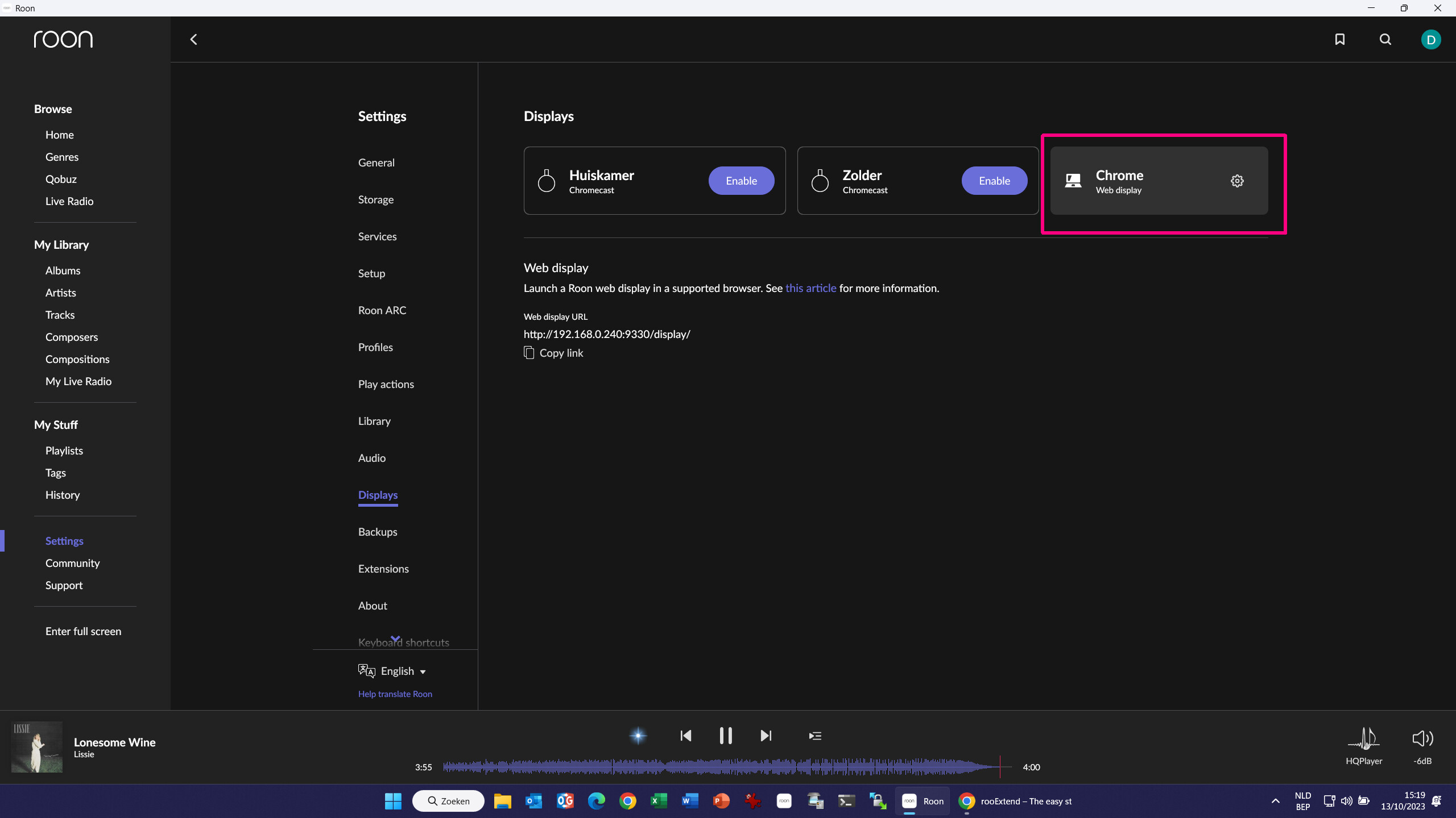

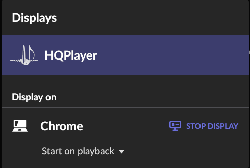

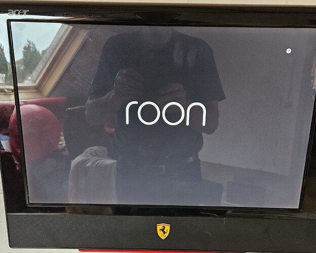

Hello,
I have just mounted the display I used with rooExtend to the wall, but now I do not get Roon to display the Artist & Album cover anymore. All i see is the Roon logo and a question mark in the right upper corner.
I am sure I am overlooking something trivial, but I am not able to find it.
Here are the corresponding screenhsots of what I have:
In roon settings - display, the ‘Chrome’ web display seems to be selected:
And this is what I see on my monitor:
What am I overlooking?
Thanks for your help
Dirk
Problem solved - I’m an idiot.
(Forget to check and re-enable the Display button in the Now playing screen
Please close this topic.
Dirk

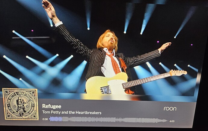

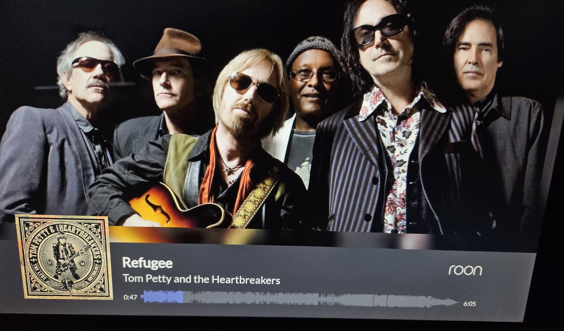

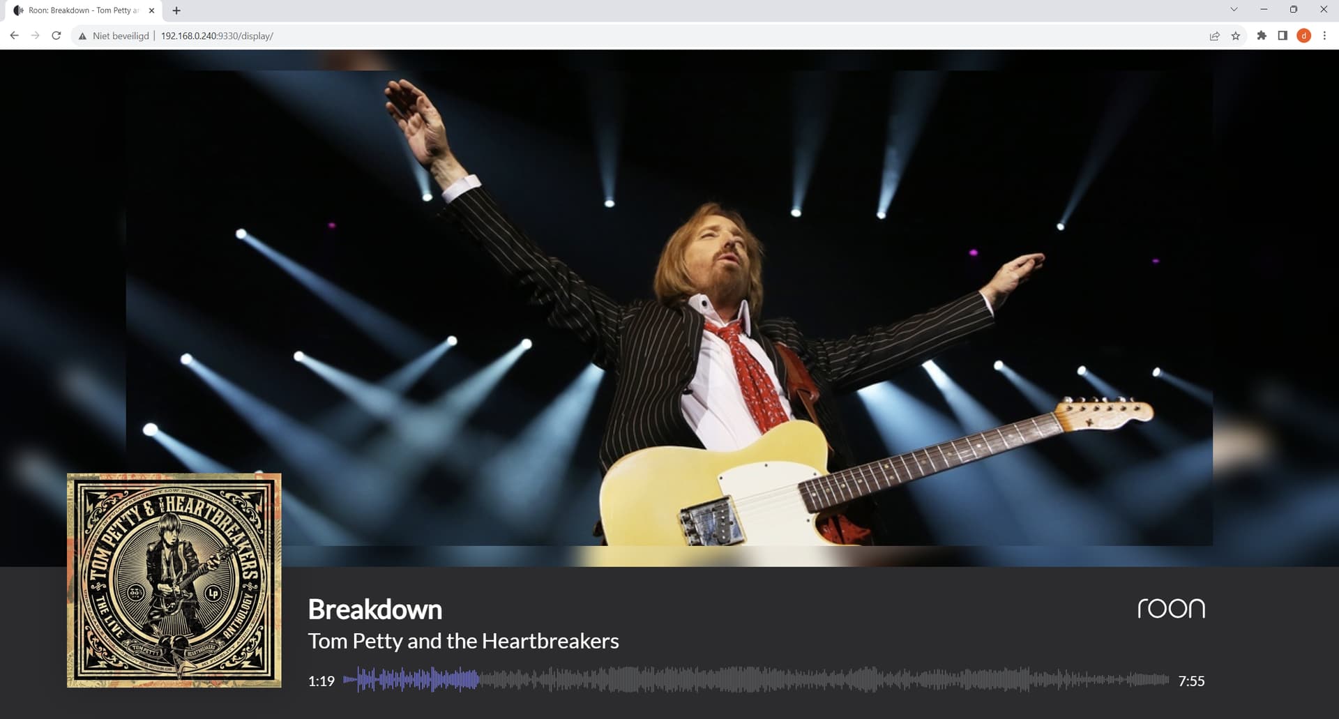

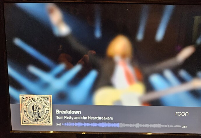

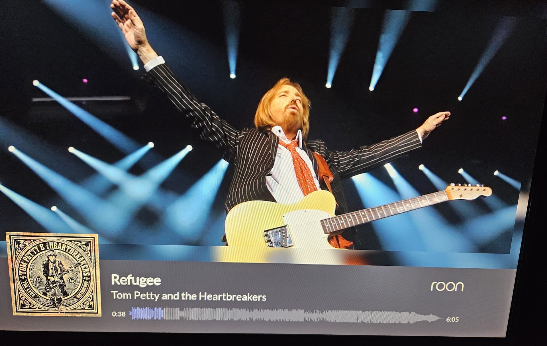

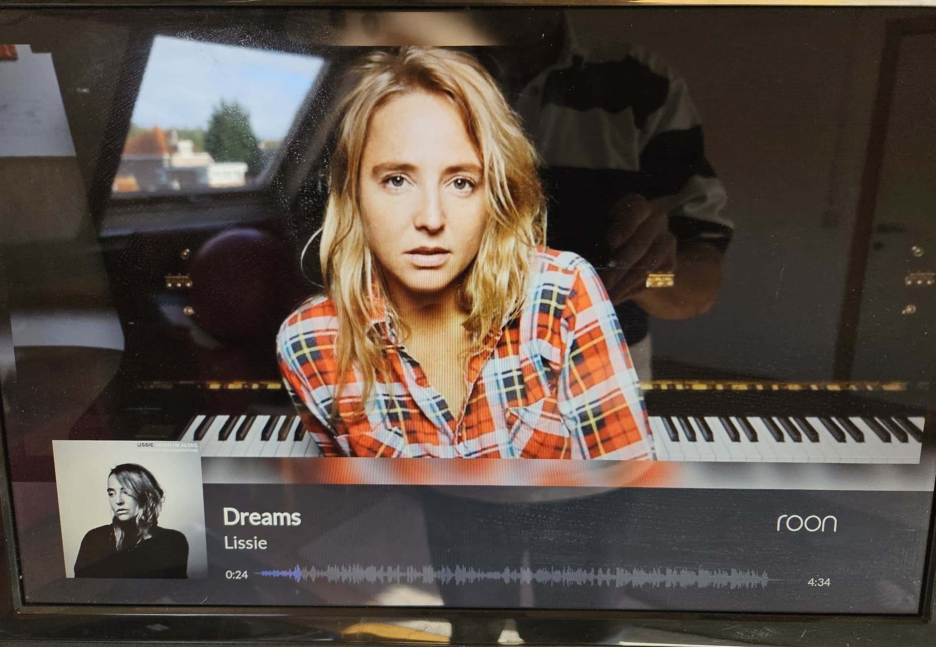

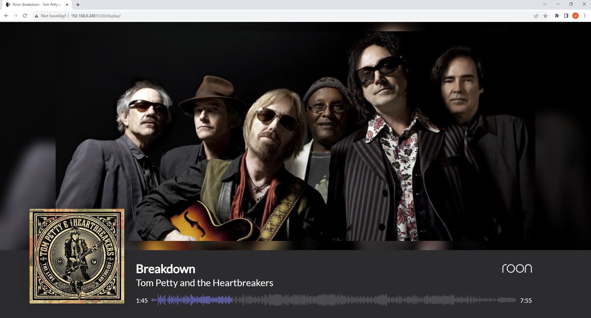

rooExtend - Roon Display issues (rather extensive , but difficult to explain otherwise)

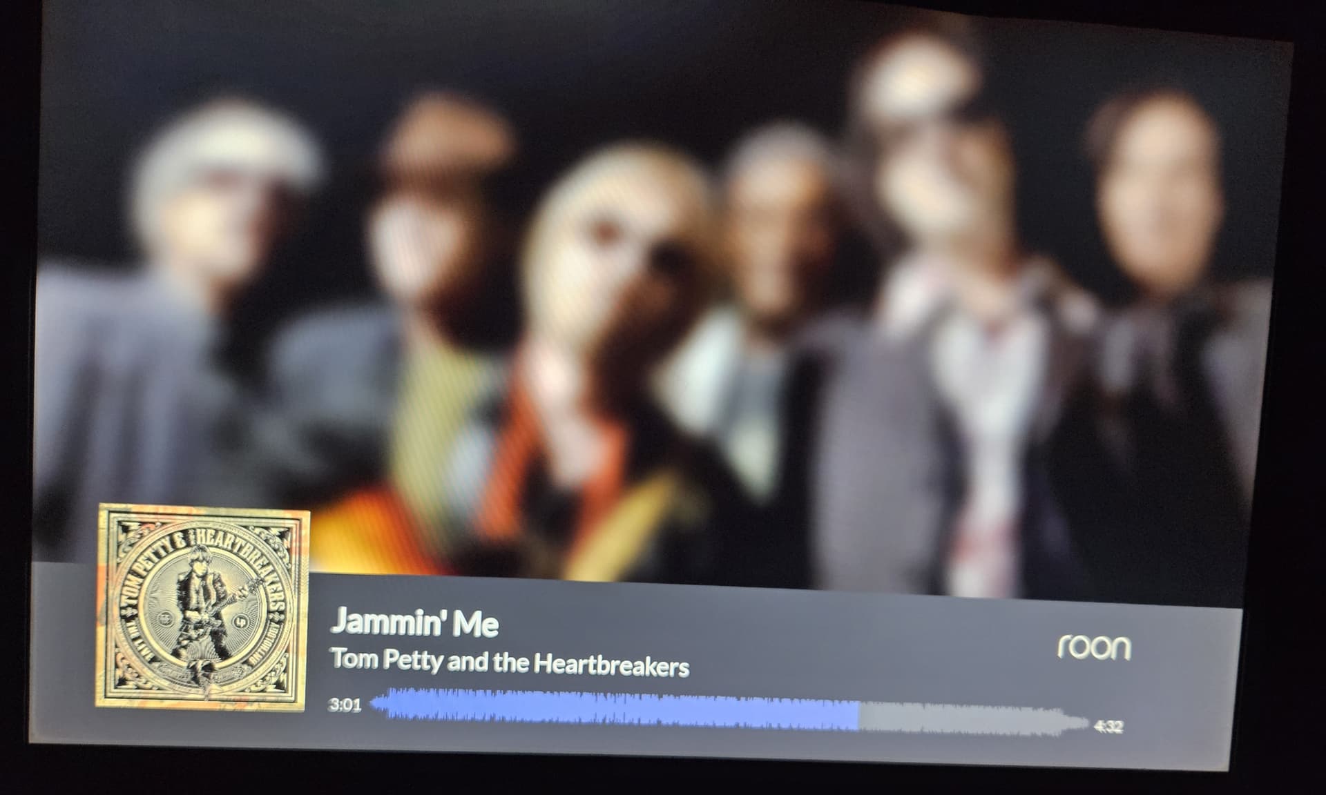

when using Roon Display with an external display or webbrowser, Roon shows in fact 3 pictures:
Using the hdmi output of rooExtend running on my Raspberry Pi 4 (Model B), everything is working fine when starting up Roon, and enabling rooExtend + roon display + starting ‘display now’ on the endpoint.
Some pictures taken with my smartphone:

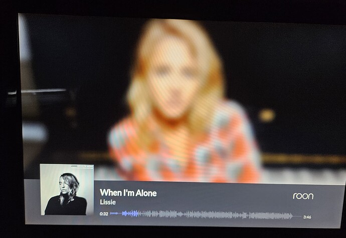

As long as my queue does not run empty, all is working fine.

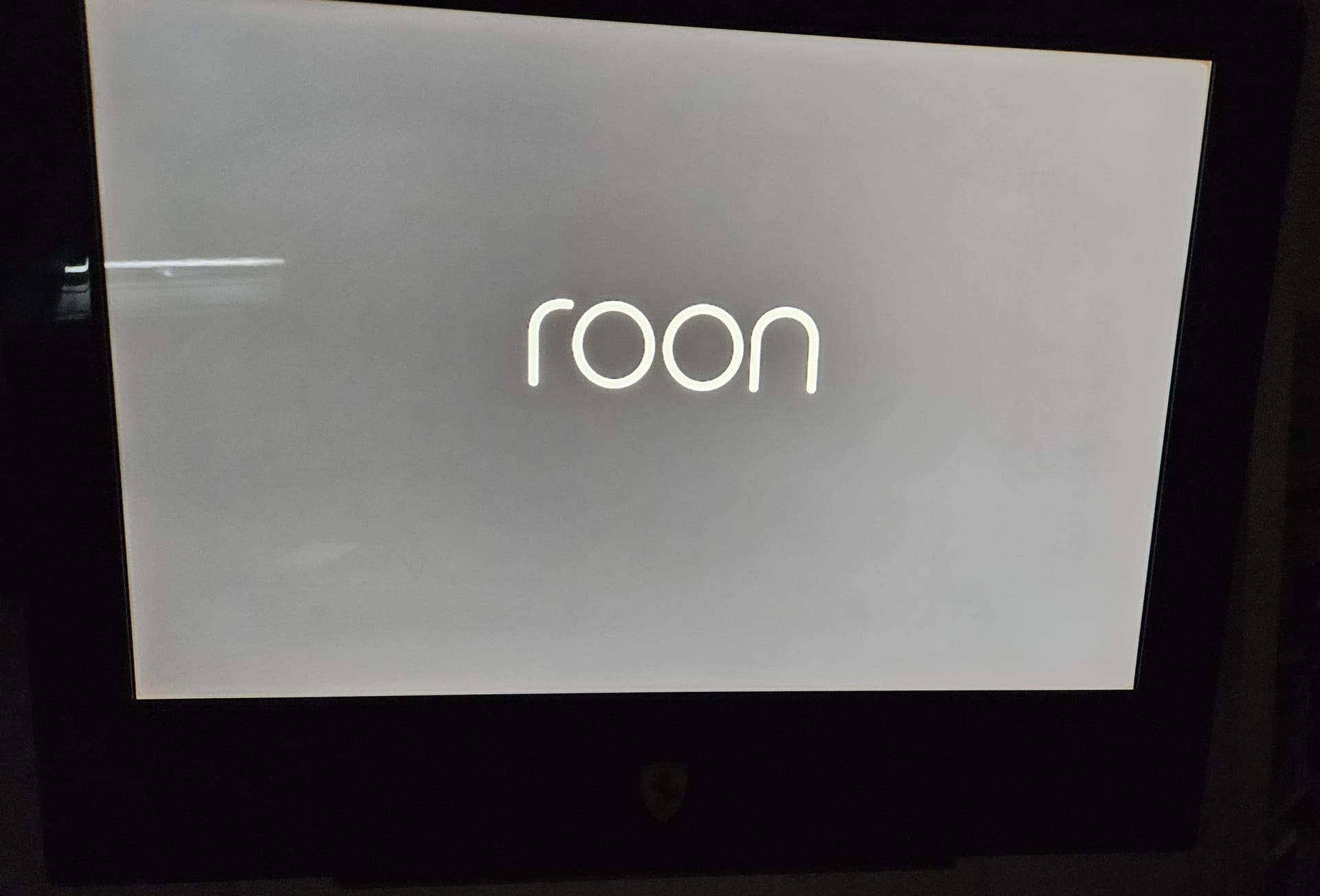

However, if my queue is running empty, I get a temporary ‘Roon’ screen (which is fine),

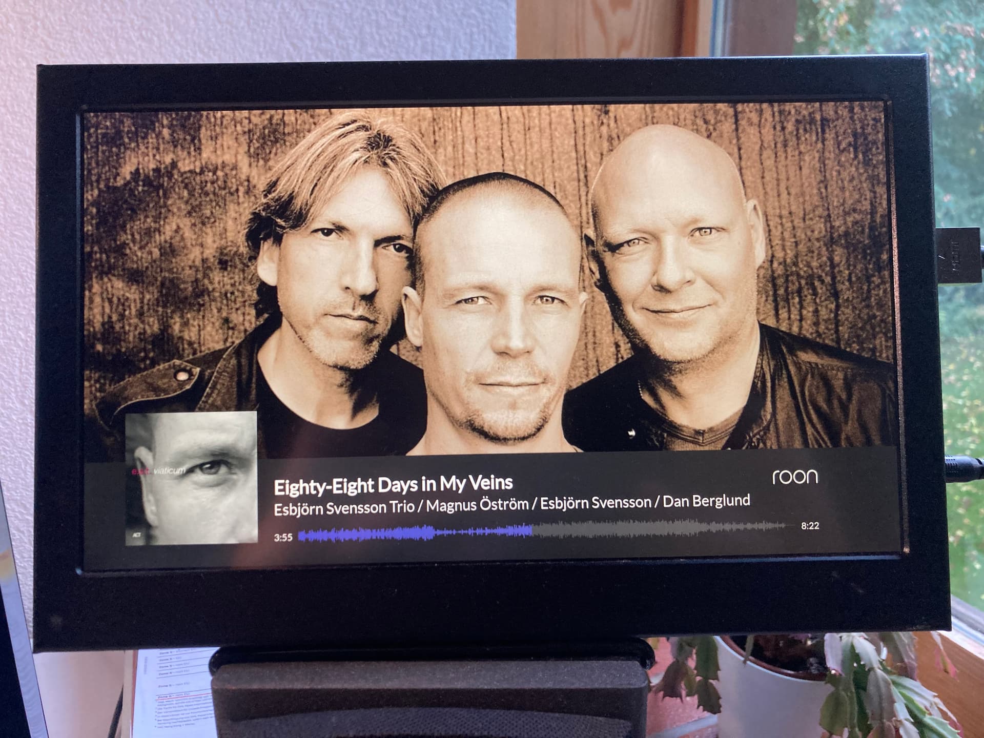

Starting to play another album, rooExtend does not show the 3rd in focus artist picture anymore:
The only remedy is to restart Roon, restart the Raspberry Pi 4, re-enable Roon Display and activate display.
I have tested this with different endpoints with the same results.
I have also tested with a Chromecast display, and with web browser display. No issues there.
So the problem is due to rooExtend or the Roon API .
Thanks for taking a look at this issue.
Dirk

I just started a stream and get an unblurred HDMI output without issues. At my current track the background image changes from time to time. But I only see two images, the cover art and a background image.
If I press playback the last displayed artwork stays on the display. I don’t see any Roon logo.
If I next select an other track I get the new artwork without any issue.
I activated “Start on playback” maybe this is the reason why? Please try.
On the other hand my display is 1024x768. Maybe there is an issue with higher resolutions?
Did anybody out there encounter the same issue ![]()
Best DrCWO
I have “start on playback” activated all the time.
I was ready to test with this setting deactivated, but that does not seem to make any sense now.
