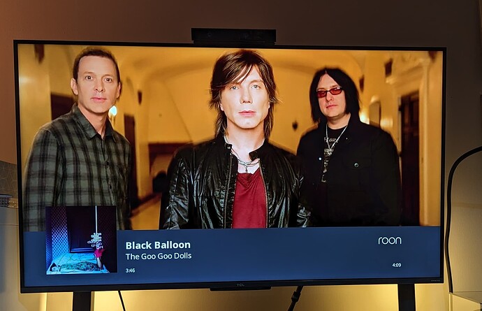

can somebody who uses rooExtend with a display over HDMI post a screenshot please?
Thanks.
Enno
Hi Enno it is just a black Linux login screen with white text on it unless you press the display album art button in Roon and then you get Roon Artwork displayed.
Is that what you are asking about?
Hi Michael,
thank You. I would like to see how it looks (font, cover art) because I have no micro HDMI cable to test it by myself. I consider to use it as Roon endpoint with display.
Enno
I will try and grab a photo for you later when I can get access to my man cave that my son is currently using for his university work.
Mostly it looks identical to the Room Chromecast display but is a good little free bonus for using RooExtend
Ho Enno here you go and hopefully this helps you see what it looks like. There can be the odd issue with Chromium but generally it works well enough for my use
Thank You @Michael_Harris for this shot from your man cave. Very appreciated. :slightly_smiling_face:
This helps me. I hope there is some customizing possible in the future (maybe in one of the next Roon updates, who knows) but this looks good for enough for me to use this feature on my display.
I am sure @DrCWO can explain the options of hand crafting the backgrounds and any possible changes. I know he has shared login details for those interested in the past.
Glad to be of help anyway

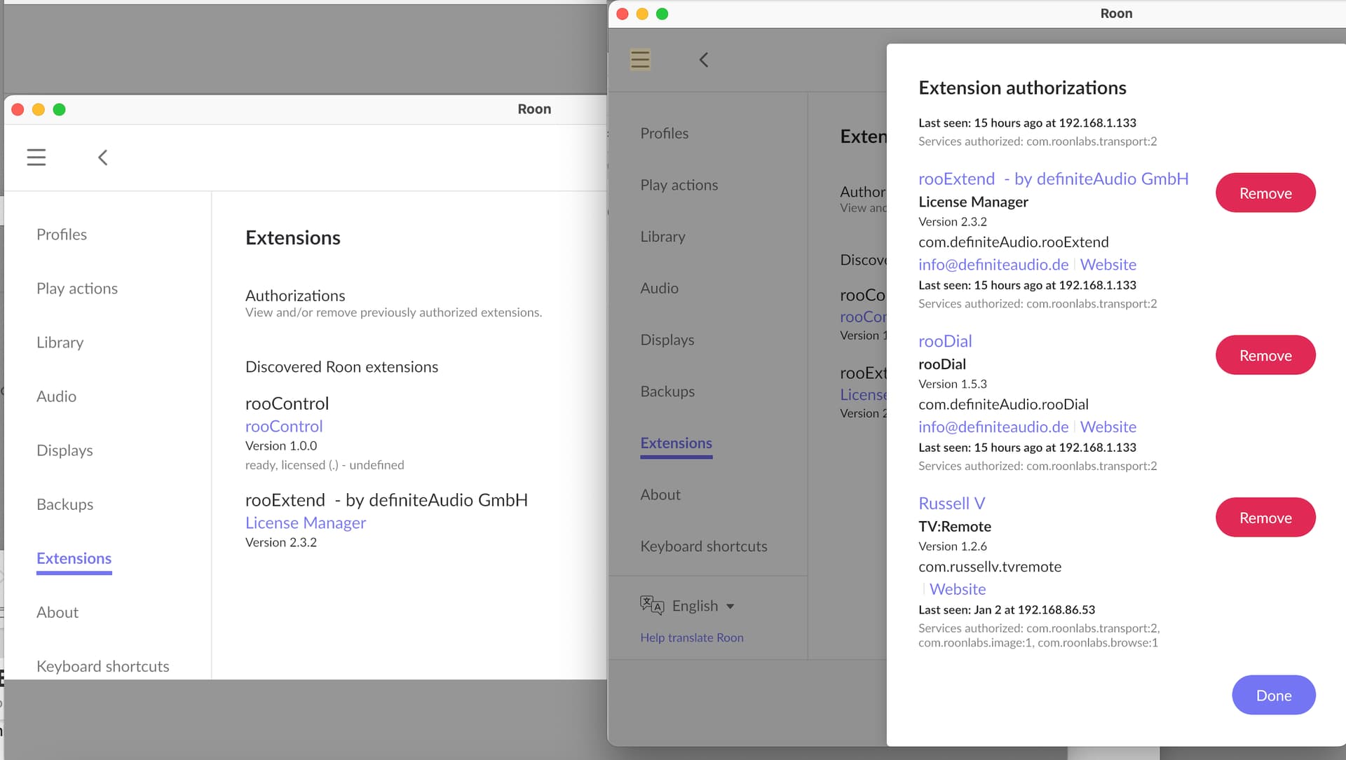

Hello DrCWO,
I obtained my first rooExtend product a few months ago to be used with the rooDial. That worked well for me. I attempted to update it today to rooExtend v3.3.0. All went well up to the post restart:
where this is what I see under Extensions in Roon:
I am unable to see rooExtend v3.3.0, but only the existing 2.3.2. Also, the Microsoft Dial continues to flash after pressing the small button at the bottom of the device.
Can you advise?
Thank you,
David
Hi @David_Weinberg,
I first must understand your configuration. Your run Pi or rooExtend-Box? Which Pi, how many? Your wrote about seeing stiil v2.x.x. And not v3.x.x.
YOu use Wired Ethernet or WiFi. On what unit what?
Please descríbe your setup first.
Best DrCWO
