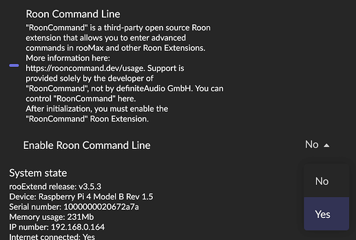

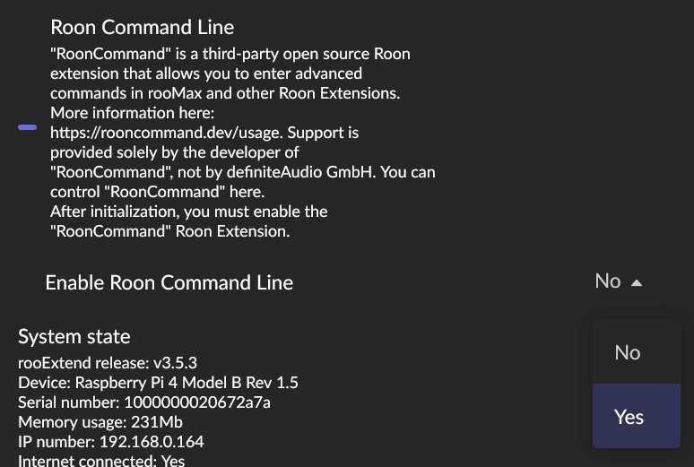

If you attempted to activate RoonCommandline in the License Manager while in this situation, it likely did not work. You can select “Yes” as often as you like, and there is no reaction.
A reference to an external package in RoonCommandline was the cause of the issue. So just like the last time I had to release a hotfix.
It was a bit complicated to find the reason why and it took me a lot of time to provide a fix. Now, finally, I can provide a hotfix that resolves the issue.
You install the hotfix the same way as the hotfix before but - only difference - enter the following URL in input field: https://rooExtend.com/fixes/fixRoonCmd/fixRoonCmd.sh
Please copy and paste as Upper and Lowercase matters!

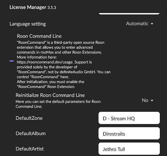

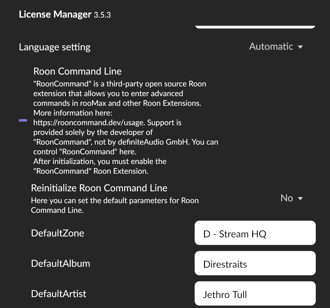

Hello @DrCWO - Long time, no see :waving_hand:
I was able to get this installed but for some reason my RPI locked after completing the re-install of CommandLine.
I unplugged the RPI, re-powered and it came back fine. Command Line now like this:
Sharing here just in case anyone else runs into it.
Danke schön,
Henry
After RooCommandline was enabled in Roon Settings/Extensions the hotfix will terminate so you have to reboot.
