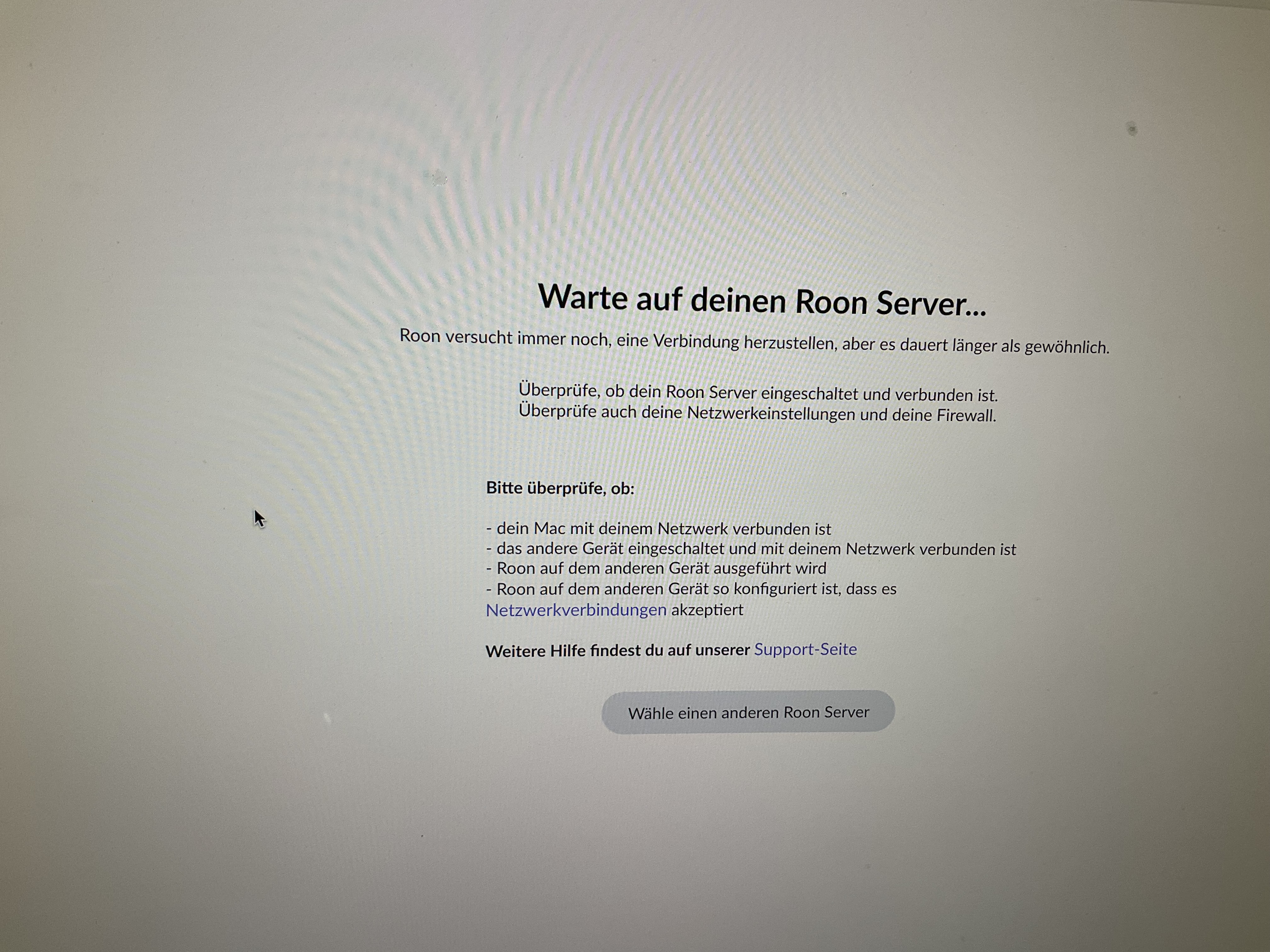

Hallo, leider kann ich nach dem letzten update auf Sequoia 15.1.1 auf meinem iMac mit M3 Chip Roon, trotz ausgeschalteter Firewall und vollem Festplattenzugrif für Roon die App nicht mehr öffnen. Vielen Dank im Voraus
der Router ist ein Fritz!Box Cable6591LL
Not sure if it will help (it often does with macOS 15) but try this as a first step
Hey @hchoppmann,
Thanks for writing in! @Suedkiez is correct in their response above,
Can you please navigate to macOS System Settings > Privacy & Security > Local Network , and make sure Roon is allowed. If it is already enabled, toggle it off and on again. Then reboot your Mac, and see if the same issue persists?
If it does, lets test out refreshing the Roon database:
  • Exit out of Roon
  • Find the folder that says “Roon”
  • Rename the “Roon” folder to “Roon_old”
  • Verify if the issue persists on a fresh database before restoring the backup
We’ll be on standby for your reply! :raised_hands:
