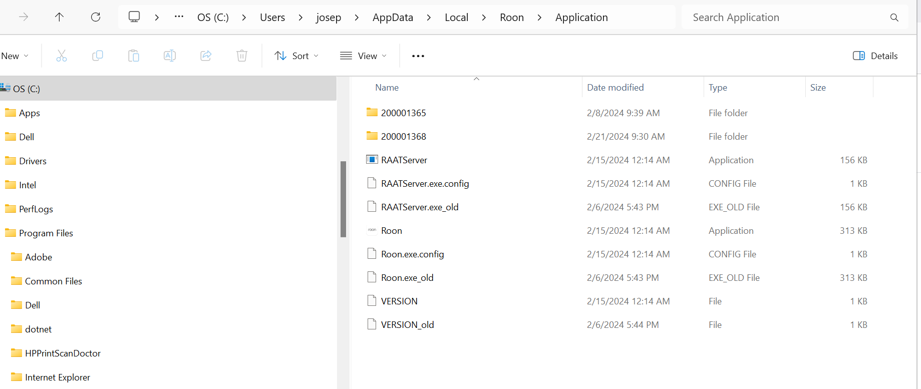

Hi GeoffThanks for your reply. The application closed down when I selected “Update All” on the update notification and I was not able to restart it since. I found the Roon directories. Seems like the Roon.exe is missing in Application folder?
Er, no - the roon.exe file is not missing - it’s there in your second screenshot. It’s just showing as Roon (type: application) because your Windows Files Explorer does not show file extensions by default.
