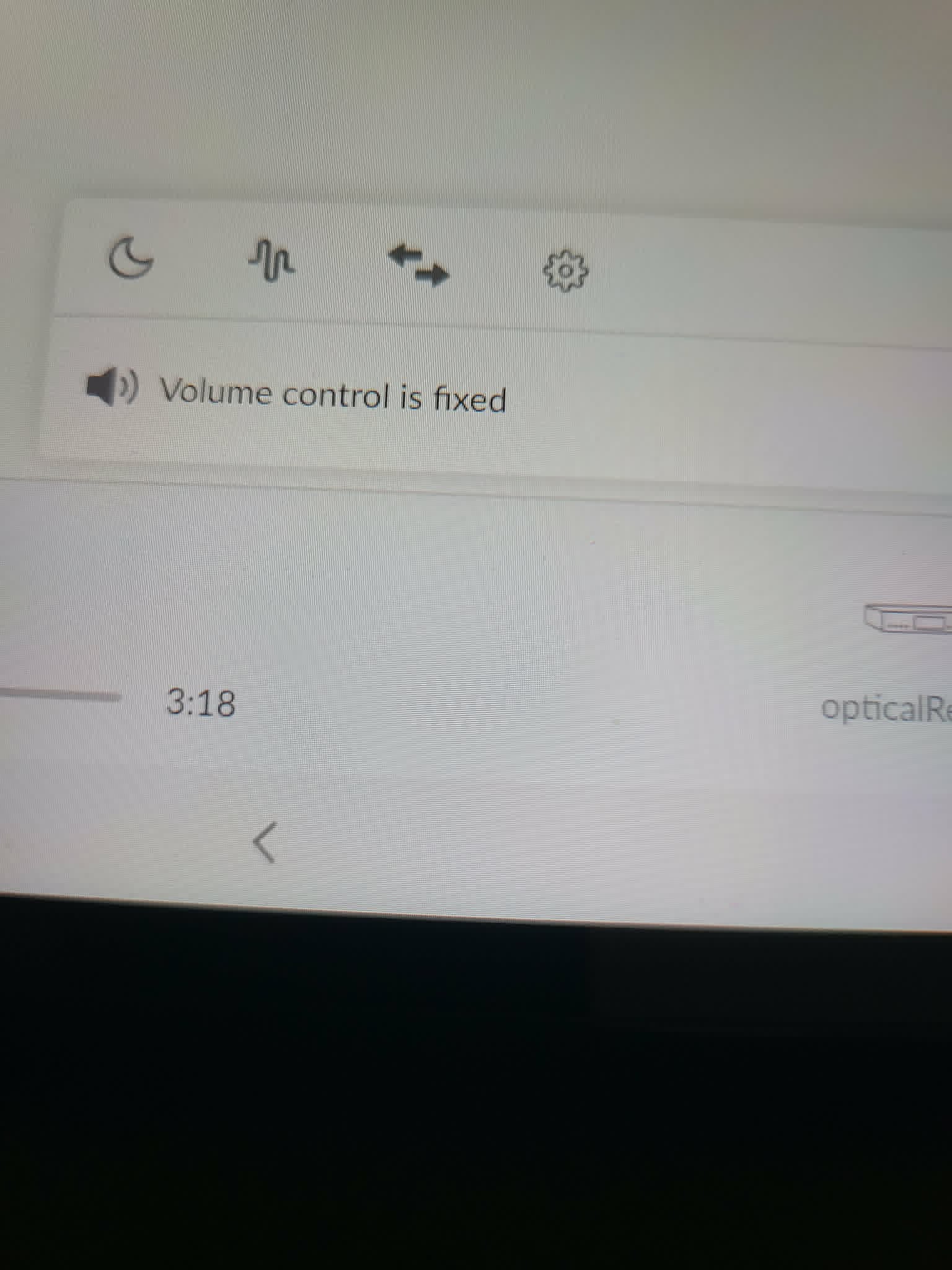

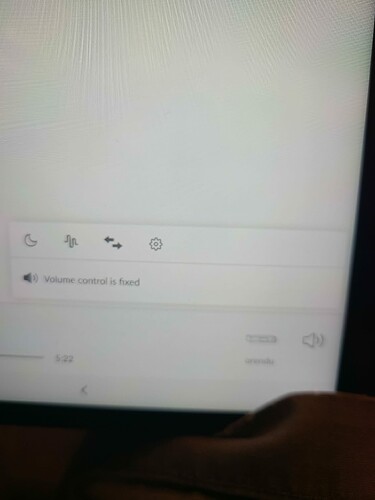

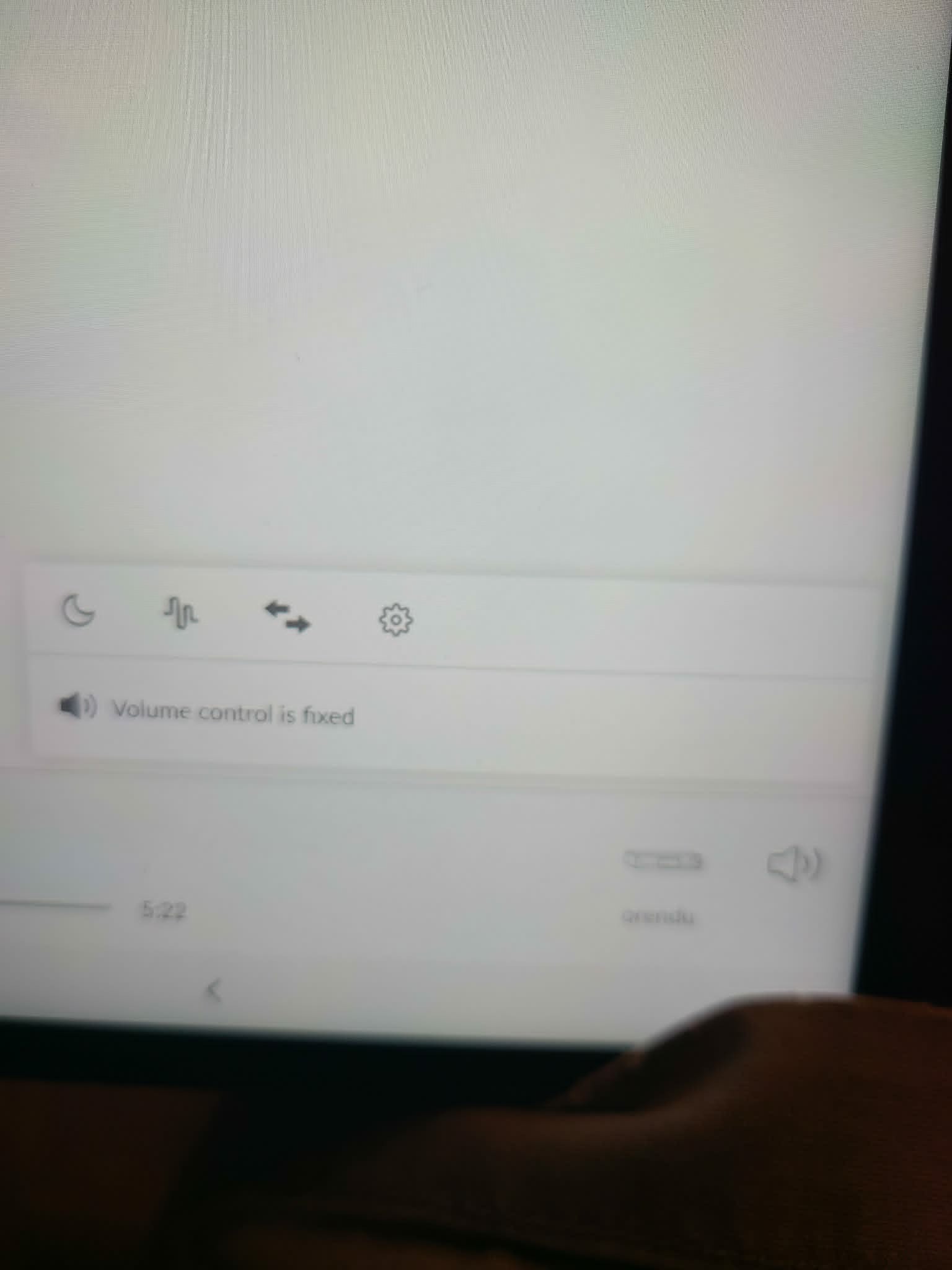

I few days ago I had a quick power outage at my home. Well now I can longer control the music volume from my Roon app it is staying in the fixed position on the app no matter what I do.

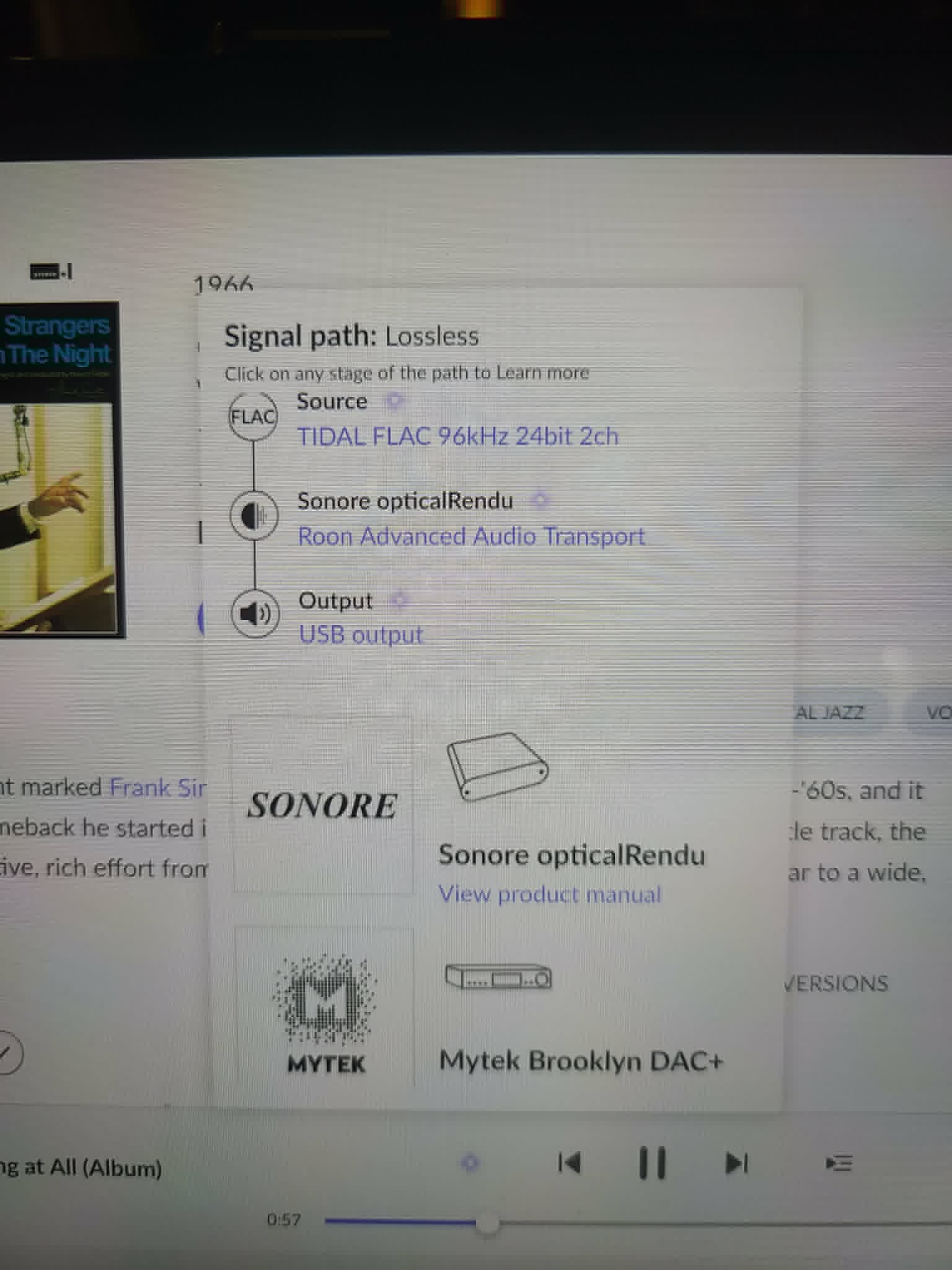

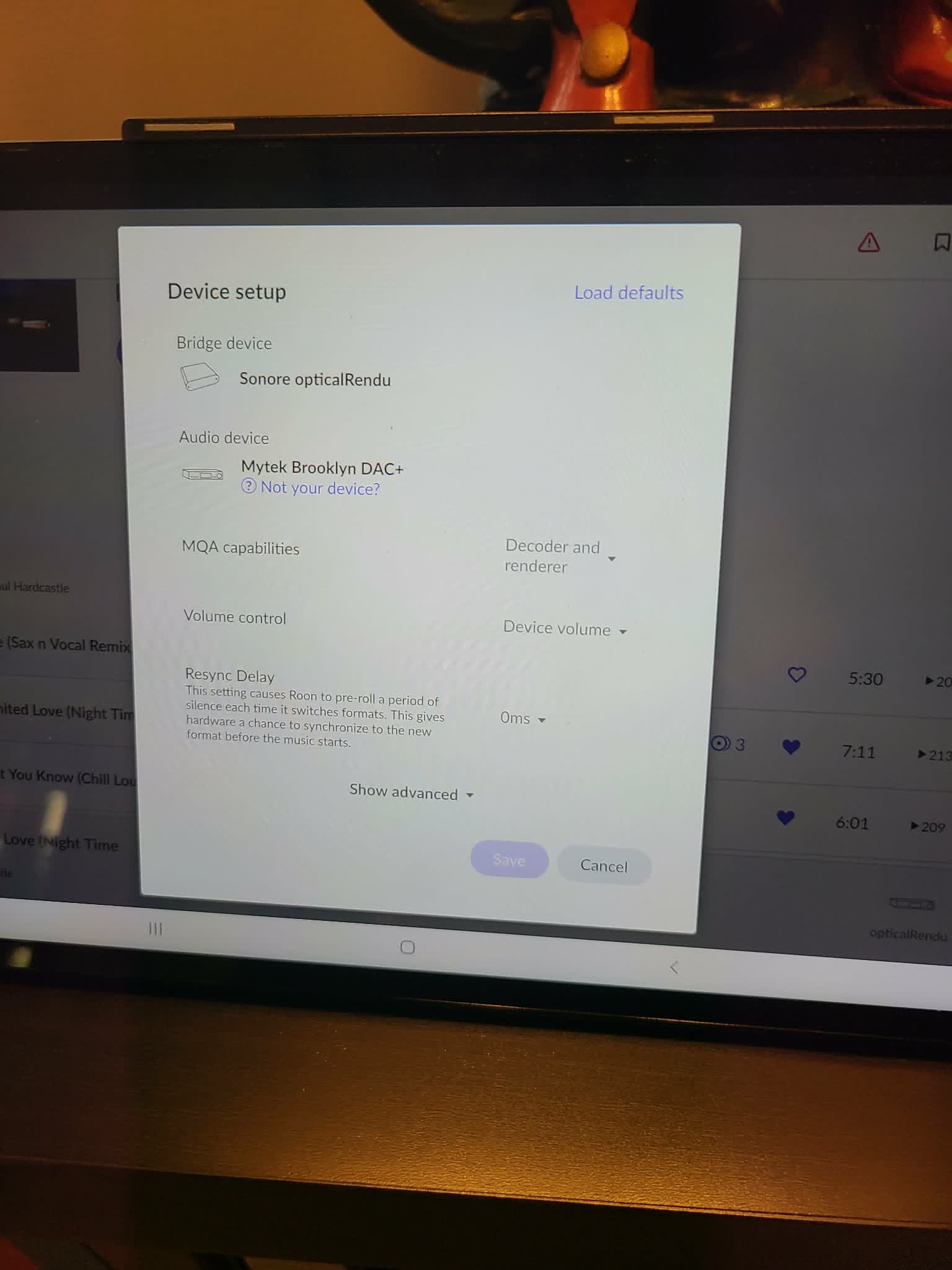

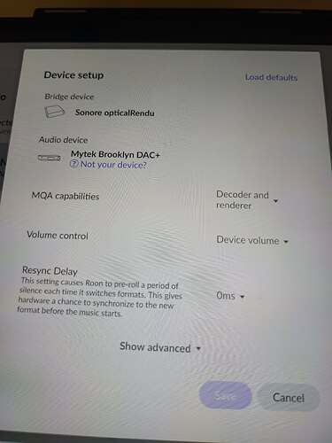

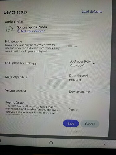

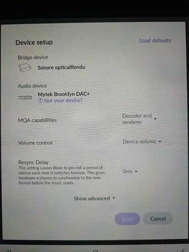

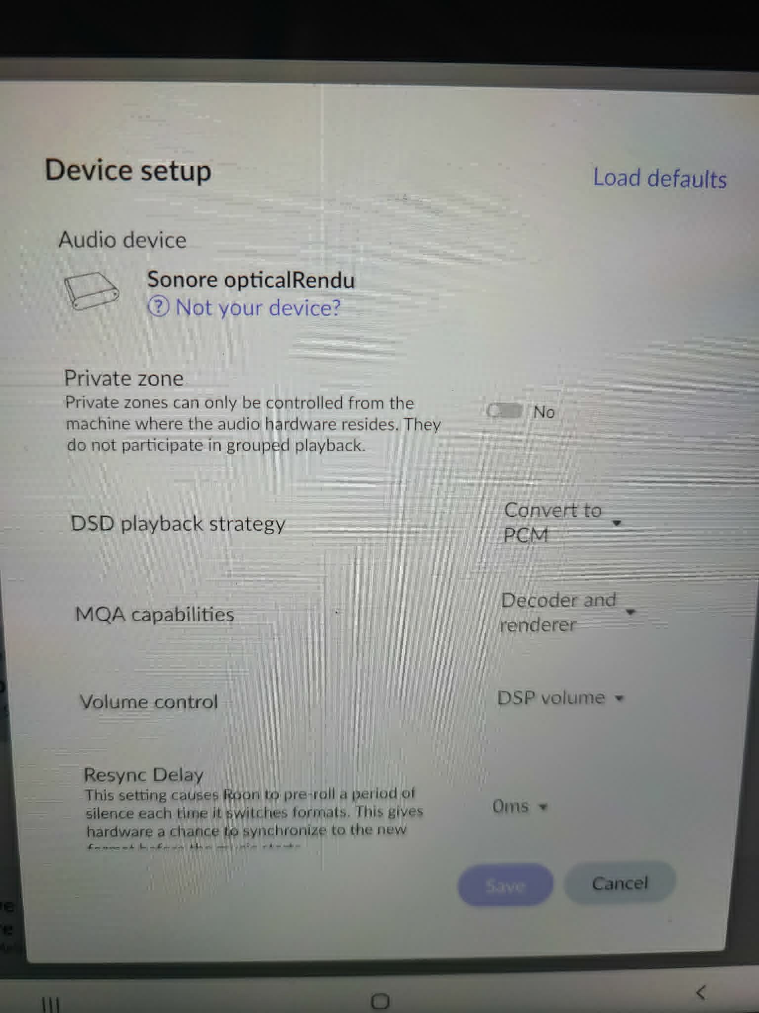

If you look at the photos under the Mytek I have tried both fixed and device volume, neither allows the Roon app to control the volume it always shows fixed no matter what I do.
I even reinstalled the app on my tablet, still the same. Any suggestion would help as want to get back to controlling the volume via the app.

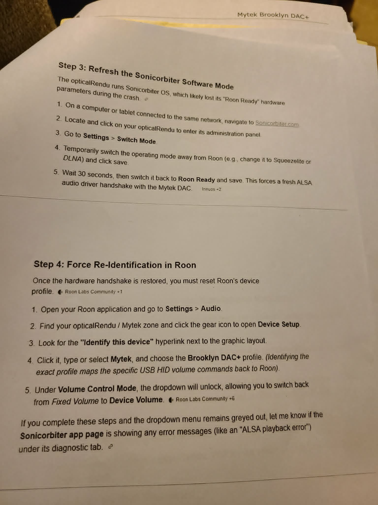

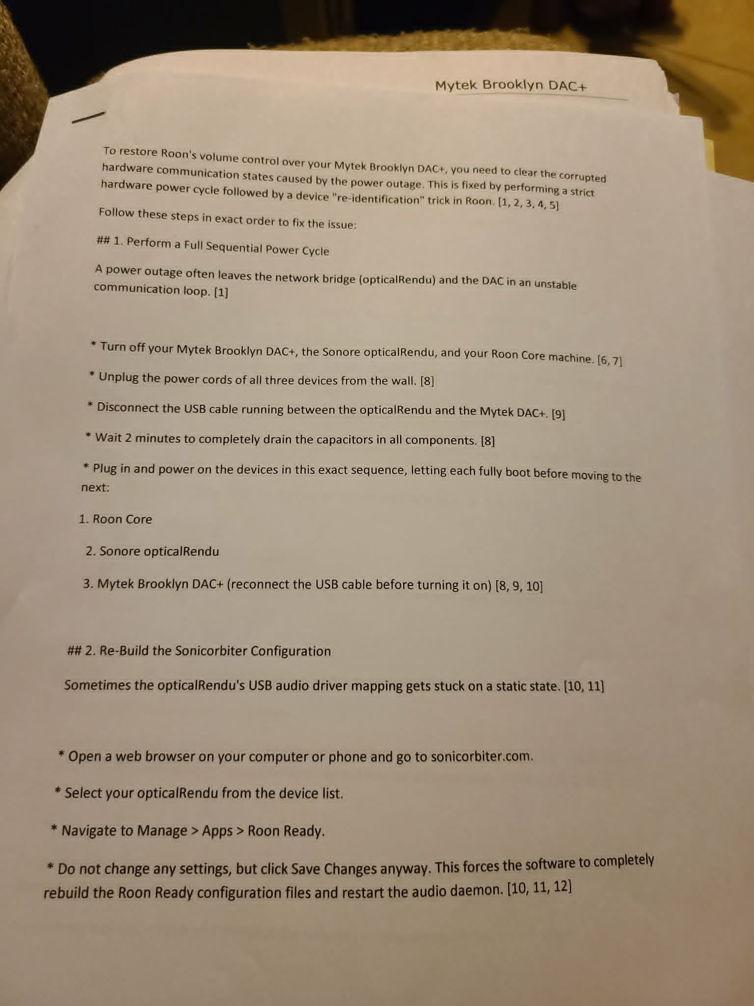

Hello Connor,

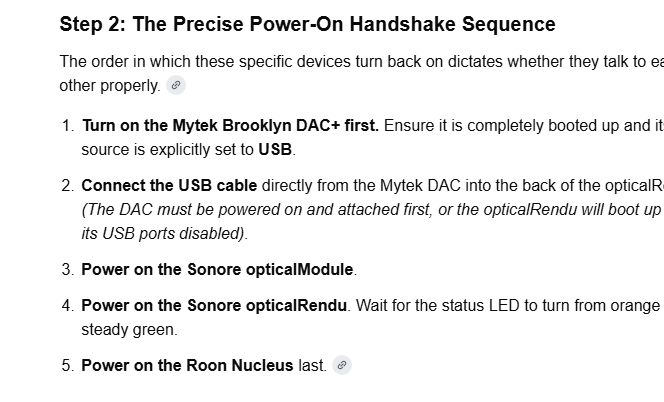

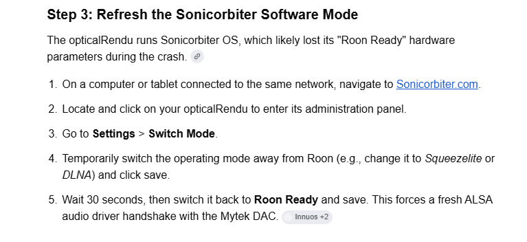

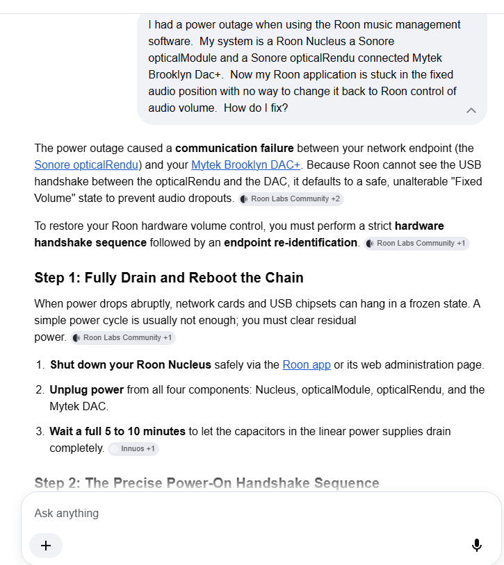

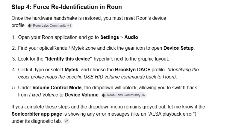

I appreciate your follow-up. I did try the cold start of the Mytek Dac as you suggested. Sadly no luck. Then for the heck of it I asked Chatgpt. Here is what it replied, which did reset Roon to allow me to have volume control. The only issue now is the output of the volume is low. Please review the following.

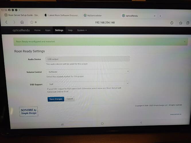

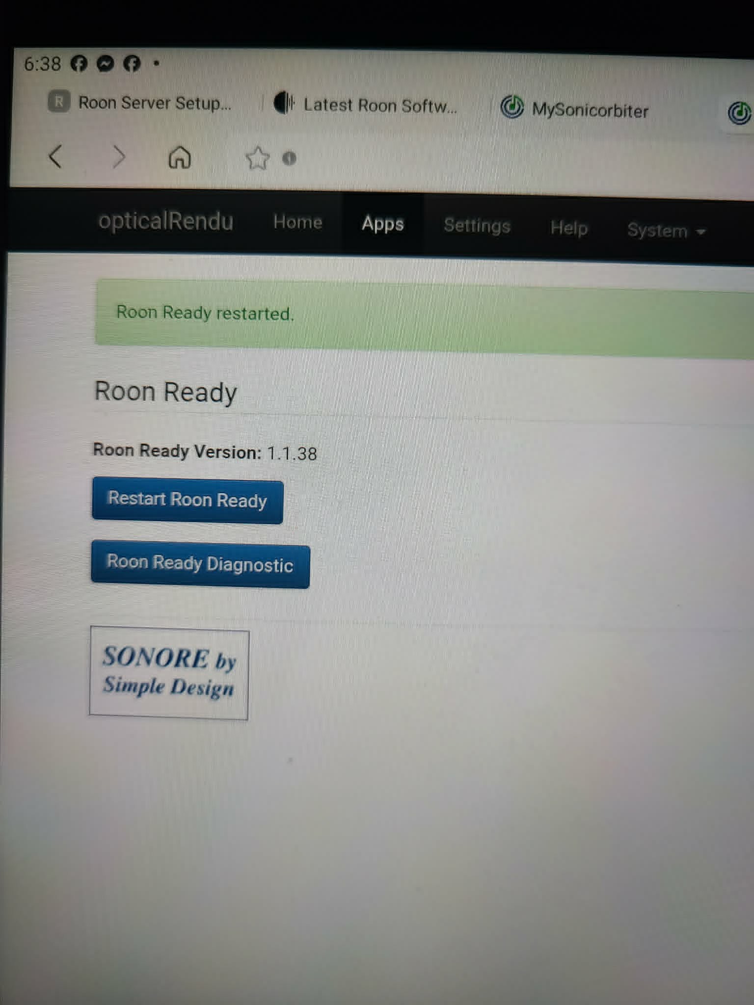

The opticalRendu’s SonicOrbiter software should control what volume type it advertises to Roon. Log in to the opticalRendu web interface (its IP is 192.168.254.148) and check the audio settings. Is there any option for volume control?
If so, set it to software volume rather than hardware/ALSA volume. This will restore the dB-based control Roon was using before.
It looks like you already have device volume set in Roon, so thats good.
Feel free to show a signal path screenshot after the above if you’re still having issues.

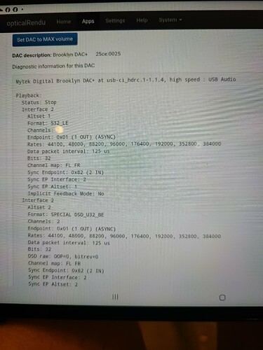

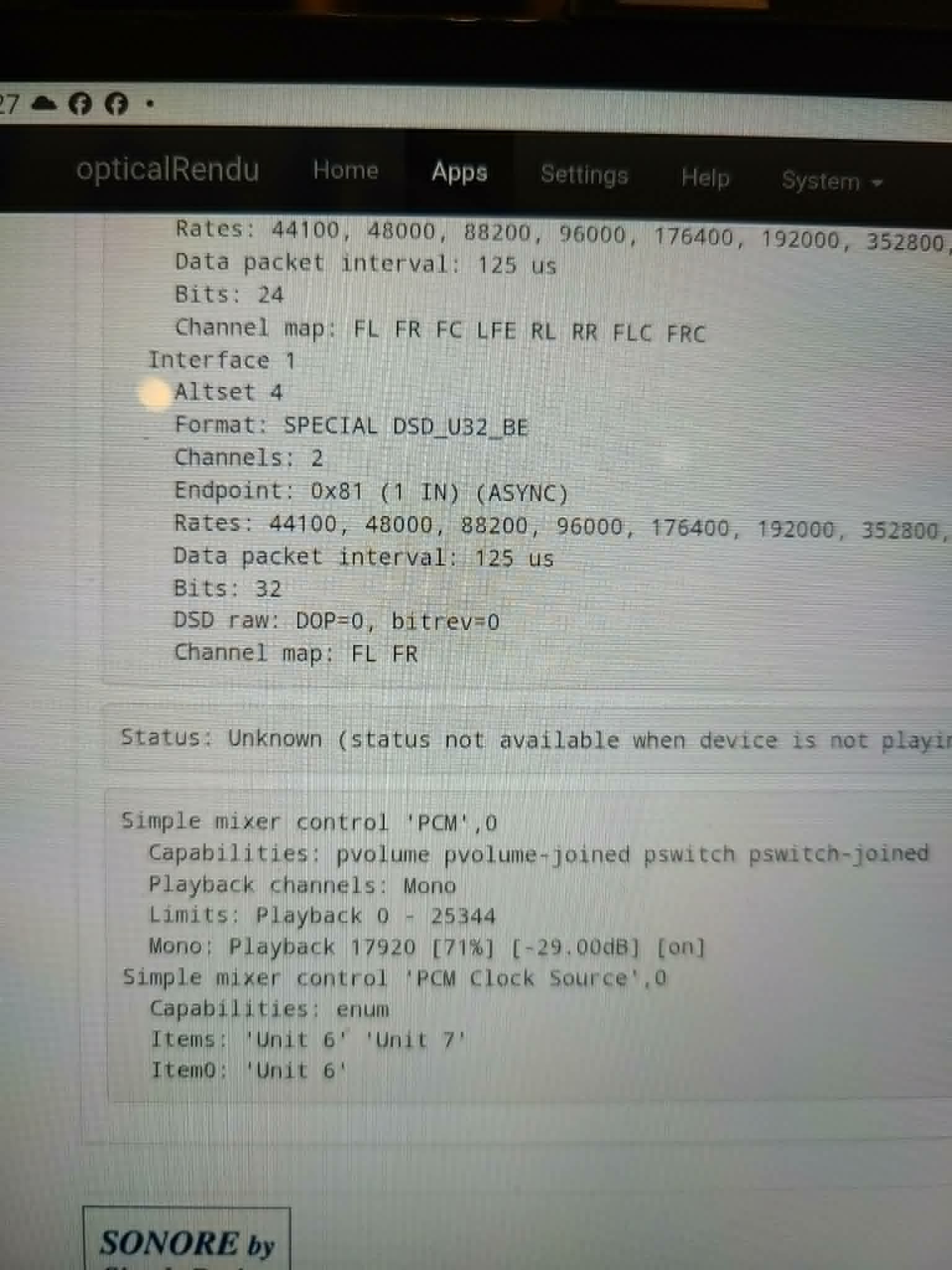

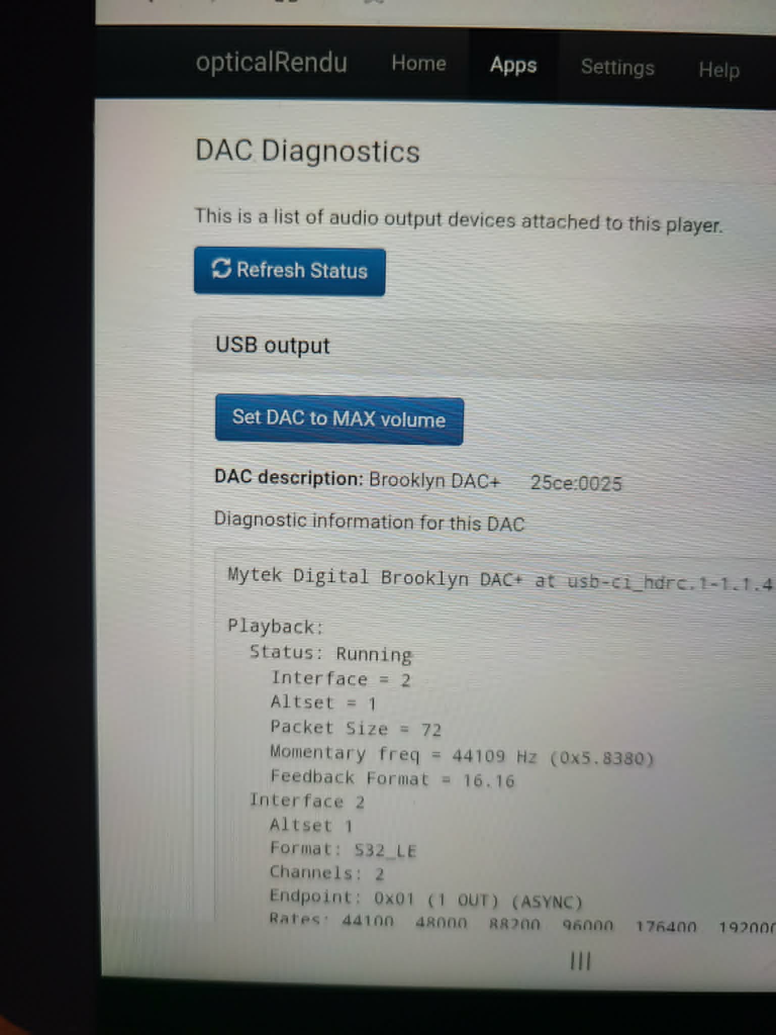

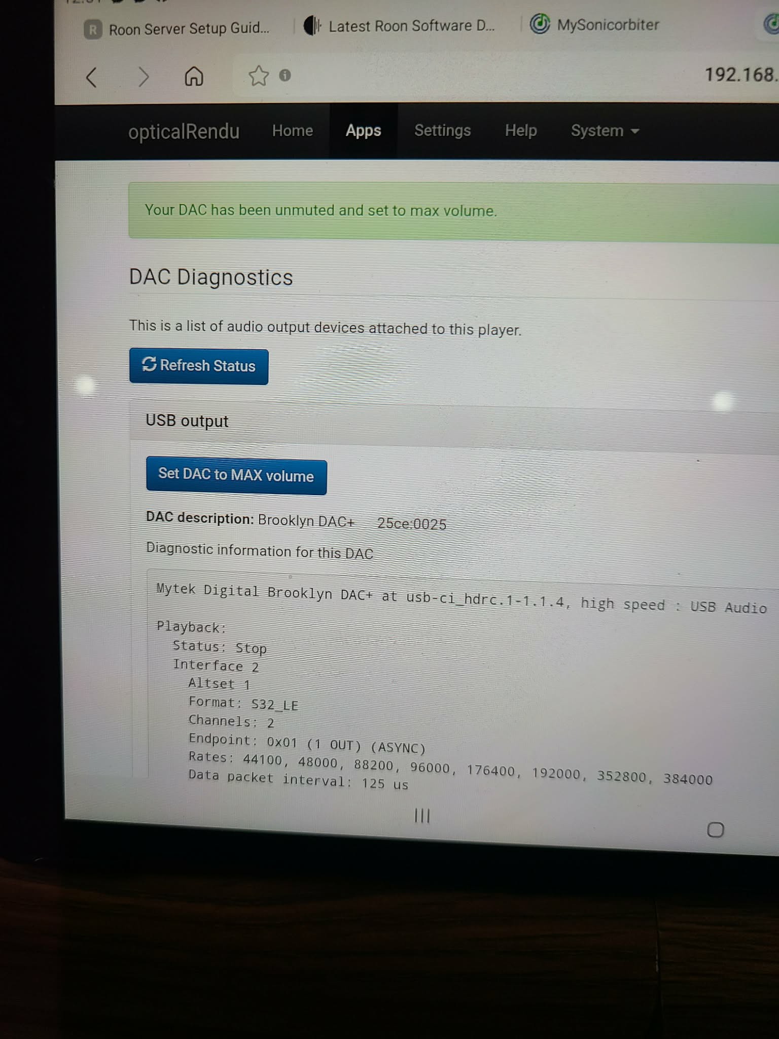

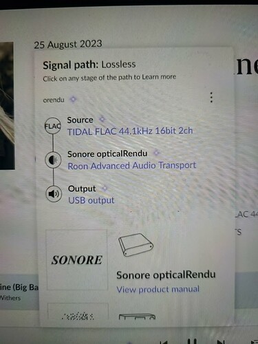

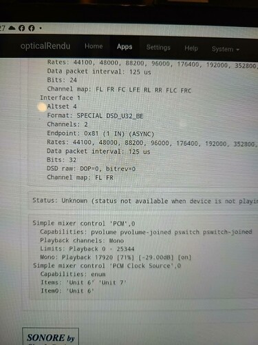

Here are the latest Dac diagnostics that I sent the techs at Sonore today.

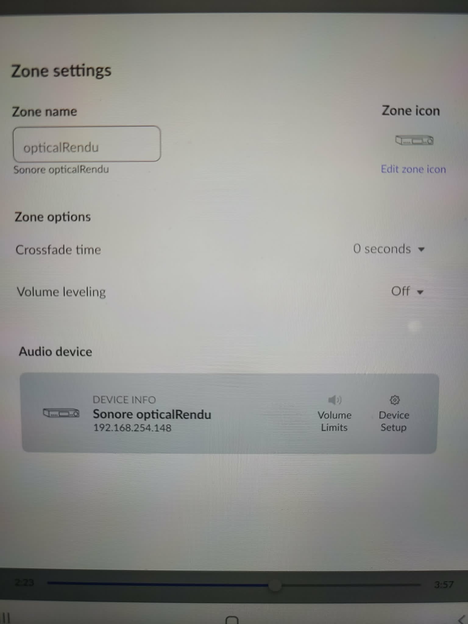

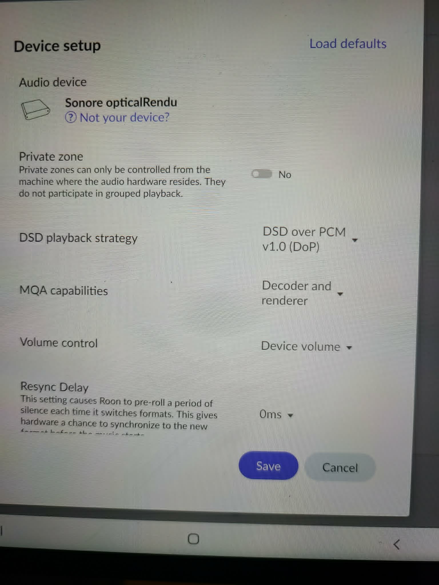

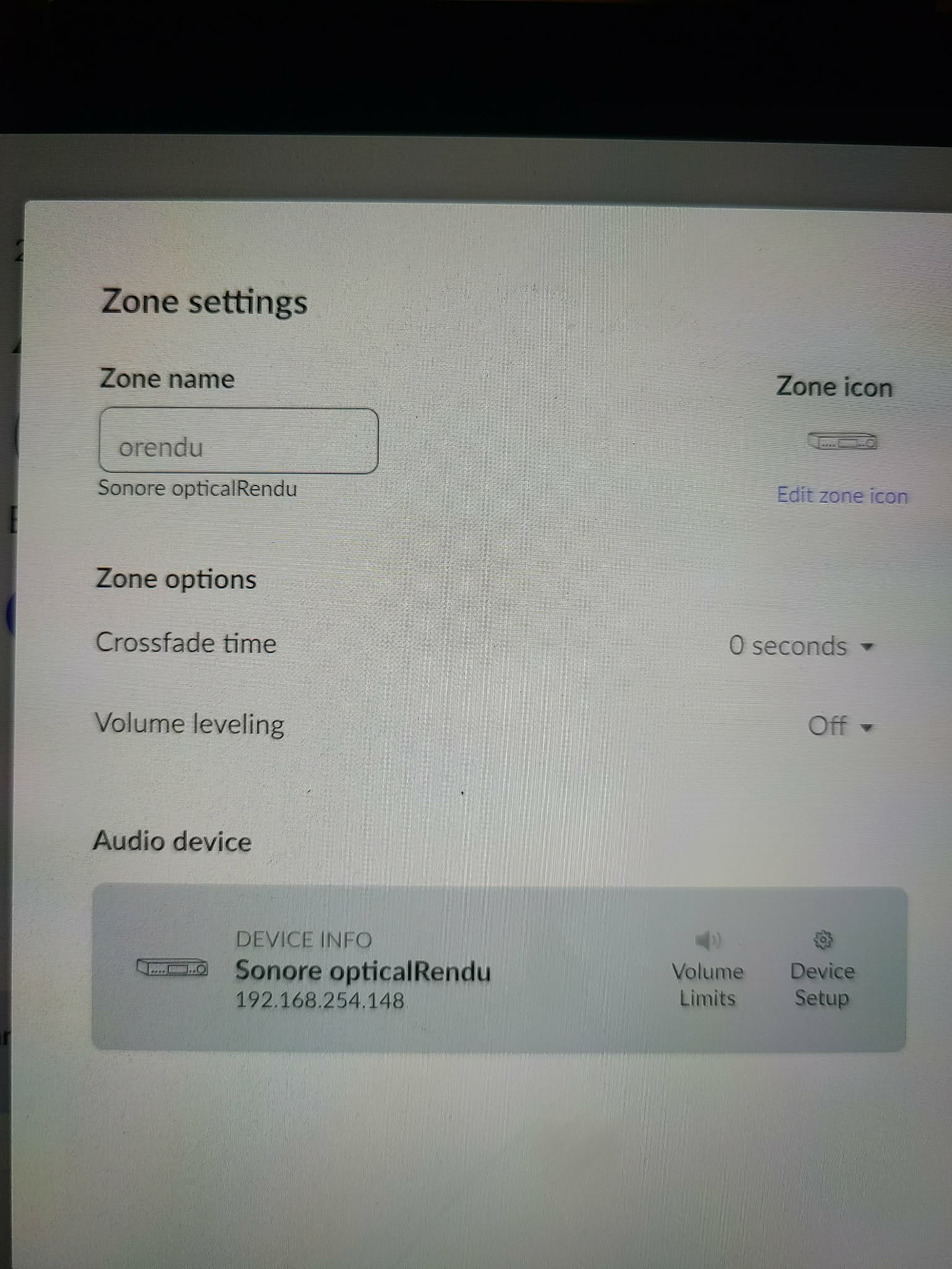

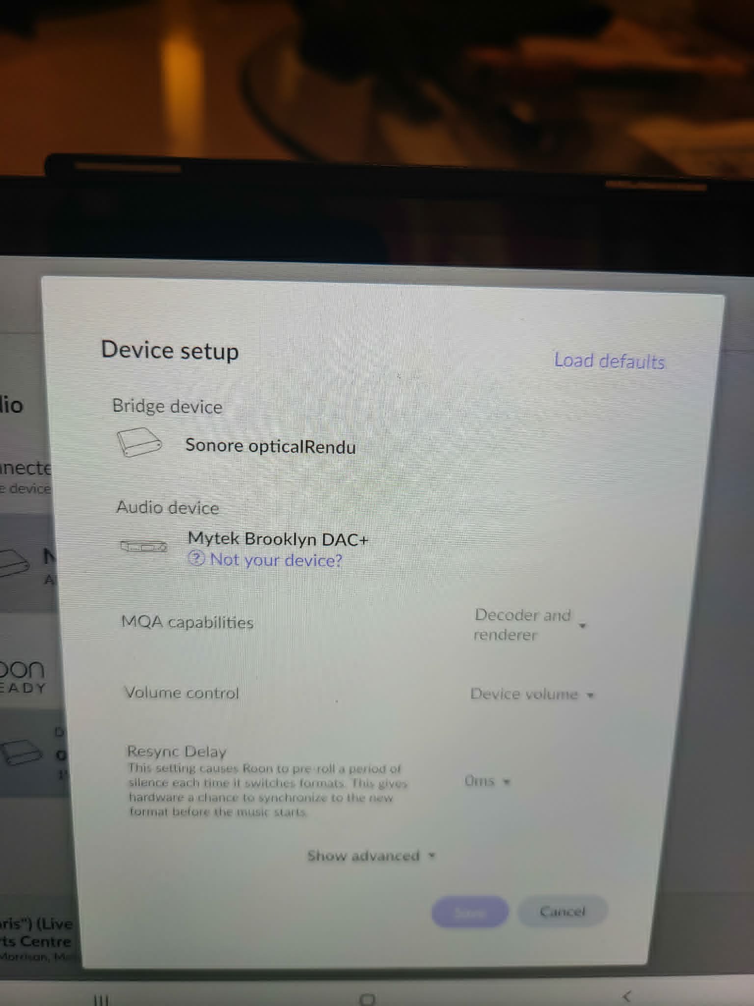

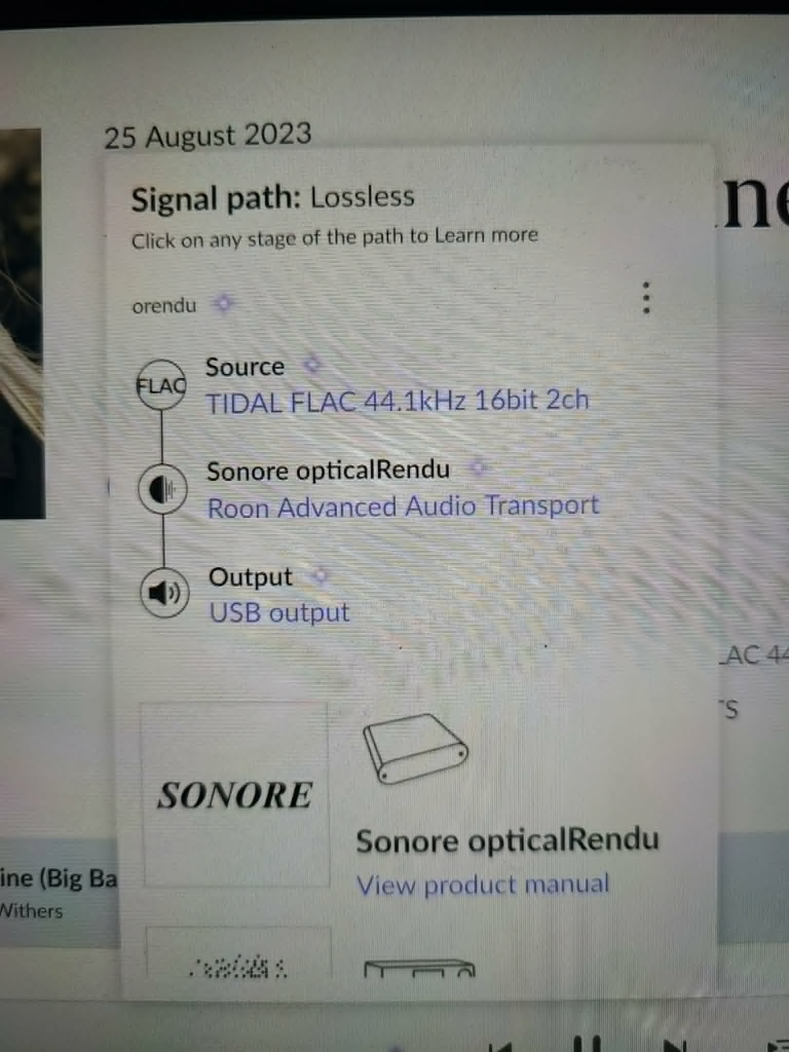

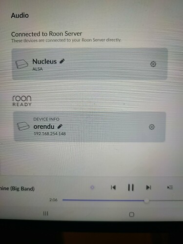

Here are the latest screenshots from Roon

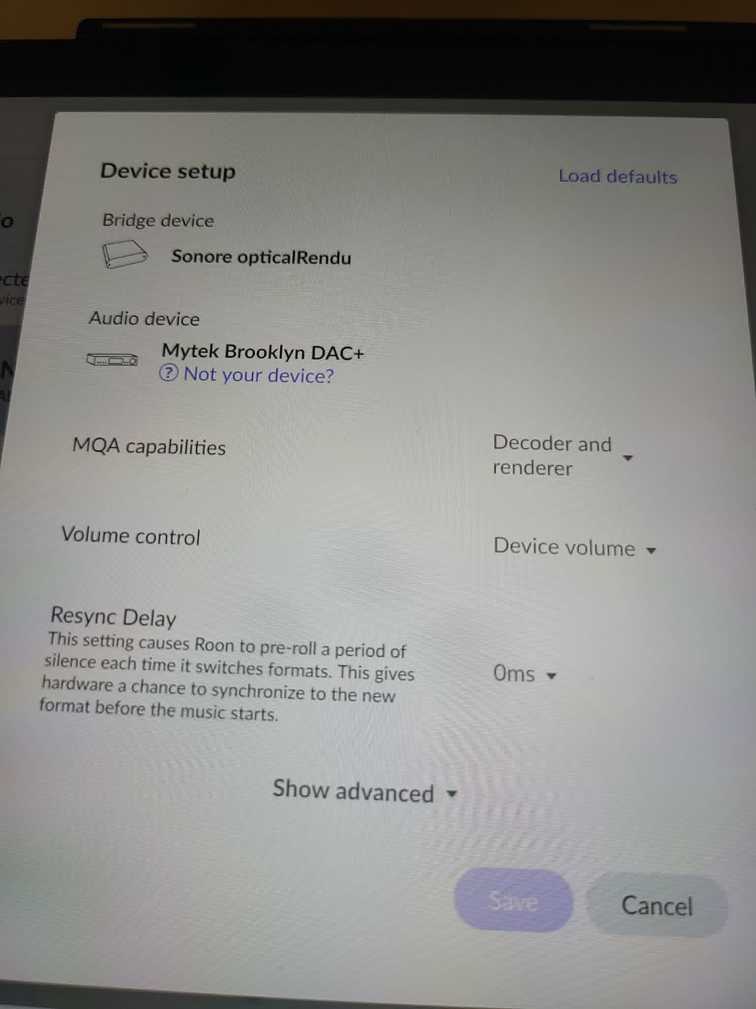

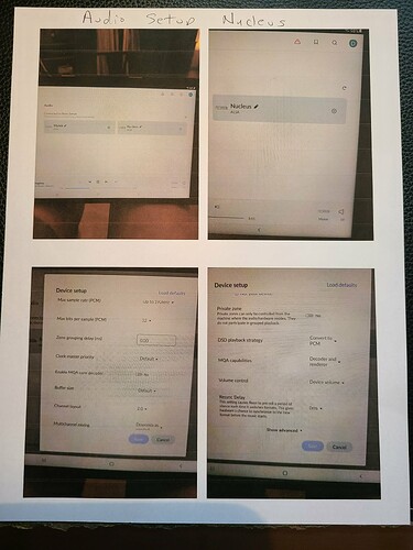

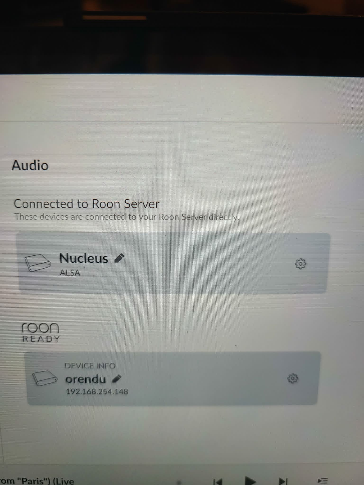

The first is from the setup Audio page for the Nucleus settings

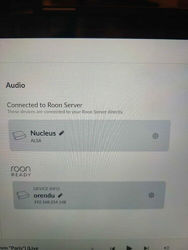

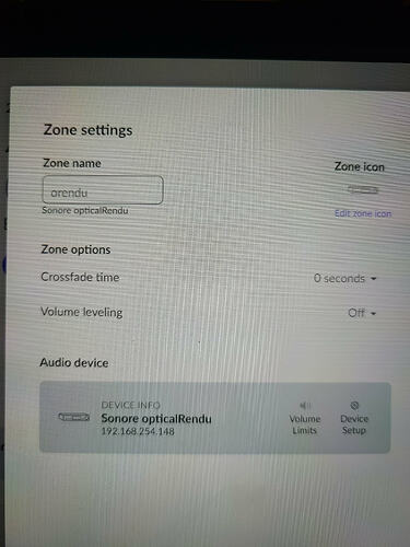

The next set is also from the Audio setup page for the Sonore opticalRendu

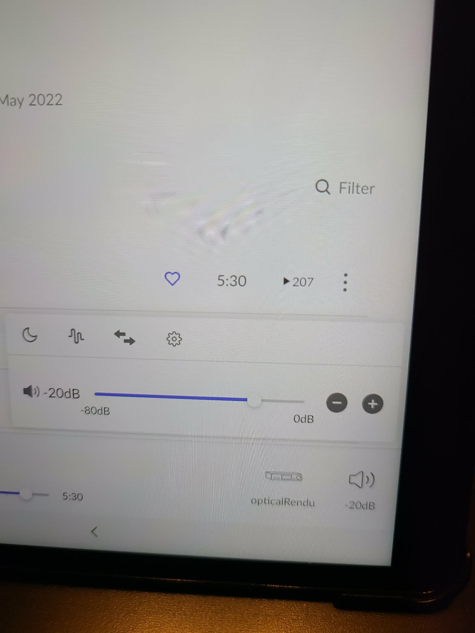

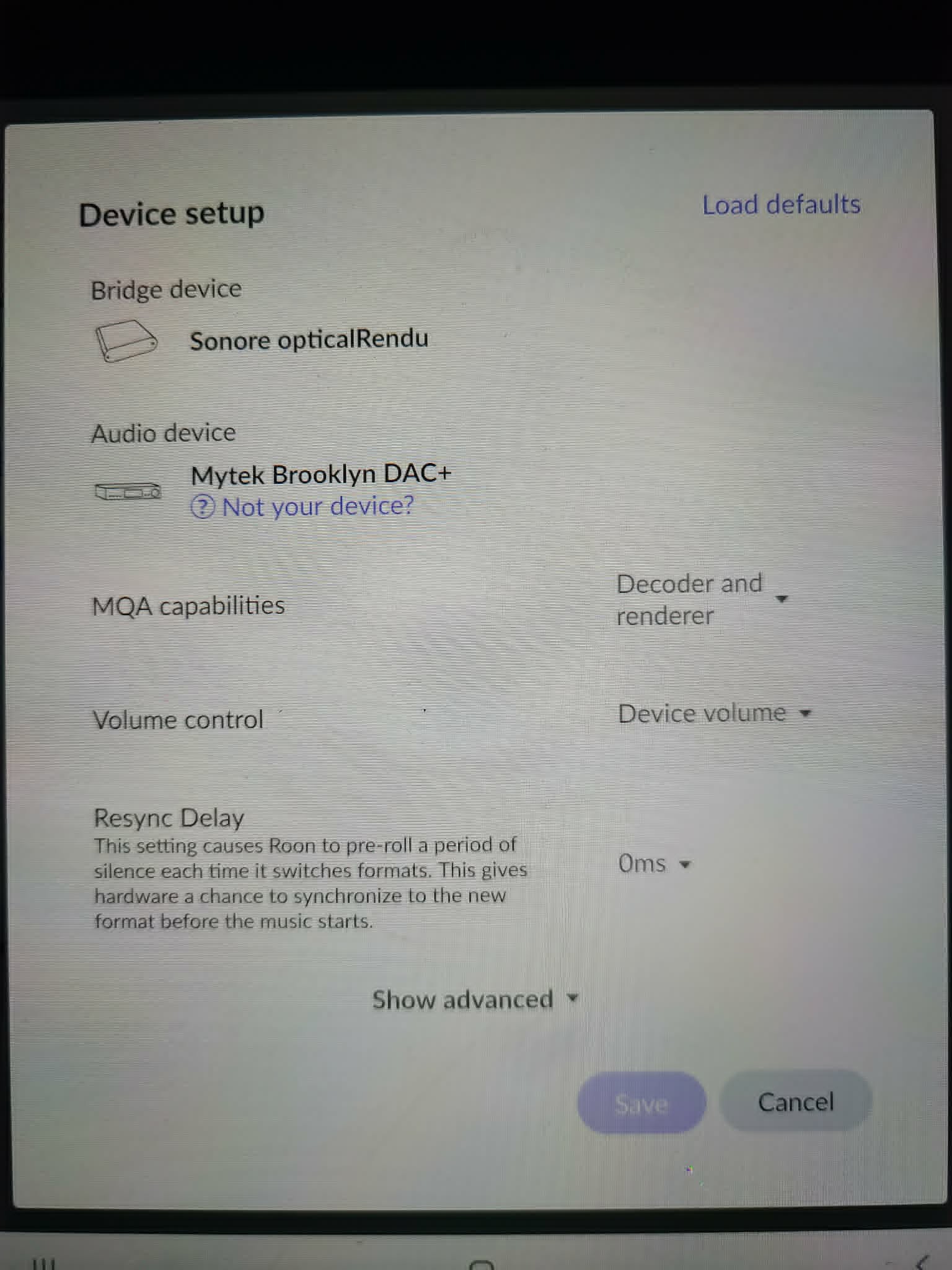

The next set is from the Roon app running
Could any of these settings be preventing the Roon app from changing volume control is fixed?

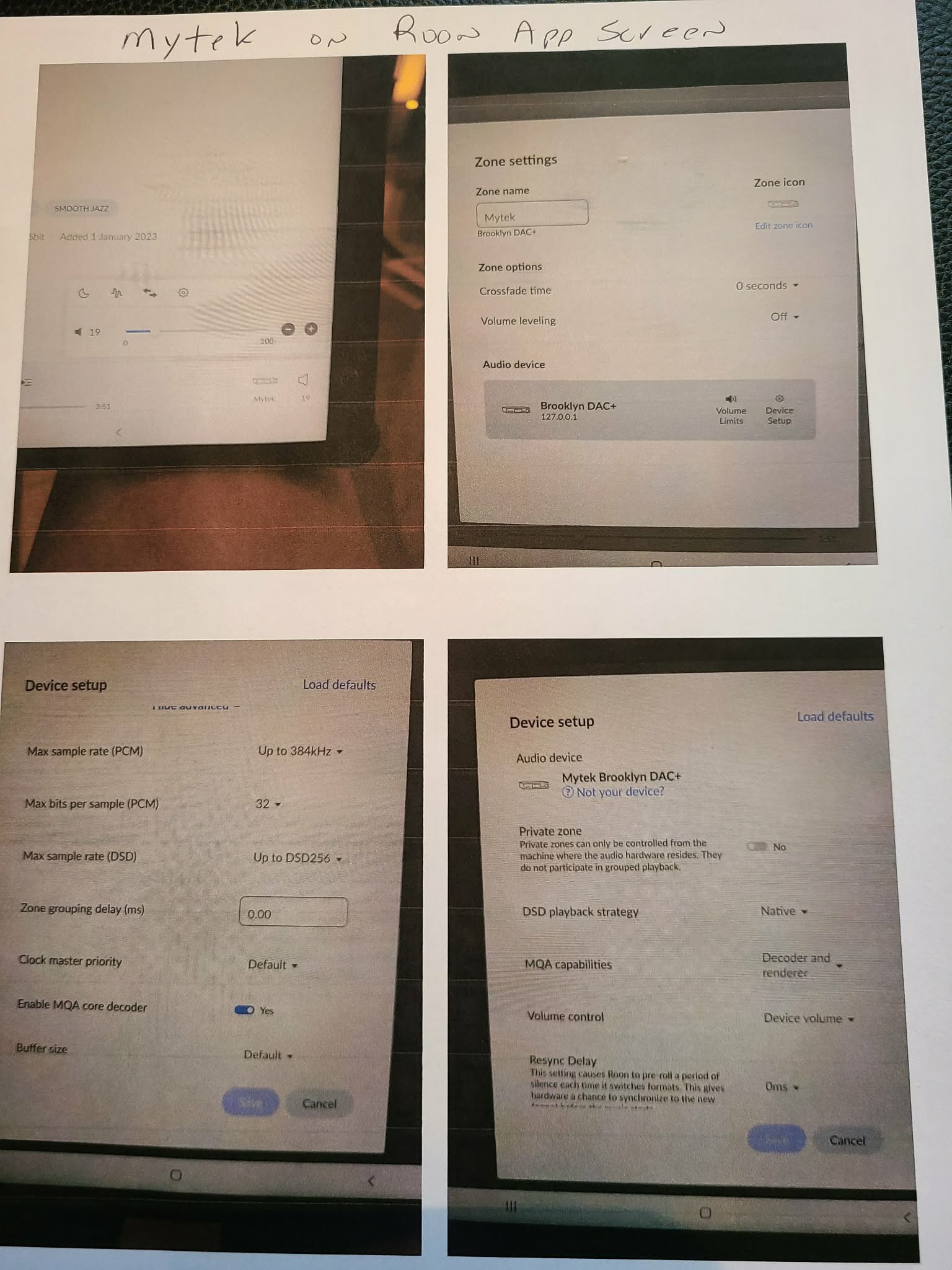

Hello Benjamin / Roon Tech,
We need to resolve this issue of Roon staying in the fixed audio volume,

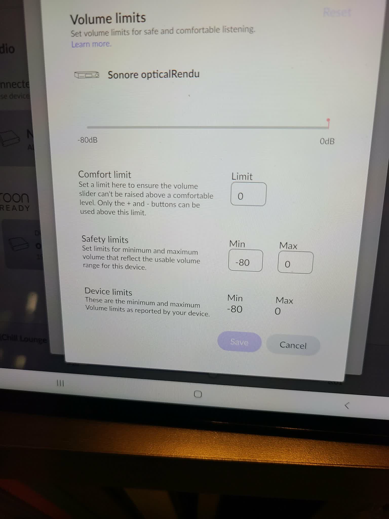

Here are scree shots of many the attempts I have tried to resolve this,
Jesus Rodriguez the lead tech at Sonore told me to set the Mytek Dac volume to Max in response to your ALSA msg to me. His email is Sonorejr@gmail.com
Please look into this issue, I have spent hours trying to figure it out, If necessary please contact Jesus at Sonore to help resolve this.

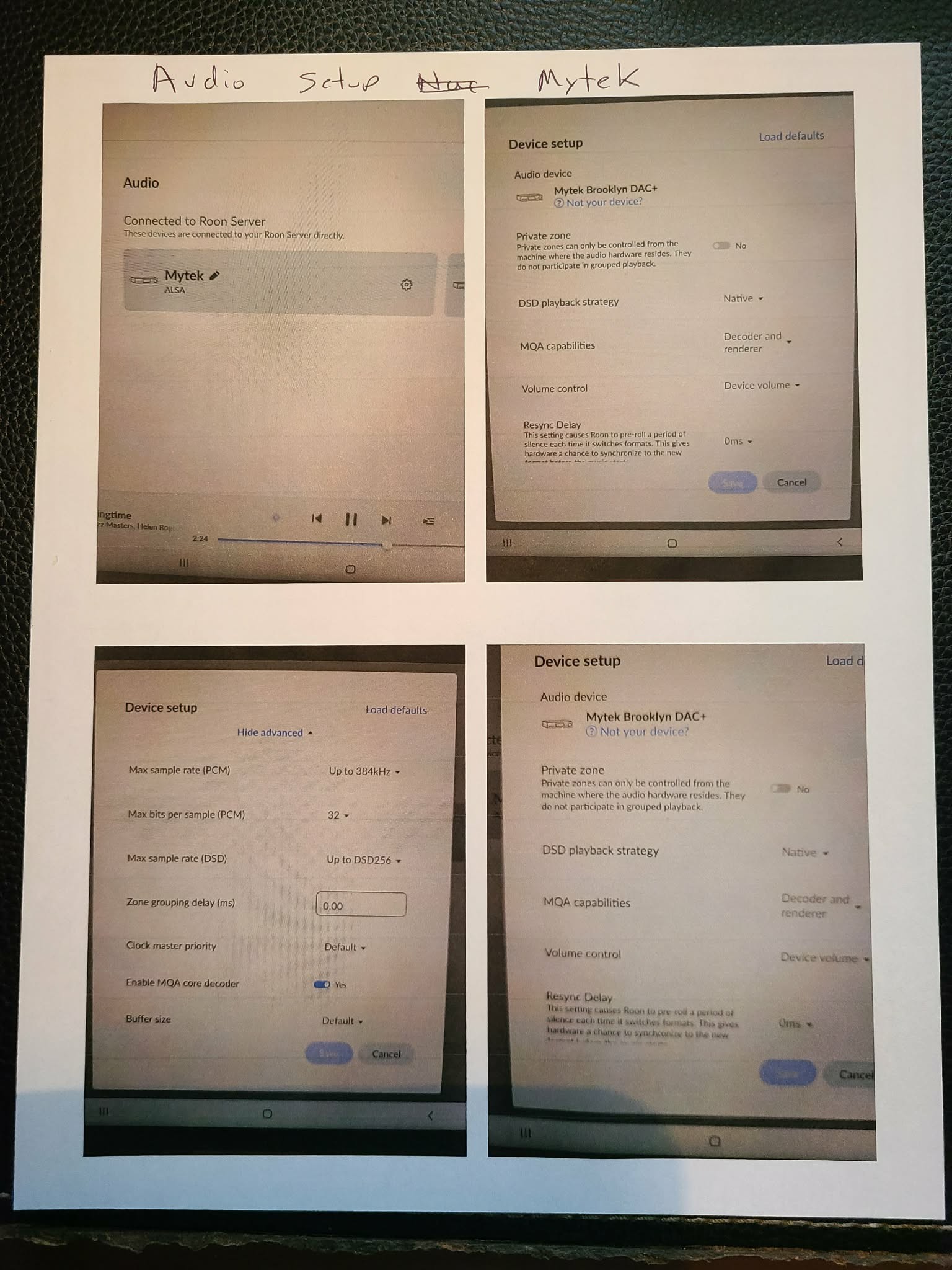

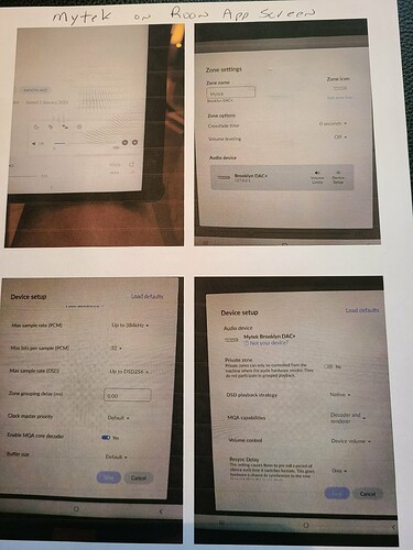

I was hoping for a response to my recent replies. Today I will by-pass the Sonore system completely and just run Roon directly to the Mytek, to see if then the volume control will be controlled by Roon. This will possibly tell if the issue is in the Sonore system.itself.

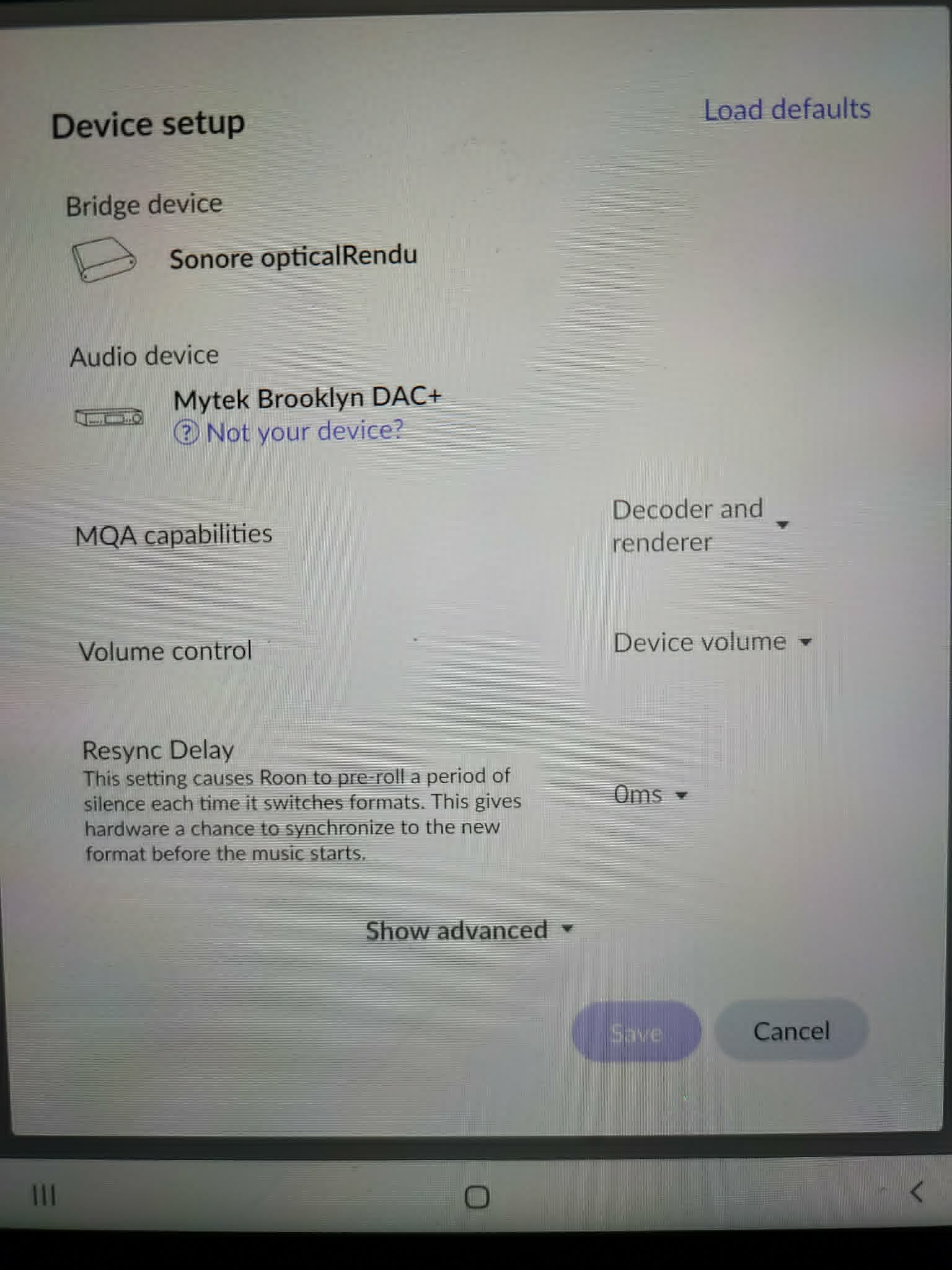

I went ahead and hooked up the Nucleus directly to the Mytek Dac+. Roon works exactly as it should as volume control on Roon now adjust the volume. The Sonore tech now wants me to " Copy all the settings from the working nucleus with the USB device connected to it over to the nucleus when it’s streaming to the Rendu". “If you have it working directly on the nucleus, then you should look at the settings/audio on the nucleus for the USB device and copy all of the settings, including the advanced settings” Here are the setting with just the Nucleus connected to the Mytek Dac+.
Does anything stand out before I reinstall the Sonore system?
Thanks

So, the Sonore tech’s advice (“copy all settings from the working Nucleus-direct config to the Rendu config”) is partly right. The Roon-side endpoint settings (Device Volume, etc.) are worth matching, but the real variable, whether the endpoint advertises software dB or ALSA hardware volume, is controlled by SonicOrbiter on the Rendu, not by Roon’s UI. Copying Roon settings won’t change what the Rendu advertises.
Concretely, here are the next steps I’d try:
  1. In the opticalRendu web interface , find the DAC Diagnostics / app settings and switch the volume control back to software volume rather than the ALSA/hardware USB mixer. If the outage reset SonicOrbiter, a Rendu config reset or SonicOrbiter reinstall (which Sonore can walk you through) should re-establish the original software-dB behavior.
  2. Afterwards, In Roon, confirm the Rendu endpoint is set to Device Volume (not Fixed). This alone won't fix it if the Rendu is still advertising hardware volume.

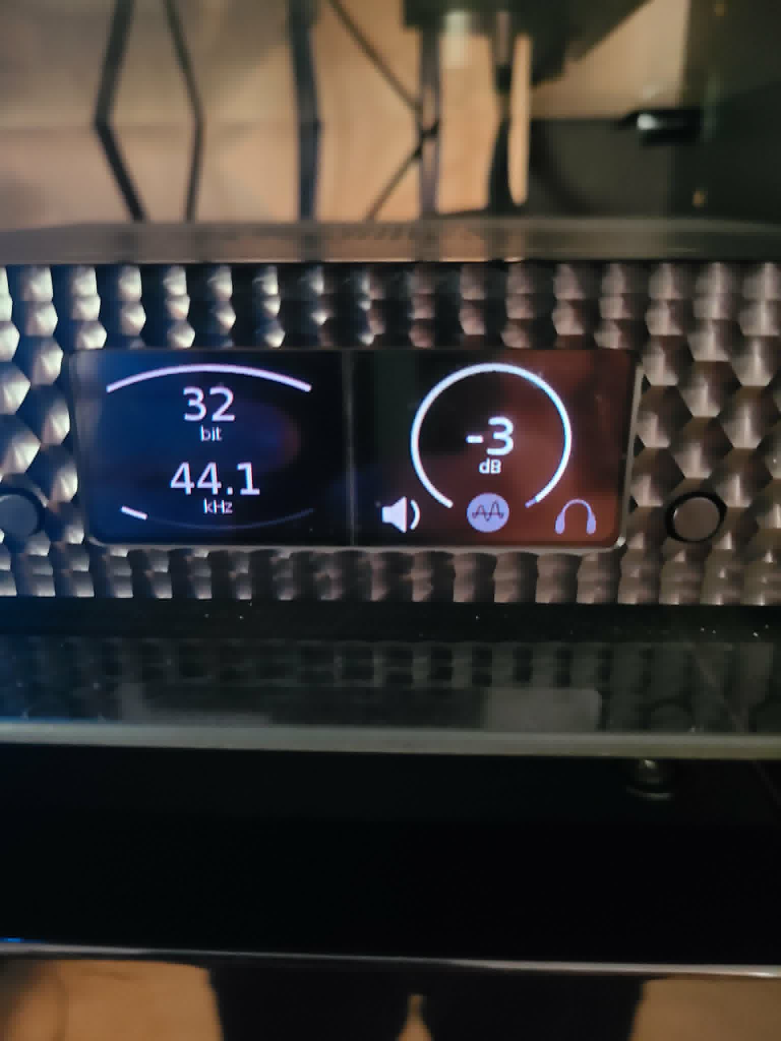

Some things just don’t add up. I did as you suggested and went to Sonicorbiter and changed the settings from hardware to software. When I did that while it did allow Roon to control the volume again, for some reason when playing different selections of music the Mytek would only show 16/44 readings no mater what I played even though the selections were of different readings.
I then went back to Sonicoribiter and set the Rendu back to hardware. Today when playing music again for some reason now everything works as it should. Volume control on Roon, Mytek shows all settings, etc It’s like the system has a mind of it own. I’m not complaining just baffled and glad it is now all again working.
