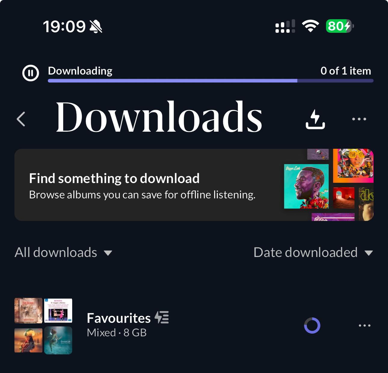

Downloading state remains permanently stuck on “Downloading 0 of 1 item”. The download does not progress. Roon ARC storage consumption does not increase. Downloading works as expected when connected directly to the wifi with Roon Server.
I tried disabling requirement to download over wifi in case Tailscale over wifi was not considered wifi by ARC, and this did not change the behaviour. For below screenshot, the playlist was partially downloaded while connected to the same wifi as the Roon Server. The same behaviour occurs when downloading a playlist or an album.
iPhone connected to Roon Server Linux via Tailscale over wifi (different wifi from Roon Server)

Hi Connor – As soon as I re-connected to my home wifi and opened Roon ARC app on my phone the downloads completed, without making any changes in Roon or to address the bad track data. Additionally Smart Downloads, which were enabled but not downloading while using wifi away from home, also immediately started working once connected to home wifi. There may be bad track data, but there is a definite difference in behaviour between being connected on my home wifi vs. being connected on another wifi + Tailscale.

I removed the album from Roon, ran library cleanup, and put the files back. The album looks the same as before in Roon and Roon ARC, with the same download behaviour: I’m not near a public wifi to test downloading with Roon ARC, but on 5G + Tailscale with “Download over wifi only” disabled I get the same behaviour as above. As soon as I joined the home wifi the download completed immediately. It may be some time before I am near a public wifi again to test.

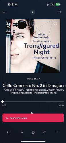

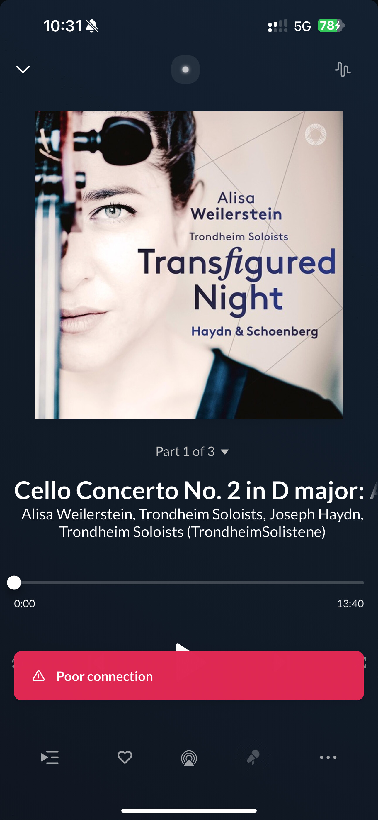

Streaming (non-downloaded play) from my local library does not work now over 5G + Tailscale, getting a “Poor connection” error consistently, even though streaming worked previously fine and it was downloading that didn’t work. When I look in the Roon Server logs I don’t see any errors. I can see the song being requested and encoded into Opus, and then the encode finishes, but the song doesn’t play, and I get a “Poor connection” error after some time. When I retry downloading the song after it has already been re-encoded once, I see the request come in with “got playbackinfo” logged, but no playback and eventually “Poor connection”.

Hi — Alyssa Weilserstein, Transfigured Night, track 1 Haydn Cello Concerto #2 first movement. At the time I was connected by 5G with Tailscale, and Roon ARC searching etc. worked, as well as other uses for Tailscale to that system.

From my message #7 above about 24 days ago, I’m now getting a different behaviour from original, where downloading works but streaming from my local library does not. I followed your test procedure and the download worked in both cases, but that is not testing streaming from the local library. I tried streaming several random songs via Tailscale and all fail. Streaming works immediately once I enable wifi on my phone.
When I look in RoonServer_log.txt I see the request for the song and the transcoding messages, so there is some basic communication working, and I do not see any error messages. Can I enable additional debugging that might show us what it is doing?

Hi @Connor – I deleted ARC from my phone, reinstalled, opened app, authenticated. Albums, cover art, playlists, searching are all working via Tailscale. Streaming from my library is not working – ARC reports “Poor connection”. I did this twice to be sure. I then downloaded the album that I tried to stream from via Tailscale + 5G, which succeeded, and then I was able to play the downloaded songs only. Streaming looks to be doing something different to all the other actions in ARC.
