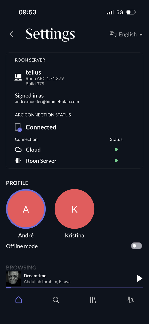

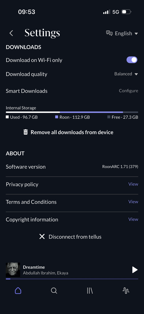

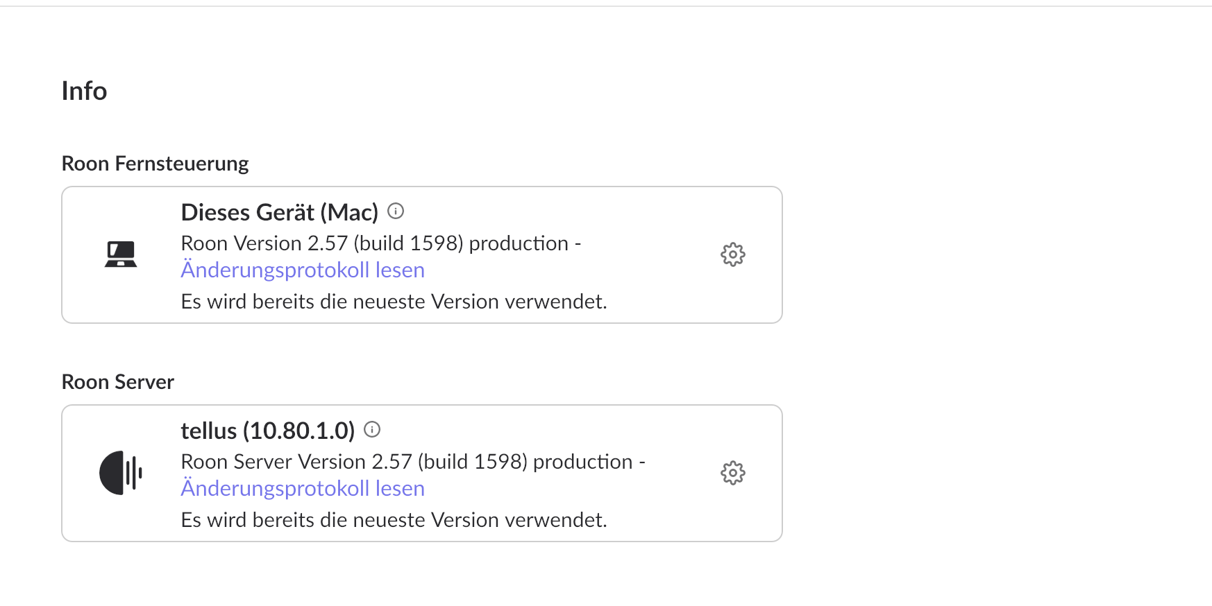

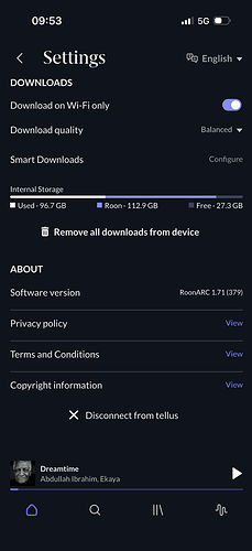

Hi @Andre_Muller,
The key distinction here is that reinstalling ARC is the only way to restore connectivity. That means that ARC is never attempting a handshake retry because it believes it’s talking to a different server - if you haven’t actually migrated/reinstalled ARC, then we can only conclude that ARC cached an “incorrect” tunnel connection to the server. ARC’s never going to attempt to connect to the original server again once in this state.
Please share a screenshot of the Status → Summary screen (including build number) in your ARC settings page. Development needs to confirm a few details we haven’t reviewed in this conversation so far and that will be the simplest way to do so.
I know you’re resistant to changing any Opnsense settings, but it really sounds like the persistent HTTPS connection between ARC and your server is become stale. Is Suricata enabled in your Opnsense settings? Have you tried creating an identical rule to your port forwarding rule there? Try setting any firewall optimization settings to conservative or similar, if those settings are available.
We’ll watch for your response.

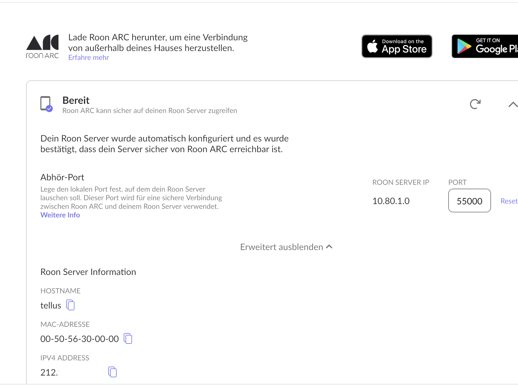

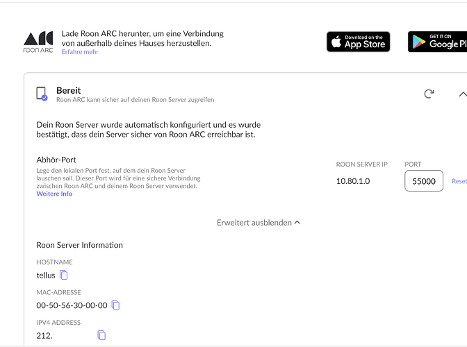

Hello
Thank you again - sorry my text message was deleted by uploading the images:
  • We do not use Suricata or any other DPI on the OPNsense router/firewall.
  • There is no firewall optimization active and/or enabled.
  • The firewall rule with port forwarding 55000 to the internal/local static IP of the server where the Roon Server is running is on the very top of other default firewall rules.
  • We update our OPNsense router/firewall base regularly when updates are available (1-2 times a month) and the ARC Roon issue has absolutely no correlation with OPNsense updates.
Best regards,

Hi @Andre_Muller,
This thread has obviously gone too long without a stated conclusion - please allow us a chance to sync behind the scenes with development and we’ll provide a more detailed update as soon as possible.
Hello
Thanks for your notice.
I wanted to report back, that actually with Roon-ARC (iOS 26.2.1, Roon-ARC 1.71.379) and Roon-Server (Linux, 2.58, updated just today) we did not have the issue “Your Roon Server is online but there’s an issue that’s preventing access” about “corrupted” downloads. Roon-ARC is working quit well.
But just want to report another strange thing with Roon-ARC in relation to our internal Roon-Server (Linux) I noticed today for the first time. Starting-up Roon-ARC on an iOS device from mobile (5G) connection (external network) works fine. Starting-up Roon-ARC on an iOS device connected by Wifi to the same local network where the Roon-Server is in (connected by Ethernet) tears down the Roon-Server twice in sequence of 5 seconds and also disconnects all local Roon-Clients (MacOS) while Roon-ARC seems to work by updating its list. After this event local Roon-Clients (MacOS) have to be restarted to get a new working connection to the Roon-Server.
Best regards
P.S. the same issue (tearing down the Roon-Server by starting up Roon-ARC on iOS in the same local network) also with Roon-ARC 1.72.384).
