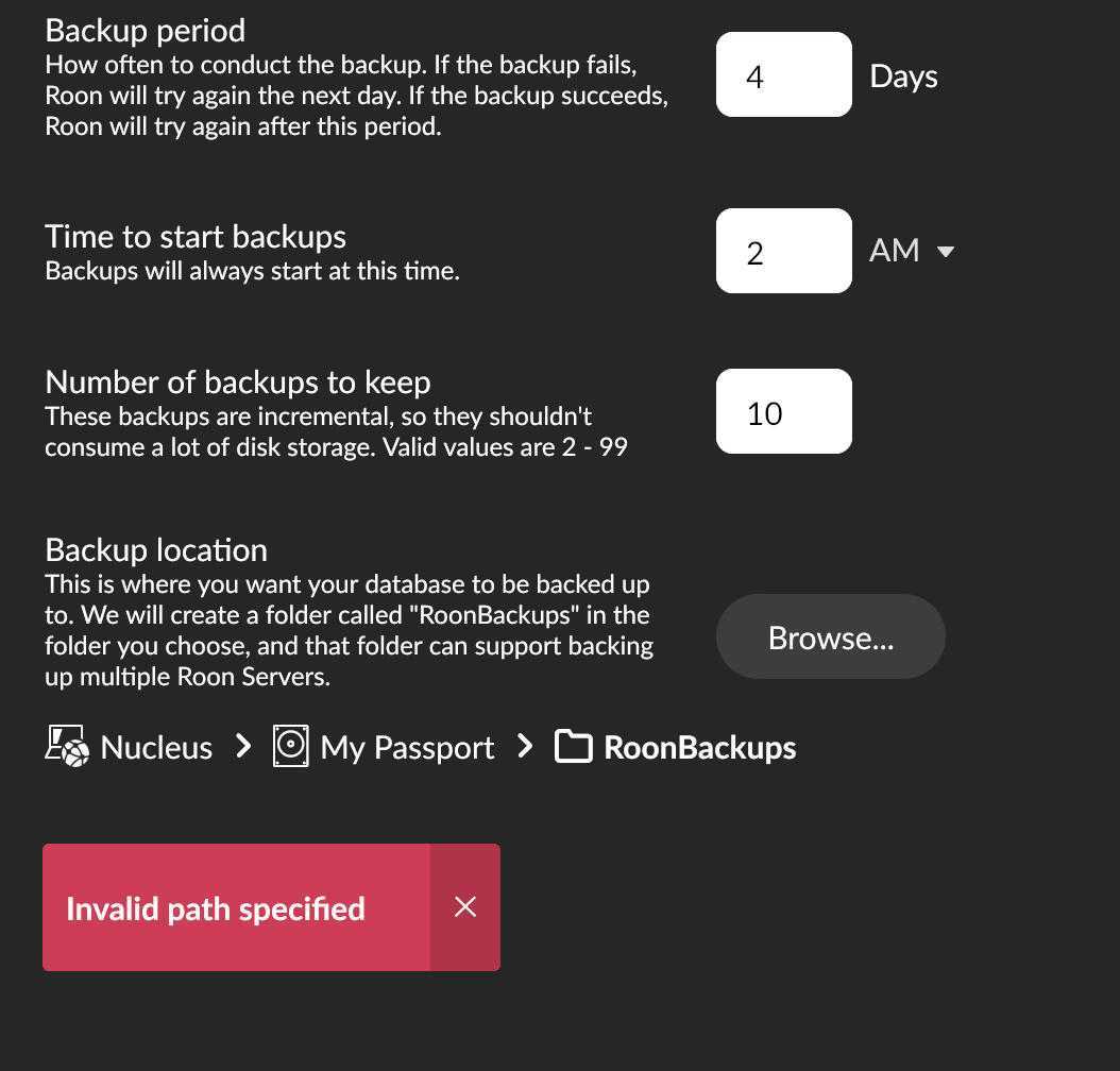

I did try what you suggested with the USB drives. Set both for read and write permissions as far as I can tell. but I still get an error message saying invalid file path. See screen shots below. Any suggestions ?
Not speaking to all your issues, but, with USB drives connected to the Nucleus…
If your USB drives are formatted in HFS+ or Mac Journing format then Linux OS will treat them as read only no matter what you do. The solution is to reformat them to exFAT which will work equally well on Linux and MacOS.
Capture
And keep in mind, if there is data on that drive, you will have to copy it off since reformatting is destructive.
