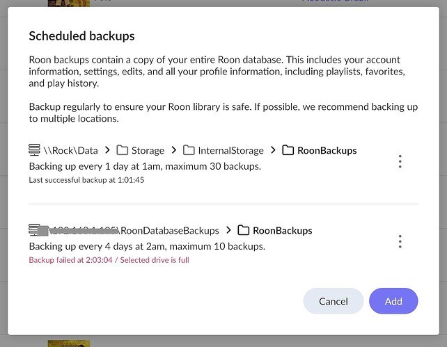

Your screenshot of the scheduled backups that you have set up worries me.
Via a network share, you have set up a backup folder in the 2TB SSD in the NUC which should only be used for music storage.
From the Backup article:
We strongly recommend that you do not set the location of Database Backups to be within any Watched Folders because Roon will try to scan that directory and scan the Database Backup itself. This can cause issues, so please keep the locations separate.

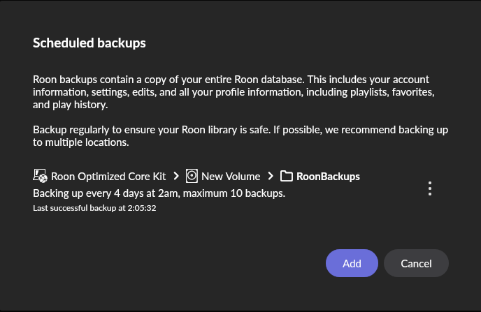

If you want to set up a scheduled backup on your NUC, then you should add a USB drive to hold the backup folder and add it by browsing the local storage, not via a network share. Similar to this:
Backup to an attached USB HDD. You won’t ever have a problem. I took one out of an old computer and got a case from Amazon.
