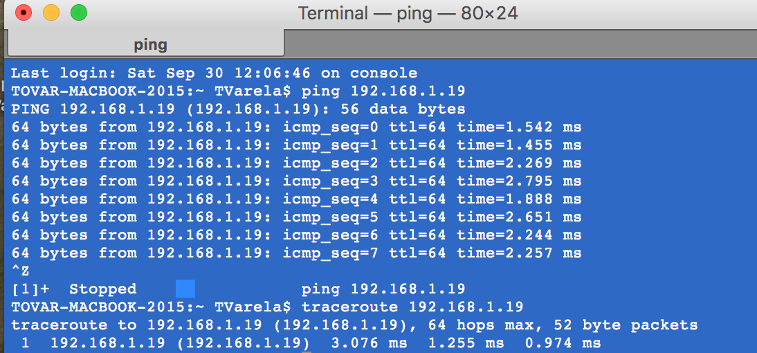

Can you make sure that you are on the same network by issuing a ping command from a Terminal window on the Mojo-Mac?
ping 192.168.x.y
where 192.168.x.y is replaced by the ipaddress of the Roon Core.
(Abort the Ping command by pressing [Ctrl]+[C])
You should see a response similar to this:
PING 192.168.15.11 (192.168.15.11): 56 data bytes
64 bytes from 192.168.15.11: icmp_seq=0 ttl=64 time=0.940 ms
64 bytes from 192.168.15.11: icmp_seq=1 ttl=64 time=1.451 ms
64 bytes from 192.168.15.11: icmp_seq=2 ttl=64 time=0.695 ms
64 bytes from 192.168.15.11: icmp_seq=3 ttl=64 time=1.098 ms
^C
— 192.168.15.11 ping statistics —
4 packets transmitted, 4 packets received, 0.0% packet loss
round-trip min/avg/max/stddev = 0.695/1.046/1.451/0.274 ms
From the Macbook Pro that is Running Roon Bridge and has the Mojo USB attached.

And thanks for the ping/tracert screens, everything looks just fine!

Firewall software? Can you perform the same ping in the reverse direction? I.e. from the Core machine to the Bridge/Mojo-Mac?

@support @Mikael_Ollars ---- Network connectivity between the two devices is fine. A ping works both ways. The MacOsx firewall is running on both machines I disabled it with no change in status. There are no other network filters or anti-virus tools running on my home network . The problem persists.
