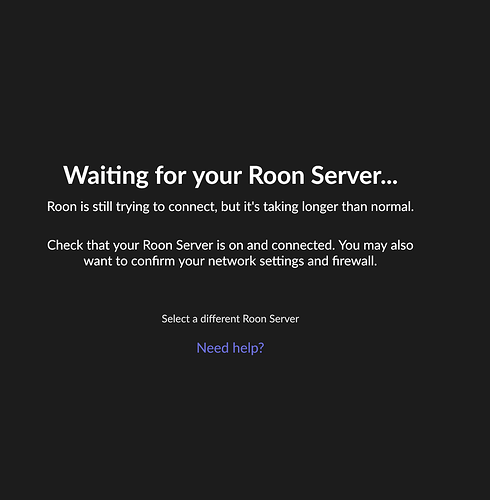

SInce the Roon update in Jan 2024 the Roon app will not connect to the Zenmini. The Zenmini works fine via Innuos Sense app as a stand alone and plays tracks perfectly well.
Nothing else has changed.
I’ve added screen shots
Apologies for technical illiteracy

What happens if you click the “Select a different Roon server” button on this page?
Identifies my zen mini as having Roon core then asks for login: then says you are already logged in and can’t access two Roon cores…
So if there’s an Unauthorize buttin displayed on that screen, just click it and it should resolve the glitch…
@Phillip_Bird,
@Geoff_Coupe is likely correct here. However, if that doesn’t fix your issue then the ZenMini might have disabled “Core” mode for Roon. You can try to go to my.innuos.com to load your ZenMini GUI and then Settings → Roon → Core Mode. Page 22 of this guide relates to setting up Roon with your device.
Geoff and Daniel: THANK YOU (unauthorise) - all good and running well again. I owe you some virtual beer/wine etc.
