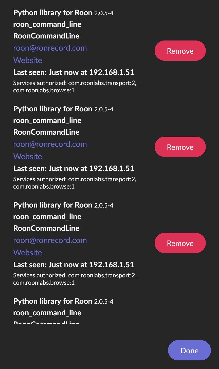

I just rebuilt my Ubuntu Roon Server and installed the latest RoonCommandLine from the git repository. I’m seeing a request for accepting the extension every time I attempt a command? The extension request s then pile up. This seems like a new issue beginning in last few days?
Update: I Remove-d the extraneous mentions in the Extensions authorization queue and am not seeing more piling up. Before this I rebooted the server, thus rebooting Roon Server. FWIW…
@ExUnoPlura thanks for the report and update. The RoonCommandLine commands utilize the Python Roon API to make API calls to the Roon Core. Once authorization has been obtained an authorization token is stored by RoonCommandLine and used for subsequent requests. So you should not see these requests for accepting the extension in subsequent RoonCommandLine command API calls. But, you did see them.
Since rebooting seems to have eliminated the issue, I am going to guess that the Roon Core has some way of identifying the extension+version with the token and you were using a stashed token from the previous version of RoonCommandLine. Just a guess. If so, then it may be necessary for updates of RoonCommandLine to refresh the token or obtain new authorization.
I do not yet know how to resolve this but I will look into it. In the mean time, is all well now? Let me know if you experience this again.
