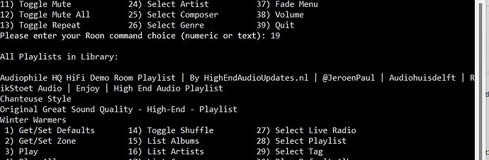

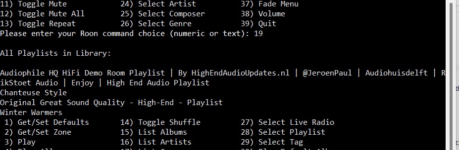

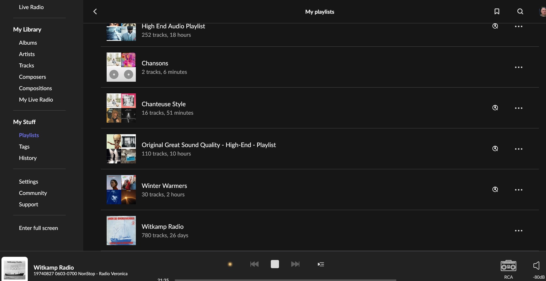

When I list Playlists in Roon Command Line, only my Qobuz playlists ara shown. My personal playlists are not visible, nor can I choose them for playing on a zone. In the attached example you can see that ‘Chansons’ and ‘Witkamp Radio’ are skipped.

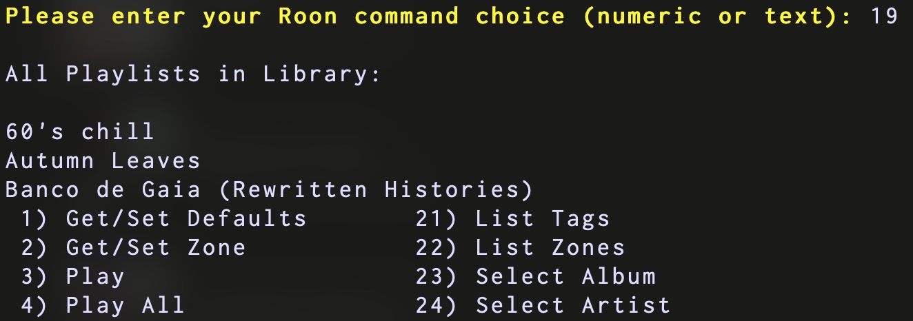

In my setup the only playlists that appear are the ones that are set to be visible to all profiles. Any that are assigned to just my individual profile, as yours appear to be, don’t show up.
For example, only the top three in the following list are visible to Roon Command Line:
The underlying python library (which I maintain) doesn’t understand about profiles.
So I’m not sure what profile it will be acting as - but it’s likely to be the default.
So very likely that the @DaveN’s summary is correct.
Thanks, that was the ‘problem’. It is now working from the commandline:
