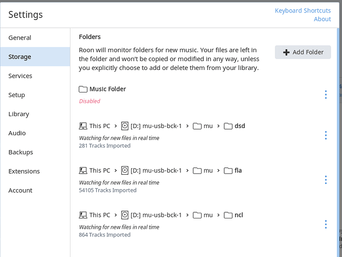

Here is my problem. Just after mounting drive D: in preparation for the sync, I went to the Roon > Settings > Storage screen, and saw that Roon reports that my watched folders are now on drive D:, not on M: as expected (note: M: was still mounted):

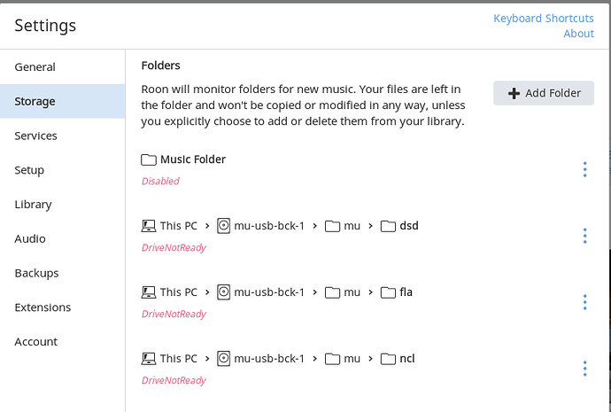

I started to fear that this unexpected switch of drives may corrupt the Roon database. I rapidly unmounted the D: drive, and went again to the Roon > Settings > Storage screen, now to see that the drive is not ready:

This appears to indicate that Roon has trouble distinguishing on Windows file paths which only differ by their initial drive letter, perhaps because the drive letter is not stored in the Roon database. Could the situation reported above have resulted in a corrupt Roon database, for ex. if Roon would have decided to rescan the D: drive which was out-of-sync with the M: drive ? This is pretty scary!

Unfortunately no luck! I reassigned the target sync drive to letter O: so that it sorts after the drive letter M: of the base drive. Simply plugging in the O: drive made Roon immediately switch the watched folders to O: ,as before. Unmounting the O: drive leaves me with a DriveNotReady indication. Stopping and restarting Roon corrects the situation.

I can’t prove this without logs from the Roon core system, but I think it’s very likely that the problem here is that both USB drives have the same NTFS “Volume ID”, and Roon gets confused as you’ve seen. If you upload logs I can confirm, or you can try the fix blind:
You need to change the Volume ID of one of the two disappearing drives. To do this,
  1. Download the VolumeID program here: https://technet.microsoft.com/en-us/sysinternals/bb897436.aspx
  2. Follow the instructions here: http://www.wintips.org/how-to-change-hard-disks-volume-serial-number-volume-id/
(For reference, this is the first thing I’d expect given “Roon only sees one of two drives” and, importantly, “both drives are the same model/size/etc USB from the same vendor”)
@ben Thanks a lot. You got it right! My 2 USB external drives had the same “Volume ID”. Assigning new ID to the 2nd drive with the utility you pointed to me solved the issue.
