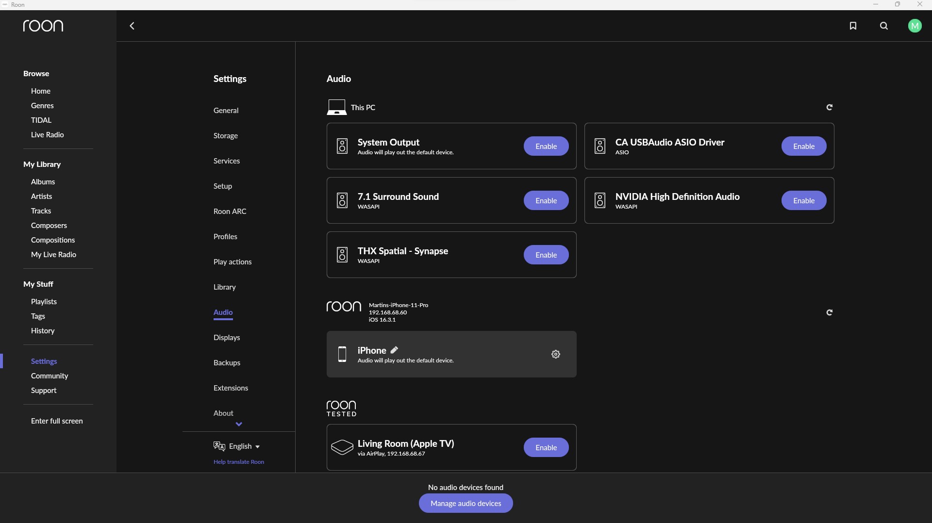

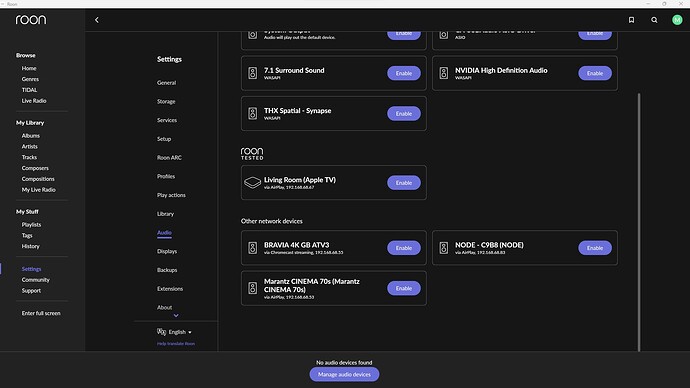

Managed to setup my Roon to Bluesound Node, and linked to DAC Magic, sounded amazing, all worked perfectly. Disconnected everything to tidy it into cabinets and stow cables neatly, and now Roon doesn’t see the Node other than for Airplay.
If I use Tidal I can connect using Tidal Connect and it all plays perfectly (MQA perfect) which removes a lot of variables (sorry, I used by a Quality Engineer for Bowers an Wilkins…)
I’ve done a factory reset on the Node and made sure it’s on Ethernet and not WiFi. So it’s definitely not the DAC Magic, Desktop PC, Network, Cables etc.
As far as I can deduce it’s either Roon can’t see Node, or Node can’t see Roon, but software is not my forte, so now I’m stuck. Any suggestions on what to try next please?
@Martin_Boys, welcome to the Community. Just a fellow user here. There may be a few options to address what you are experiencing.

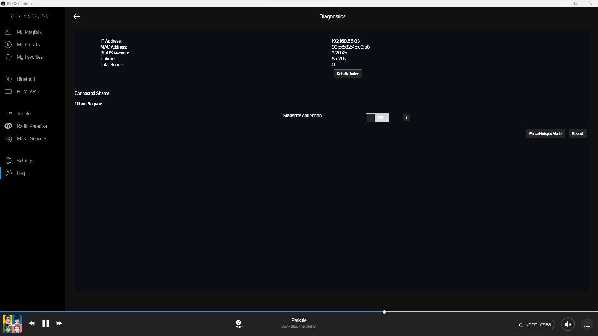

First, Bluesound has had issues with firmware 3.20.45 being able to see Roon. I see that .46 was released, but it is not clear in the release notes that this addresses the Roon problem. I am not a Bluesound user, but I believe .28 was stable with Roon and as long as you don’t need to connect new NAD or Bluesound devices, it may be worth checking what firmware is on the Node and re-install .28 if it is on something different.

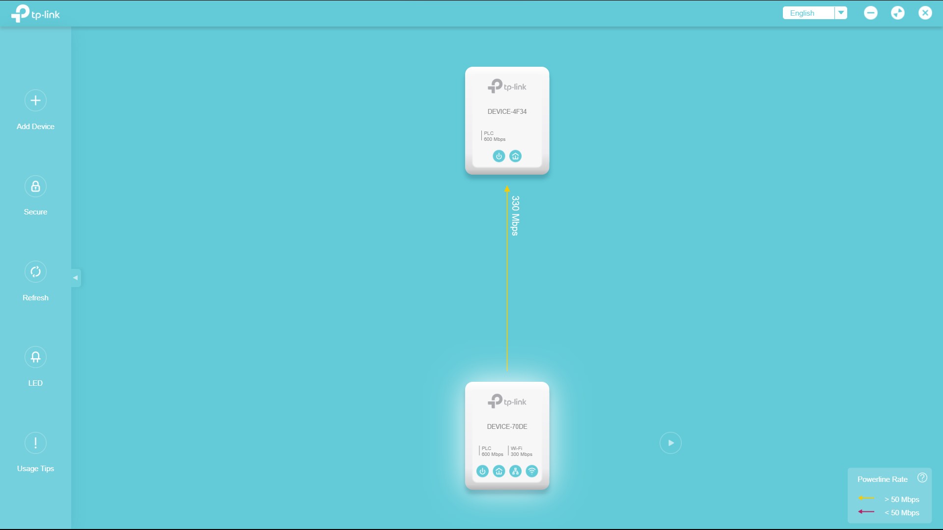

Second, can you confirm that the Node is on the same IP network as the Core? What is the LAN IP address of the Node and what is the LAN IP address of your Core? And can you confirm the Powerline connection works? Powerline connections tend to be a weak point in home networks, but that does not mean it cannot work reliably.

I thought I’d attached this photo, as I knew it’s often a weak link, but pleasingly the PowerLine has been working perfectly. I only have 360 Mbps Broadband, so I’m happy with that
Both are on the same Network Number (198.168.4.65 Core 198.168.54 Node) and hasn’t changed since it was working perfectly.
I think you’re probably right about the Firmware from everything else I’ve read. Can’d find a way to roll it back unfortunately. Even factory reset doesn’t
