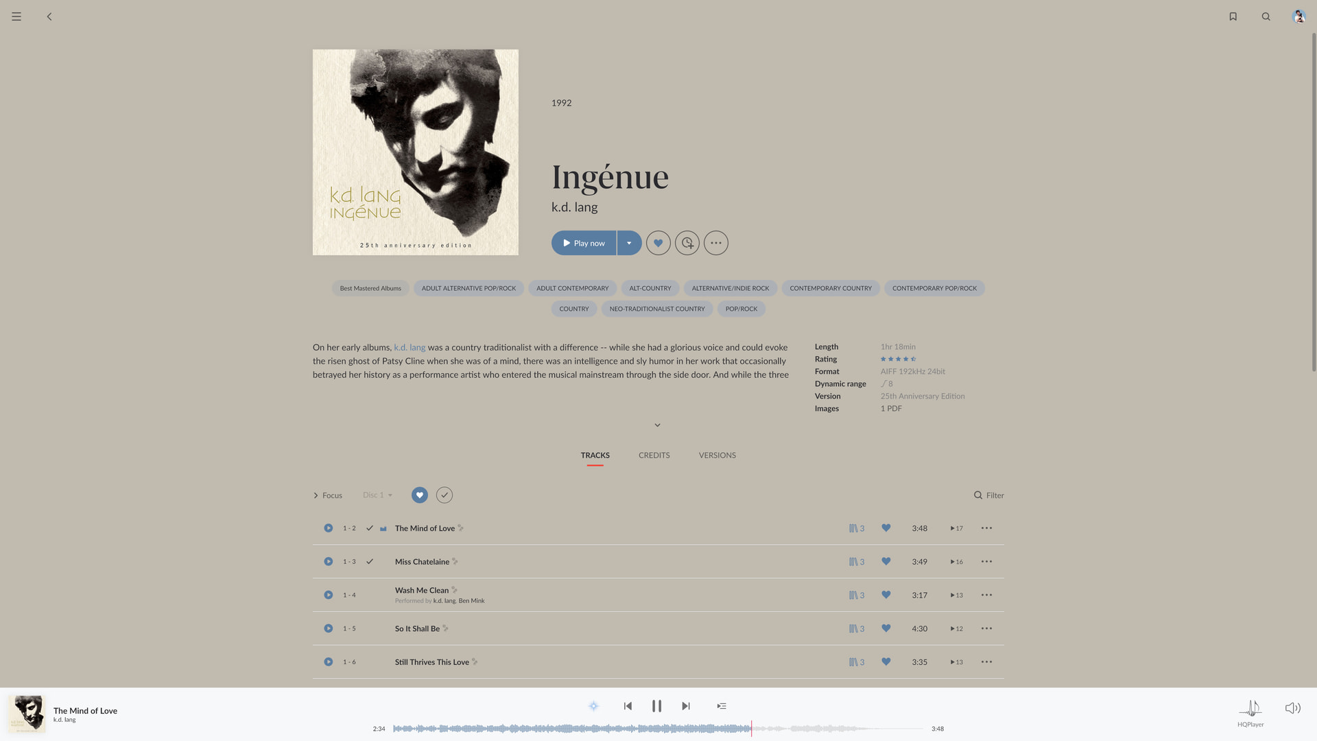

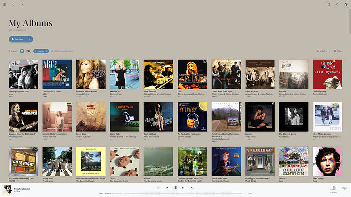

yes the Theme code has changed from being of 107 to 135 lines long and this happened a release version or two back. I am now running version 2.65 with my theme adapted to the new Colour File length of 135 lines for the Light Theme. This theme is of a Mid Tone and to me far more pleasing than Roons default Light or Dark Themes. I am a headphone user only so sit at my desk and in the evening or night it is far more pleasing to the eye.

and I should have said it now works perfectly.
