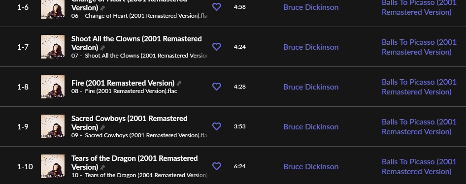

I started listening to Balls To Picasso by Bruce Dickinson, and noticed that my local version had 25 tracks vs the Tidal one with 26

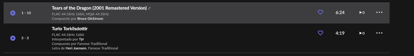

The missing song was the last one from CD1, track #10 Tears Of The Dragon , so I went to the folder view to check it and there it was:
The thing is that when I click on the album in the folder view it shows a playlist I had locally, which I DELETED, and contained the Tyr song I originally posted about.
Then I started checking all the albums with songs from that playlist, and the songs that were added to the playlist, are missing from the album view.

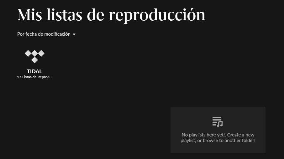

Just to be clear, currently I DO NOT have any local Playlists
So…my theory is that somewhere there’s some sort of a residual file that’s telling the system there’s a playlist when there’s not.
