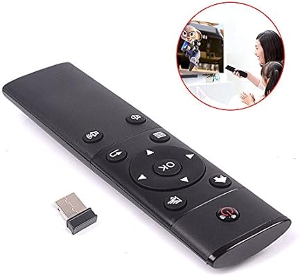

By the way, I’ve had the opportunity to try this cheap remote with my bedroom system:
and can confirm it works well with the extension. Only costs £5.99 (at time of writing) and uses RF, so doesn’t require line of sight.
