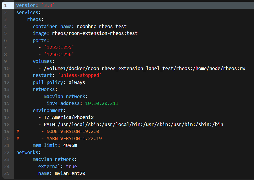

below is a screenshot of my portainer STACK compose
  1. i kinda lied about volume mapping :slight_smile: – i do sometimes map a child folder in the container called rheos so i can use portainer to get into the running image can copy the config.json to my sub folder so i can get it “out” of the image - you will see that mapping below - you dont need it
  2. i use a macvlan – so you will have to adjust the network to use host etc - since you use portainer, its easy and if not, i can create an example for you
  3. i am running the TEST image - i am almost always running the test image - i have the “latest” turned off as its my backup version back to 7.x of Peter’s app

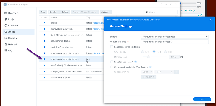

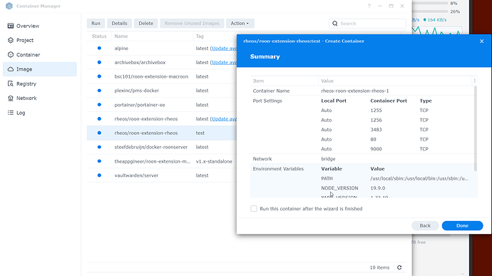

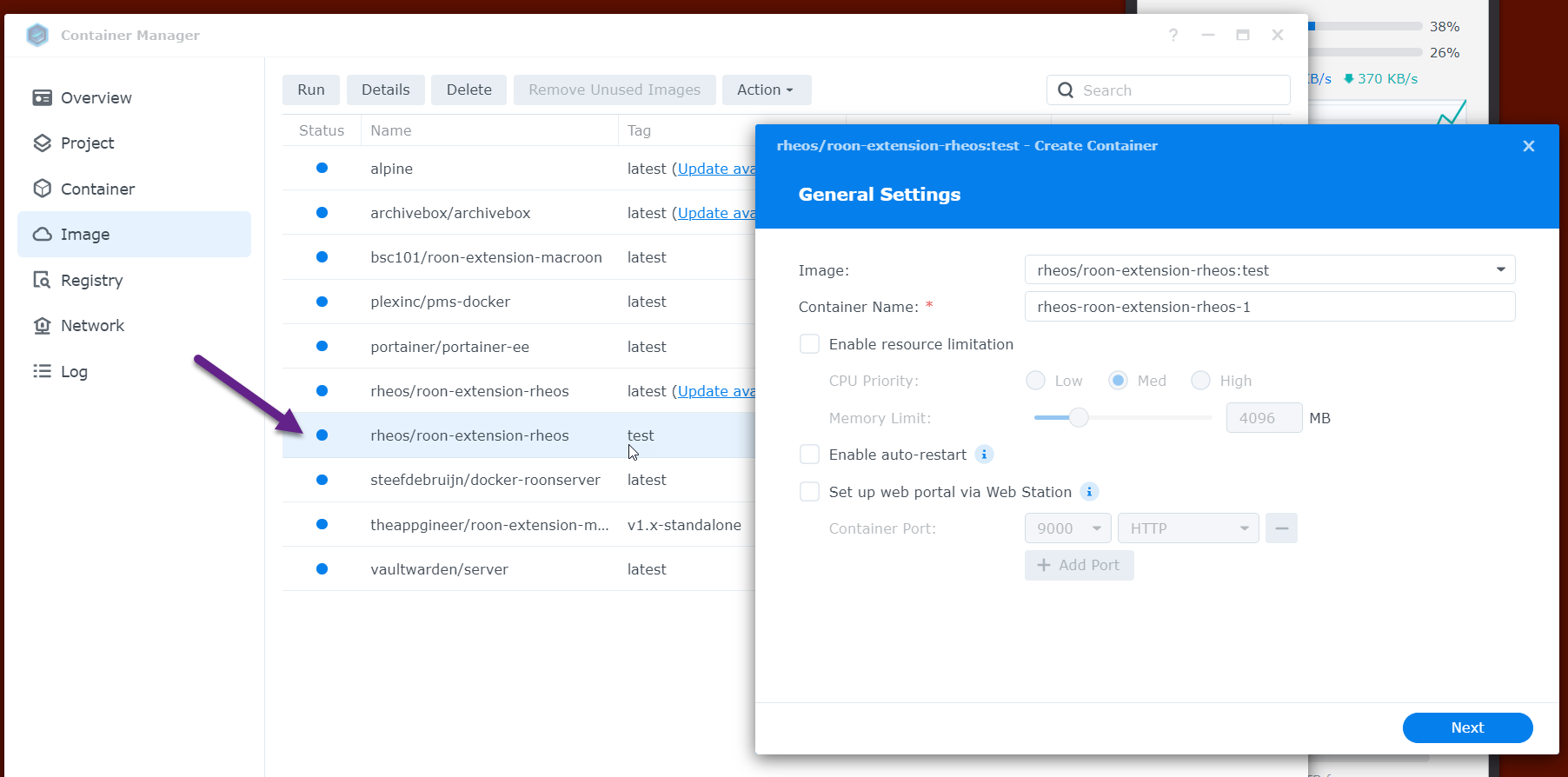

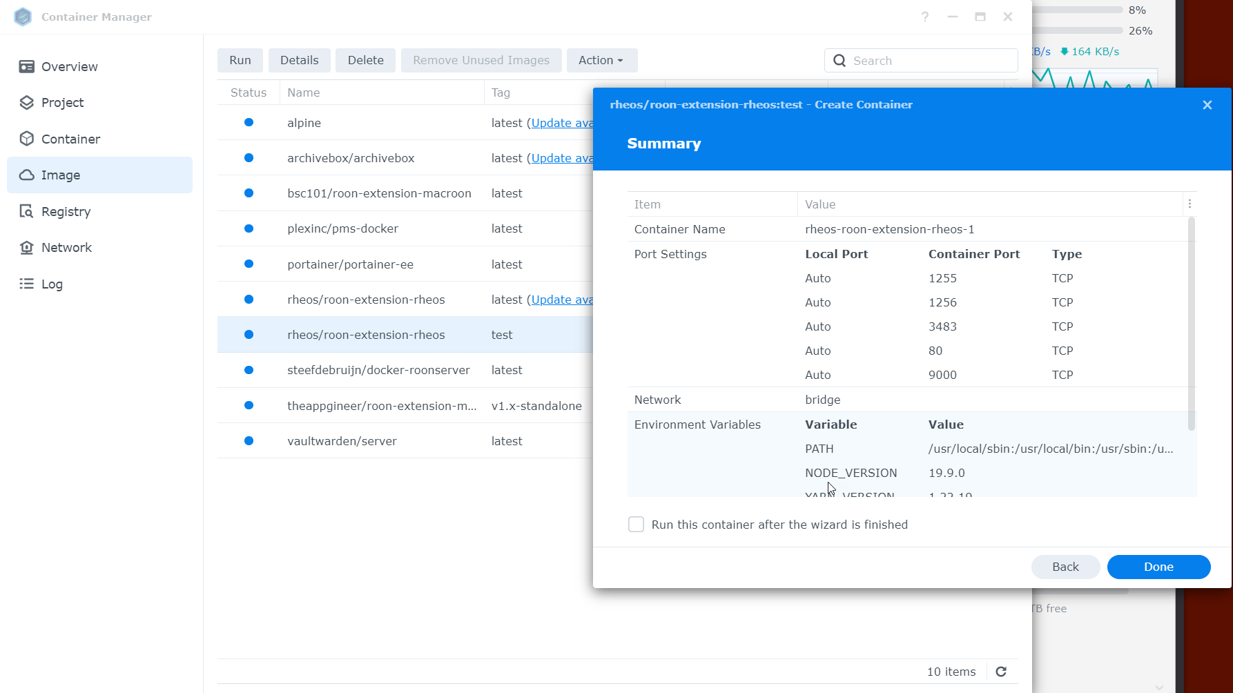

so i just ran thru it with the GUI - then started it, got your same errors - steps below (will follow up if i find anything to change during the config in the GUI):
Test image used and I did not change anything during the creation (just clicked NEXT)

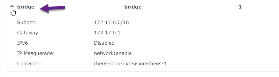

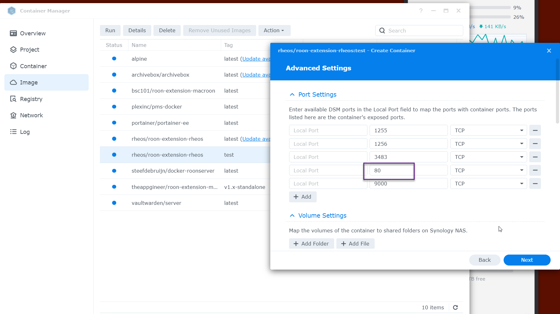

Noticing PORT 80 so you will see later on, it defaults to BRIDGE network
summary:
note - bridge was created:

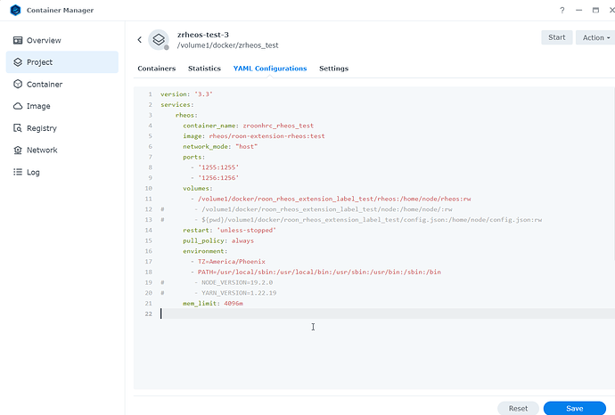

I built it via the project compose UI like so (image below):
  • i put this on the HOST network and it runs
  • it has errors in the log but stays running - this is because my ROON is on my macvlan network so the two apps never find each other
here is the text - doesnt always format correctly here in this forum (still beats typing it all):
version: ‘3.3’
services:
rheos:
container_name: zroonhrc_rheos_test
image: rheos/roon-extension-rheos:test
network_mode: “host”
ports:
- ‘1255:1255’
- ‘1256:1256’
volumes:
- /volume1/docker/roon_rheos_extension_label_test/rheos:/home/node/rheos:rw
- /volume1/docker/roon_rheos_extension_label_test/node:/home/node/:rw
- ${pwd}/volume1/docker/roon_rheos_extension_label_test/config.json:/home/node/config.json:rw
  restart: 'unless-stopped'
  pull_policy: always
  environment:
    - TZ=America/Phoenix
    - PATH=/usr/local/sbin:/usr/local/bin:/usr/sbin:/usr/bin:/sbin:/bin
- NODE_VERSION=19.2.0
- YARN_VERSION=1.22.19
  mem_limit: 4096m
I do have a few differnces. Im not using a project is one.

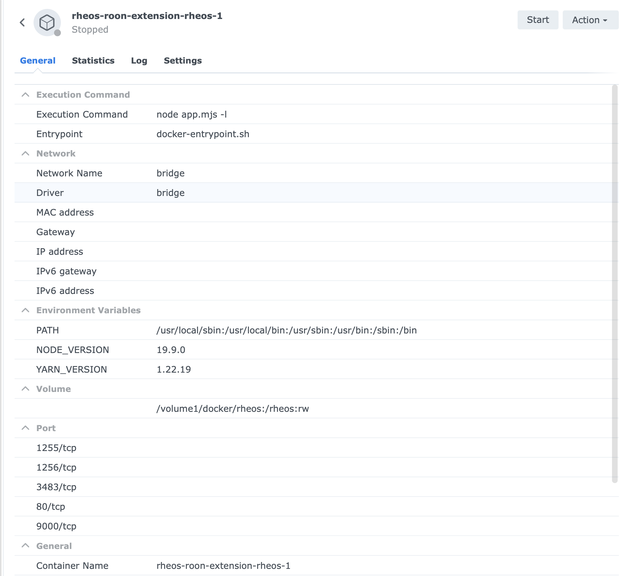

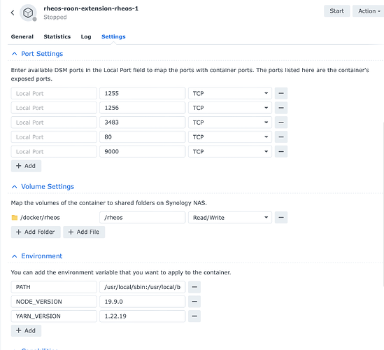

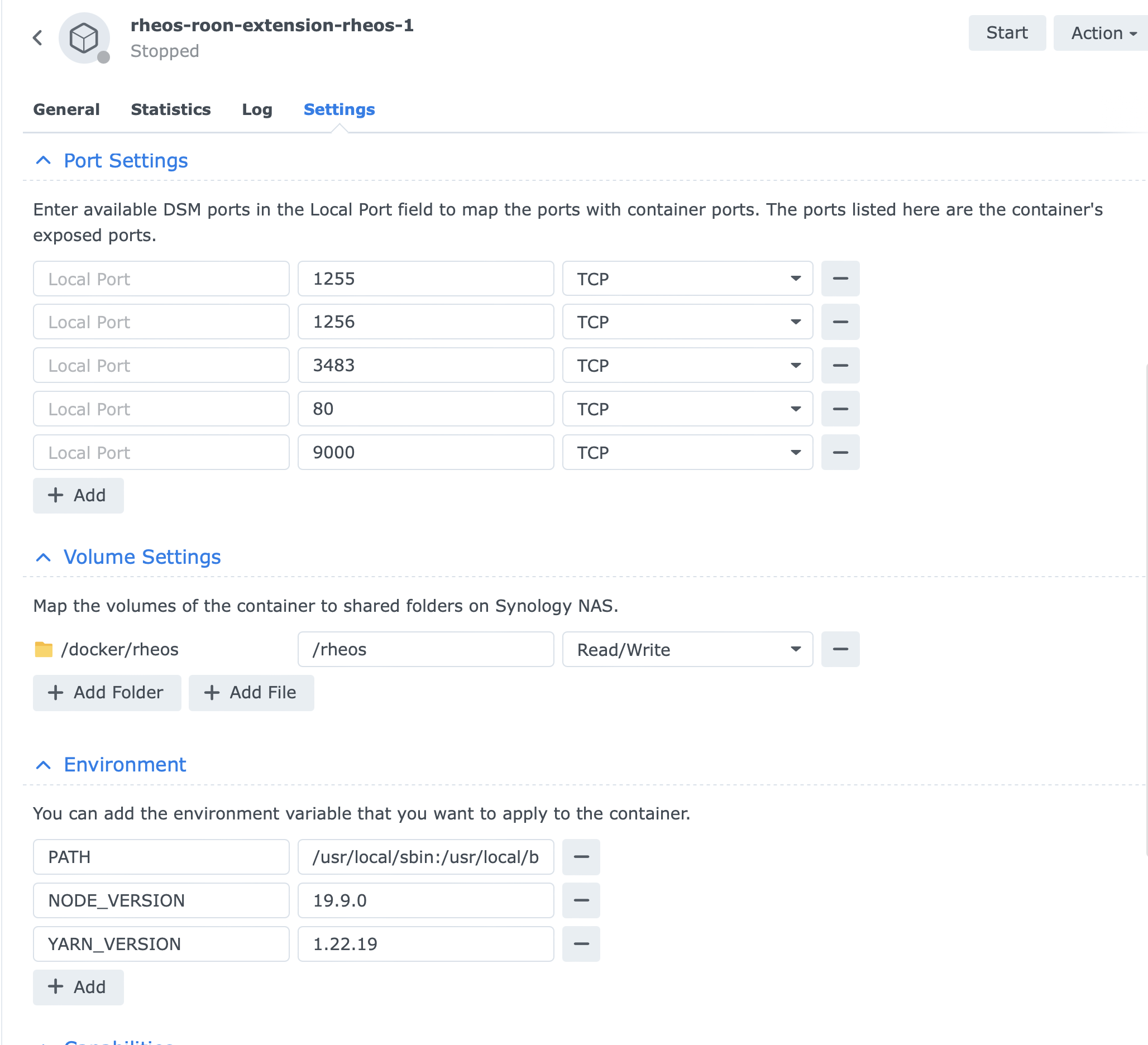

here’s some picts of the existing config.
I am also curious of the file structure, i assume i have my shared folders wrong.
