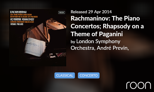

@peter_richardson I am yest again having issues with RHEOS not playing gapless. Can you try the album below for me to see how it behaves for you if you have Qobuz its available on there. I have local files and its the same for these or Qobuz, even tried the 44.1 version still the same get gaps after 2nd movement then get them again and again. Via other Roon zones no issue.
RoonShareImage-638415675989679625
If you can try playing from here as this seems to trip it up all the time. If you look at signal path whilst playing if it not gapless it will drop the signal between tracks. It seems to happen with the shorter ones only oddly. I can go back and start on a different piece and it will be ok on the gap then the next one will have a gap. If i go back in the track it will then play gapless over the track boundary. It all very odd and ruins something like this where a lot of them dont have breaks and flow from one to the other. Be good to know if its just my system or you or others can repeat it.
I can certainly confirm some strange behaviour with this album. On my system the shorter tracks end and then nothing plays for several seconds … the progress bar shows it’s searching …
When I transfer to the RAAT enabled Devialet nothing is playing at all
On a my M10NAD it seems to play normally.
Further investigation required, but I suspect its something about how the tracks in this album are identified. squeeze2upnp has special code for dealing with short tracks. I’ll take a look but not sure I can change much.

Good that it’s not me then. This is the same behaviour I flagged with you before but that’s been on regular tracks not short ones. I don’t want to use flow as it resamples all to a fixed rate. I tried different buffer sizes didn’t help.

Here’s the situation regarding squeeze2upnp and short tracks. according to Phillipe:
Handling of end of UPnP next URI and end of track is difficult because there is a lot of diversity between players. When the webserver has sent everything it should normally continues to linger and when LMS sends a new track we should use nextURI so that the player moves automatically to the next track when it has exhausted data with the current one. Sounds logical, but that’s not how some do
and they will NOT request nextURI but instead try to re-open the current one, especially if they receive a track with no duration and icy metadata. Although it is possible to rely on workarounds like refusing to reopen a fully served resource when requested again from the beginning, some players will still fail and cause a weird sequence that lead to false LMS “next” request and all sort of uncontrolled things. I’ve decided to never use the nextURI option, so no gapless when playing a track with no duration. This way, we’ll always expect a stop so the transition will be under control. Still, we need to refuse reopening fully served resourced when requested again from the beginning, which also is a way for the stop to happen, but without the uncertainty of what might be a stop in some cases or a real next in some others. Short tracks are also a problem and are gapped-in and gapped-out for safety. There is a need to delay the decision that the player has really stopped in case LMS has
not yet sent the new track, so a grace of 5s will be added after.
I will see what I can discover about HEOS and what could possibly be done in the specific case. But this will take some time!
I wonder if this is why I have had this on other albums to which are not necessary short tracks. I appreciate your efforts here.
