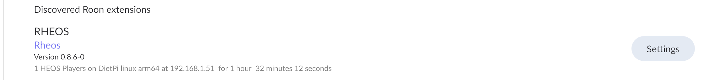

For those of you watching and waiting version 0.8.6-0 is now live in test and latest docker images, on gitHub and available via extension manager.
This version contains a rework of the code behind fixed groups that reduces the amount of time it can take to load and play the group initially. On occasion this can be several seconds but I have tried to optimize this and on my system I am pleased with the result.
I ANTICIPATE THIS BEING THE LAST RELEASE BEFORE COMMITTING THIS AS VERSION 1.0.0 and moving from Beta to launched.
I will then start updating the ‘test’ docker images and create a new github fork for anyone wanting to test as I develop the next version of RHEOS and see if I can anticipate any limitations that may come with the official Denon/Marantz ROON READY version (if this ever becomes a reality - i would like to still be able to use fixed groups and control some of the AVR features from ROON). I will be working on addressing some of the more complex limitations imposed by using lms2upnp and seeing what I can do - this will be experimental for a while so be warned as I experiment with the source code!
Let me know if any unanticipated bugs are found in this release and I will address before launch.
Thanks to everyone who has contributed to date.
