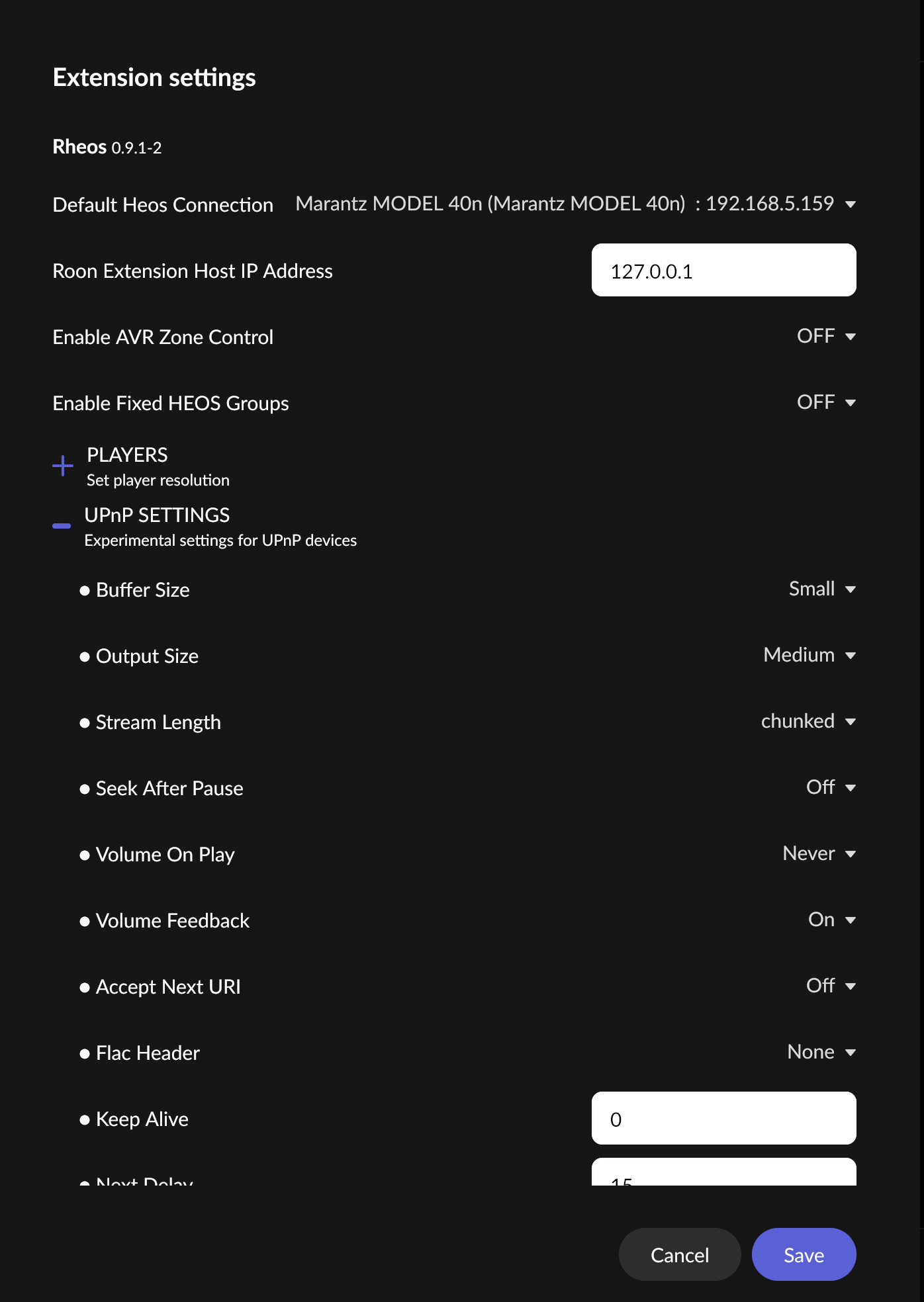

See what happens if you turn off AVR control in settings and then switch it back on. That should recreate the zones.
See what happens if you go to device setup (via the cog next to the AVR volume control) and select load defaults. This will remove the controls from the AVR that create the zones and you can then refresh them by adding the volume and source controls again.
Check only one version of RGOES is enabled in the extension settings.

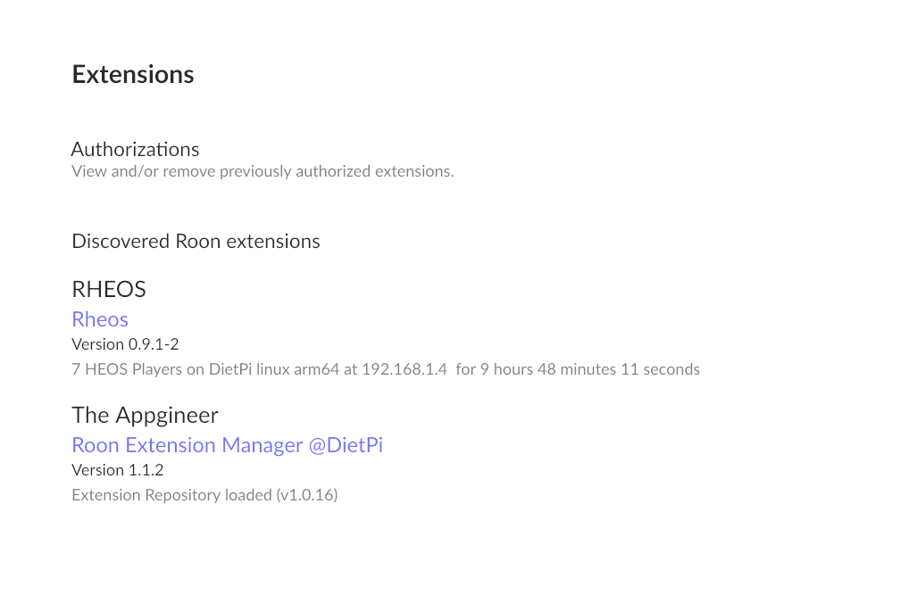

Roon tells me that I’m on the latest version. See screenshot.
Your comment about the other receiver’s zone 2 options got me thinking, so I added external source controls for the other two receivers. When I did this, the patio zone 2 control appeared, but no others. When I tried to play a song on this zone, the zone disappeared. I am completely confused now. Log below…

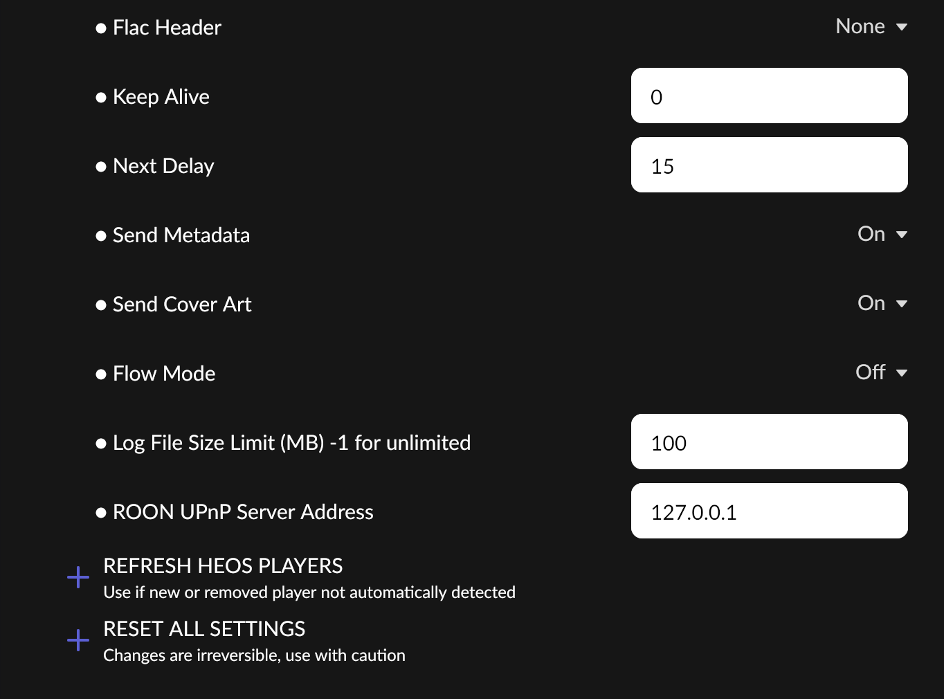

Ok, now I may have been a little confused on how to get logs. I didn’t select " collect logs" the last time before clicking on the link to download. Sorry about that…
Here is the β€œcollect logs” version

Thanks Kent,
This helps enormously.
I’ll see if I can replicate the error thats reported on finding zones when I get back home and try to get a fix out this weekend if I can sort it out. Not sure what has changed and why this isn’t on all your receivers so I may load some extra logging to explore,
Best
Peter
@peter_richardson as mentioned in the other thread, I have always had issues with the supposed two way control. It just has never worked on my Marantz.
RHEOS settings not really changed anything if this is off help or their is differences to yours.
Thanks. 'll take a look at this again and see what I can now do.
I think its more to do with the use cases we have. I rarely, if ever, use the HEOS app and never use a remote to control my receiver. So the original concept of 2 way control became less of a priority for me and my have regressed as I’ve been expanding other areas.
