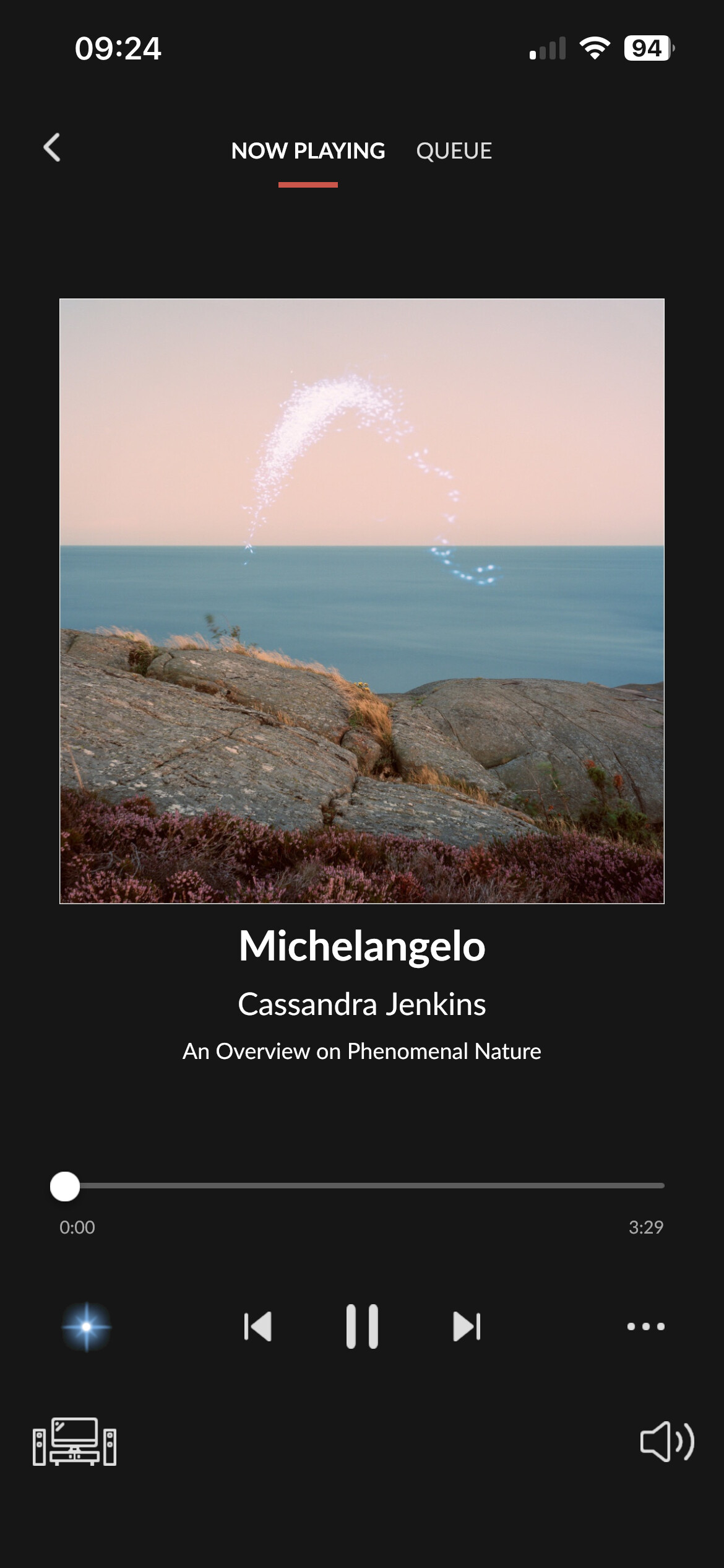

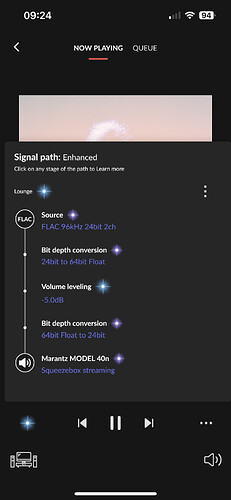

Still broken.
got it working for a bit last night but the update has broken it again.
Roon believes its playing signal path all good, but no sound or track movement.
Rebooted machine no joy. The only things that’s changed recently is Roon and the extension.
