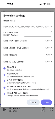

I realized I had already put in a feature to address this issue which relates to the HEOS system feeding back volume changes whether on airplay or RHEOS to both.
Look in the extension settings and you will see "turn off 2-way " control. That should fix it - but you wont be able top control some of the ROON features from the HEOS app.
Please let me know how it works for you.
Thanks.
Thanks Peter,
I turned that off, but still the playback stops when I try changing volume through Airplay playing
