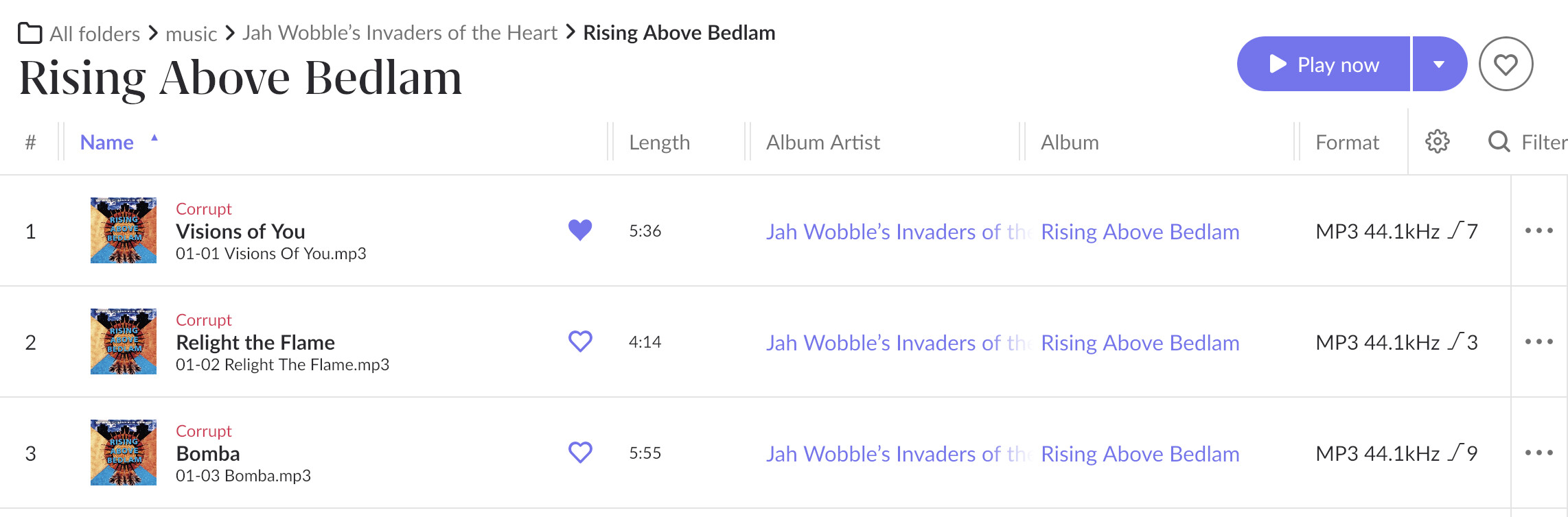

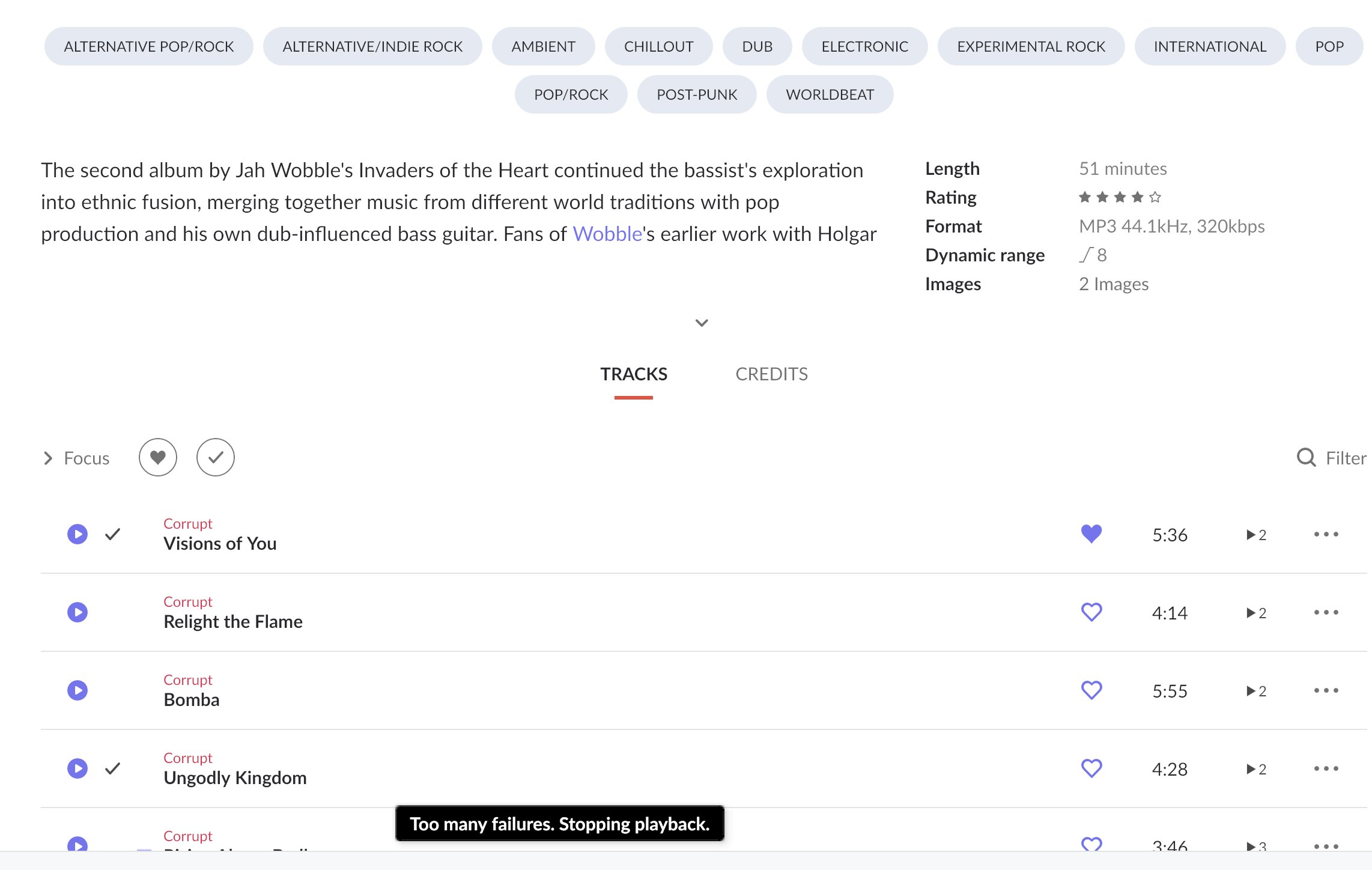

I added an album recently and have played it, at least twice, all the way through in Roon.
Today Roon says all tracks on that album are now corrupt. The tracks (.MP3s on a NAS) all play fine in both Swinsain and VLC Player from the same location.
I hit the ‘re-analyze album’ button but Roon still claims the MP3 files are corrupt.
Any ideas?

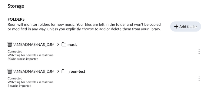

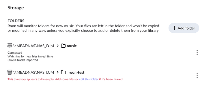

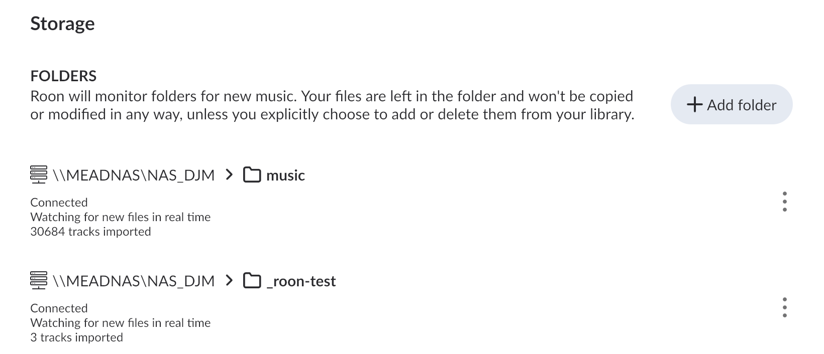

By a “fresh folder” do you mean create a folder and add it in the settings > storage screen of Roon?
Hello @davidmead
Так, exactly that — go to Settings → Storage, click Add Folder, and point it to a brand new empty folder (not one you’ve used before). So you’d just download his replacement files into that fresh folder, not copy your originals there. That way Roon treats them as completely new files instead of matching them against the cached “corrupt” entries it already has for the originals.
@benjamin will update you with the password in the DM
Thanks @vadim . I’ve created a new folder and when I hear from @benjamin I’ll drop the new files in there.

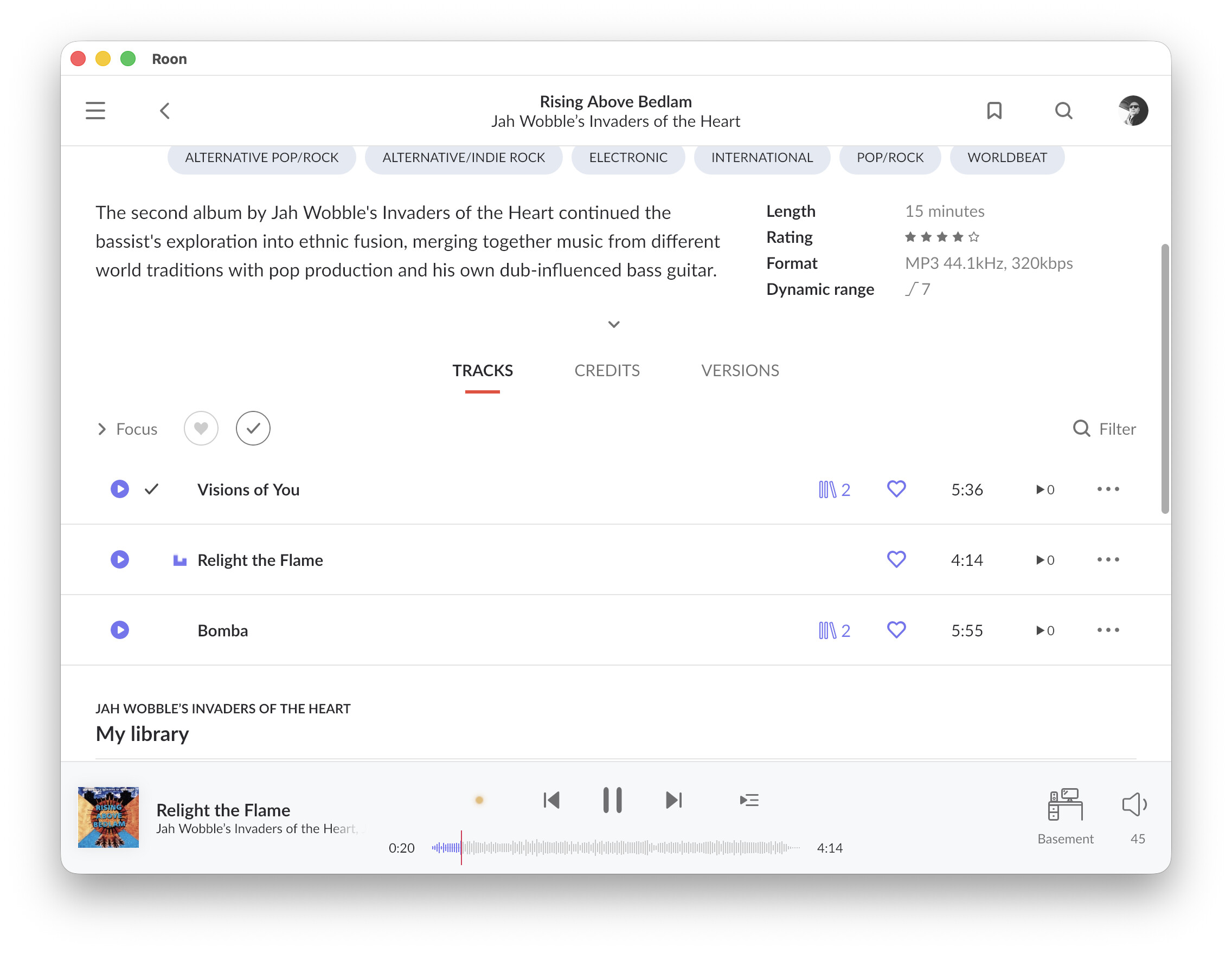

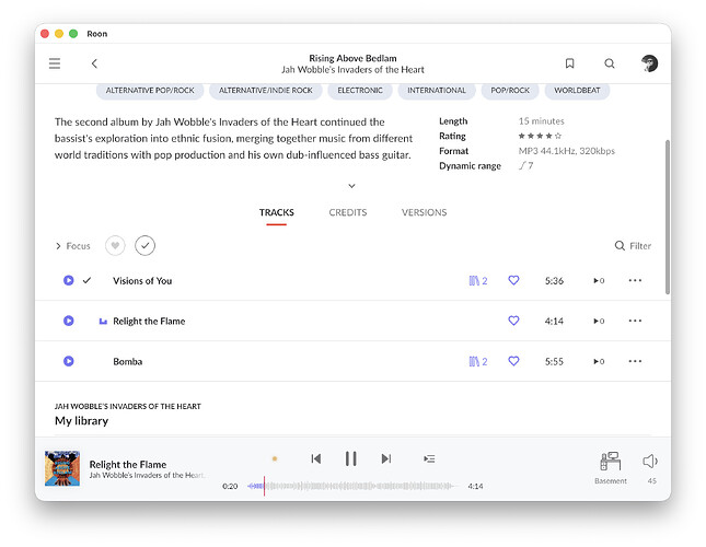

@benjamin @vadim I grabbed those files. Dropped them in the new folder and Roon is now playing them fine. It seems to have identified the album and assigned cover art too.
What should my next steps be?
