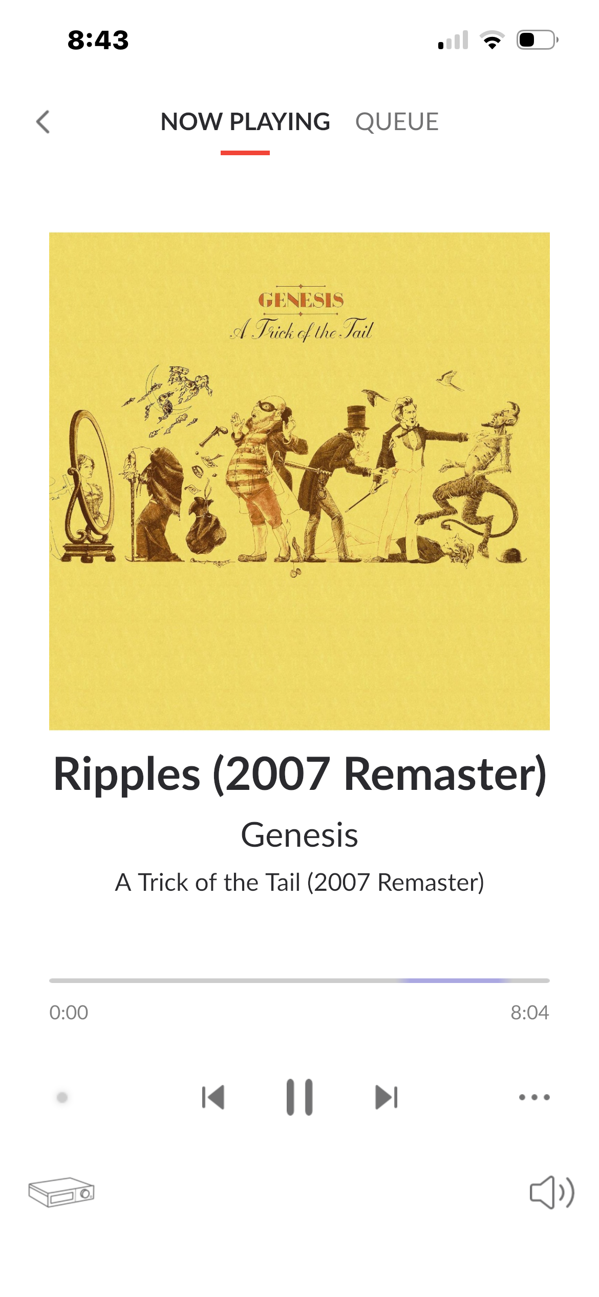

· Songs on album will not play. When listening to an album, which is occurring often recently (did not have this issue in previous years when using Roon).
Roon will freeze up and not play the next track. (I can get the track to play on Qobuz (via Qobuz Connect) which is the music service I use for Roon; however, it will not play on Roon.
Example: Genesis album “Trick of the Tail” the album will play all the tracks in order until the song “Ripples” at which point Roon will not play the track.
The animated symbol (usually twinkles like a star) at the bottom left of the song page does not animate, or twinkle.
· Cambridge Audio EVO150 and Edge NQ, connected via Ethernet to Toom Nucleus.
