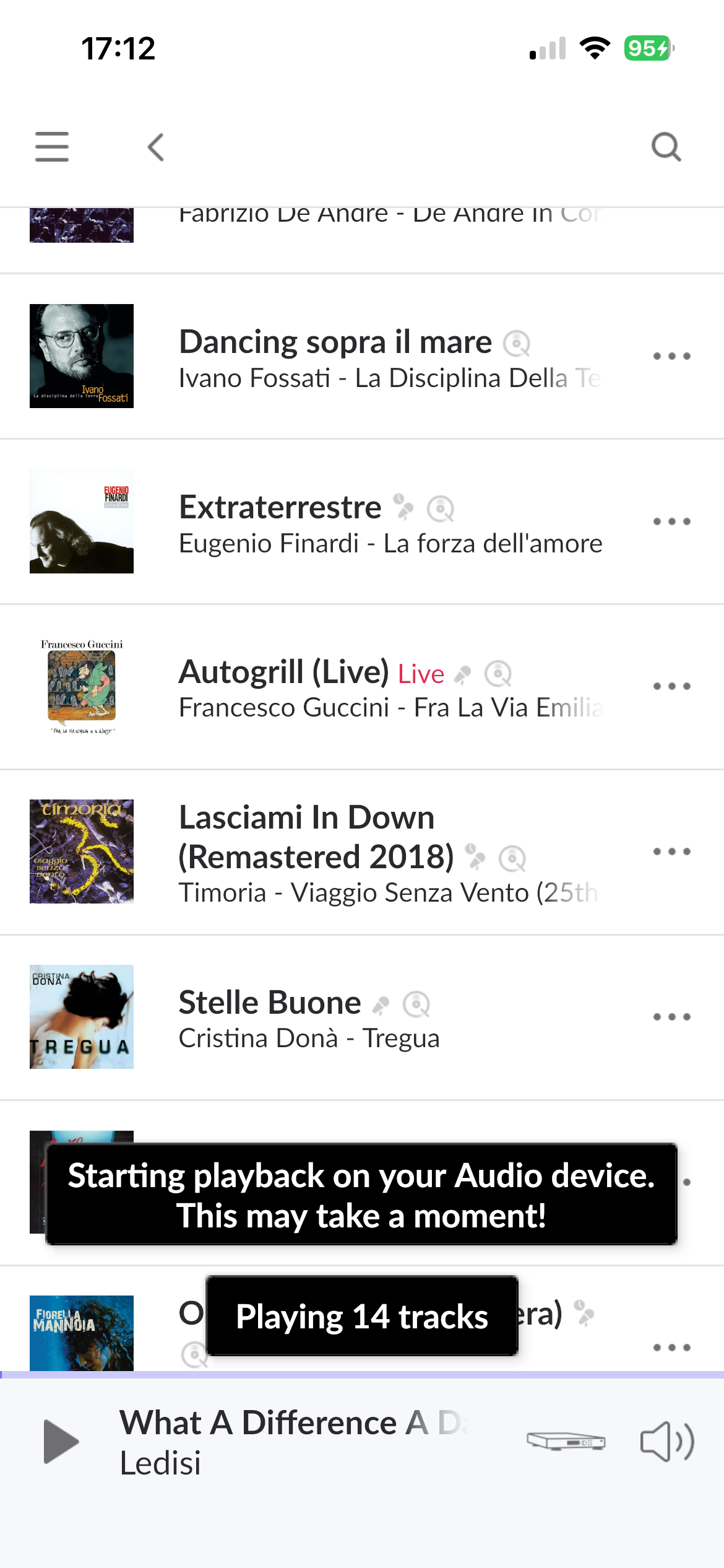

I do see my full library, my play lists but when asking to play one song it will not start and this message is posted“ Starting playback on your audio device. This may take a moment!“ sadly the music doesn‘t play at all! Thank you for your support. Paolo
I use the Nucleus Plus (SN54B2030BBAC3) linked to the WLan Box by cable. I run from the WiFI WLan box a Network cable to my Bricasti Design M1s2 DAC.

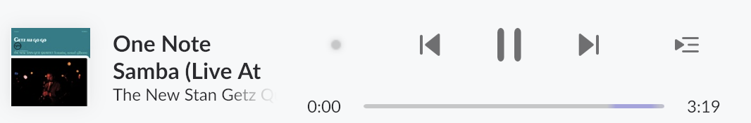

I stream 98% of the time using Qobuz through Roon. The past month or so music just stops playing! When I look into my Roon app on my IPad to see what’s up, I can see where the song time is shown at the bottom of the app. It looks like a cursor going back and forth with nothing playing. I’ve done numerous speed tests. I’m just shy of a gig of bandwidth.

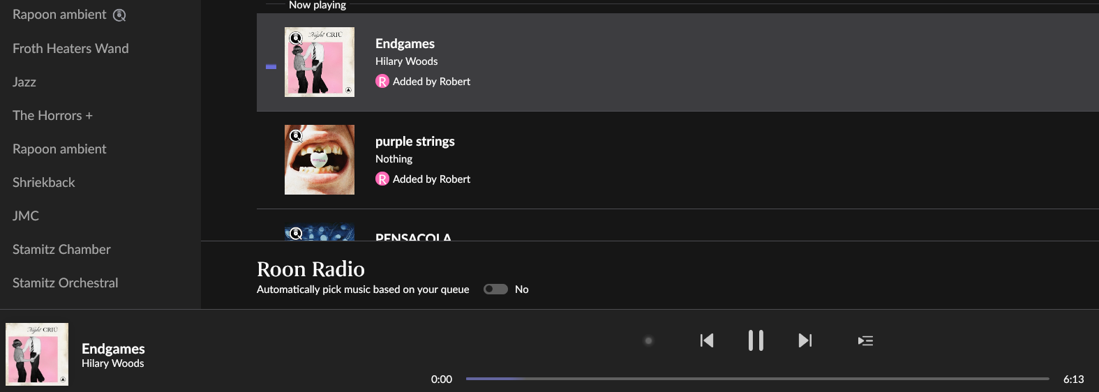

Same here. Roon simply won’t play “Through the Morning, Through the Night” from Robert Plant/Alison Krauss “Raising Sand” in the default 24/96 version. The progress bar sits there pulsating forlornly. Other tracks on the album play okay. If I switch to the 16/44.1 version that track is fine.
