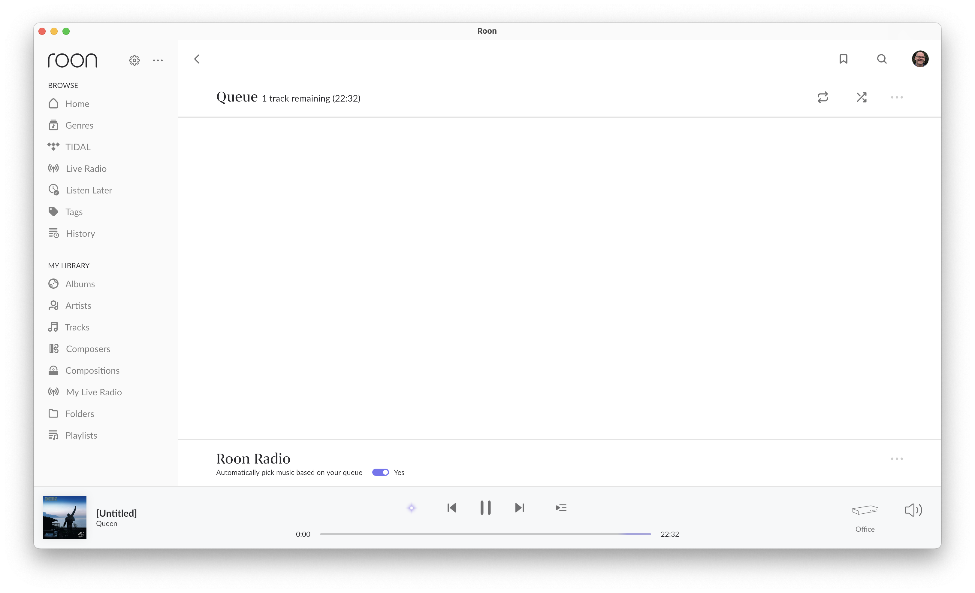

Roon got stuck transitioning to the next (last?) track in an album. When I tried to look at the queue to see the past/future, I noticed the track position indicator bouncing back-and-forth. The queue never loads, and I can't toggle the play/pause button. I can change zones, but trying to look at those queues also does not show anything. Roon is effectively frozen.
All Ubiquti hardware, everything connected via Ethernet

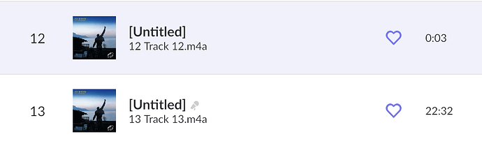

I take it back. After rebooting I can see there are two “[Untitled]” tracks:
One is suspiciously short, the other suspiciously long. Probably a ripping error?

These tracks were a “conversion” of an SACD .iso file into ALAC tracks, using XLD. When I look on the server, I do see tracks 12 & 13 are the two files, 1.2MB and 384.4MB.
Looking at the ISO, it appears the embedded playlist has a “gap” track, and then jammed the bonus material into one bigger track.

Thanks for the follow-up! We’ve run into similar issues in the past where Roon has a difficult time handling very short tracks (under 10 seconds or so) and so, if you temporarily remove this short track from your queue, do you run into the same issue?

I can confirm that playing the same album, Roon hung after playing the 3 second song (Track 12), before starting the 22:32 song (Track13). Deleting the 3 second song, and restarting Roon, I was able to play Track 11 then 13.
