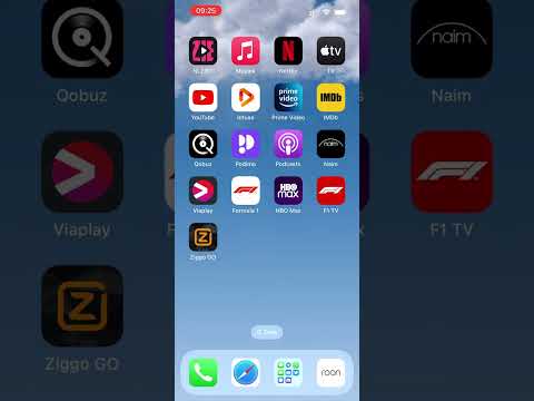

I made a small video to highlight the issue:
This is a know issue and I am surprised it has yet to be fixed considering it’s far from pleasant and dangerous.
