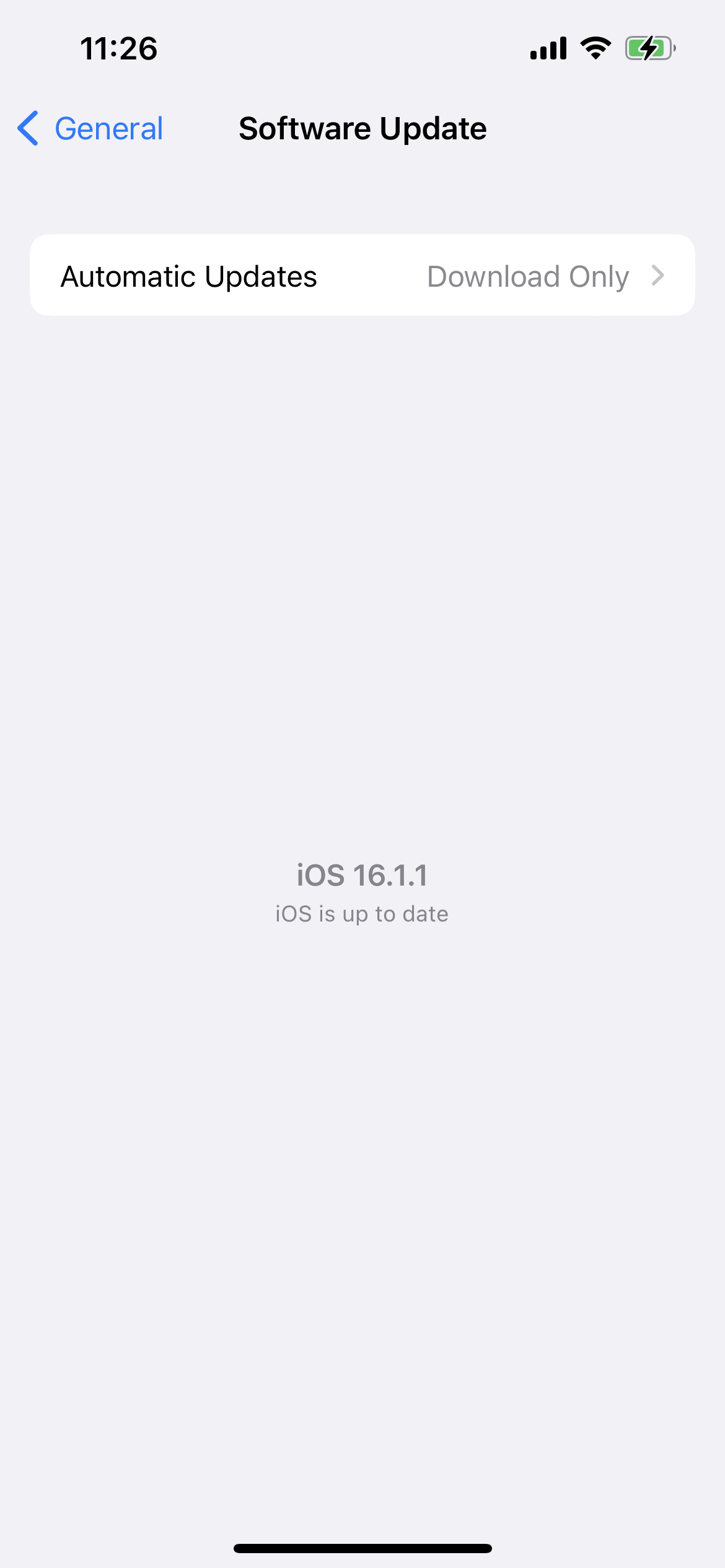

Did you mean 16.1? I just updated to 16.1.1 and that appears to be the latest version:
But the exciting news is Iām happy to report that, at least for the moment, updating to 16.1.1 appears to have fixed the issue, and my iPhone volume is now staying at 5% as I move back and forth between Roon and other apps!
