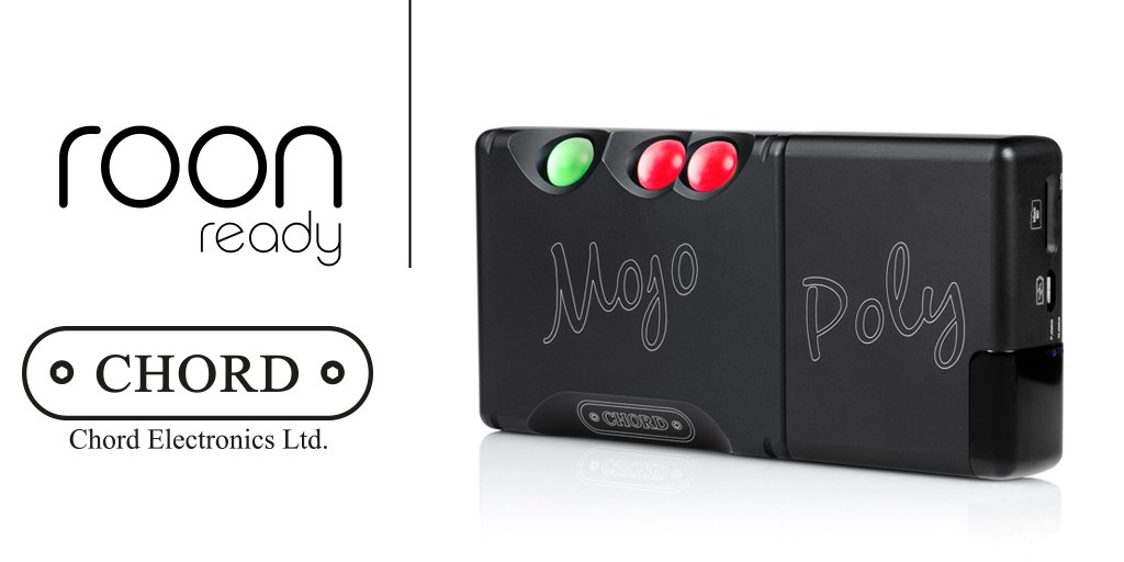

Chord Poly+ Mojo seem just a perfect portable headphone endpoint for Roon, but reading through the threads there seems to be a lot of problems too. It seems there is some progress being made:
Are users still having problems or have things improved? Interested in getting one but don’t want to spend my time solving technical problems. I would get it solely for Roon use so I don’t care about the other software features.

Thanks for your reply Fordski. Nice to hear that you are quite satisfied with the Poly. I’m a bit surprised that Poly got the Roon ready label if it still has the same disconnecting issue. I thought Roon ready means flawless operation. Are you running latest firmware on Poly?
