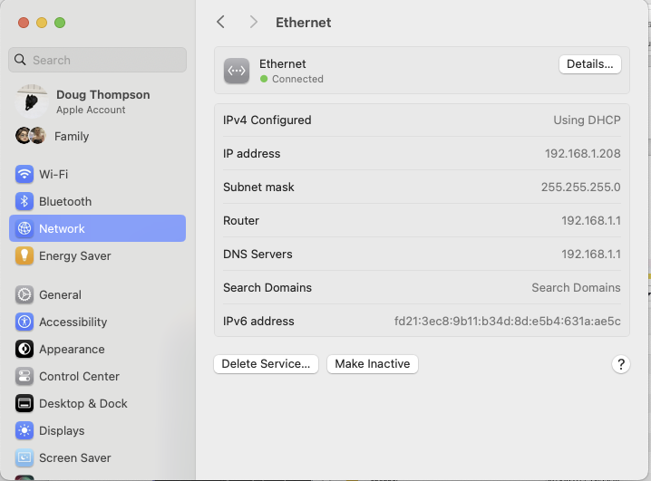

I have an Asus Router, Rogers Modem, D-Link Switch, QNAP NAS. Running all CAT 5 cable.
Router is setup with three wireless networks.
The NAS and Mac Mini are hardwired to the router.

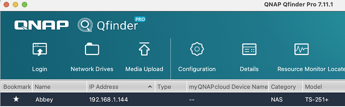

The QNAP has a fixed IP address.
The Mac Mini has a fixed IP address.
Am I missing anything?
Did you use DHCP address reservation on the router to provide the fixed addresses or did you set up the fixed addresses directly on the devices? If directly on the devices, did you exclude these fixed addresses from DHCP assignment on the router to ensure the router doesn’t assign them to some other device?

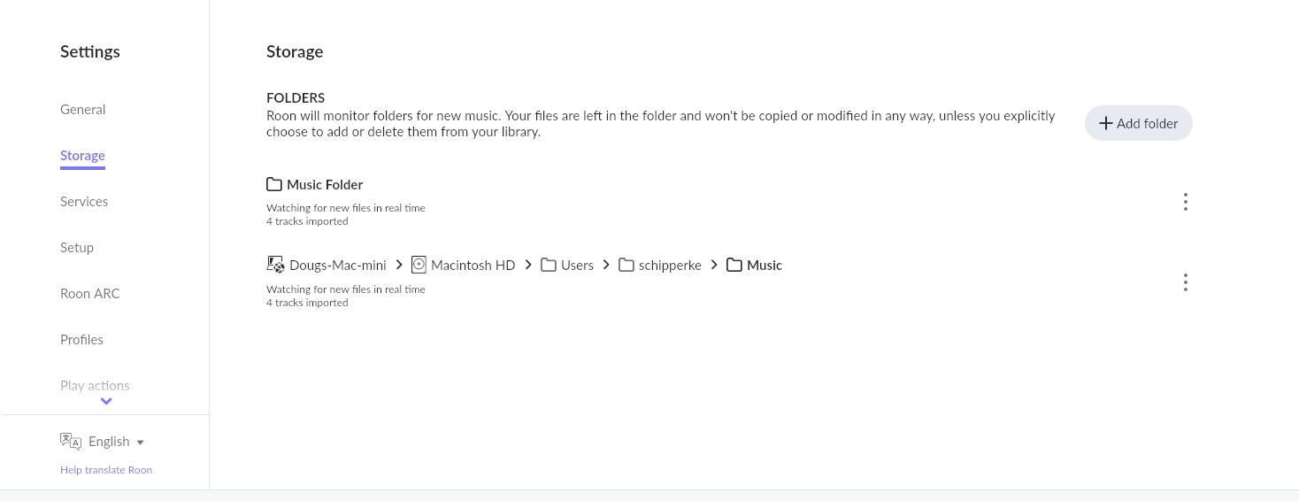

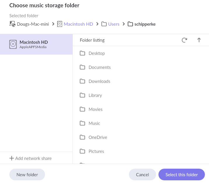

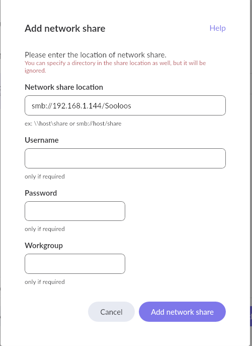

Start Roon
Click on Gear
Click on Storage
Click on Add a Folder
Click on Add network share
Enter the credentials
This always fails.
NAS IP Address
NAS Music Folder
Mac Mini Network setting

  2. QNAP is plugged directly into the Rogers Internet Modem.
  3. QNAP has a CPU J1900 Mhz (4 cores, 4 threads)
  4. Asus Router is plugged into the Rogers Internet Modem and boasts three separate wireless networks: Aristotle, Plato and Socrates.

  7. I have tried both smb and host.
  8. For a short period of time smb did connect to the QNAP.

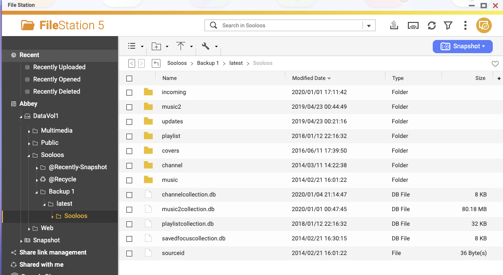

if you are accessing the NAS:soolos folder from mac you might want to check that its a shared folder in your qnap. You find it under control panel/Shared folder.

Definitely double-check your shared folder settings on the QNAP side, as well as on the Mac side - here’s a helpful article outlining settings via your Mac:

Through a lot of hit and miss trying this and that I finally got the Mac Mini to connect with the QNAP. The solution was QNAP admin name and password. (I thought I had set things up to by-pass this.)
