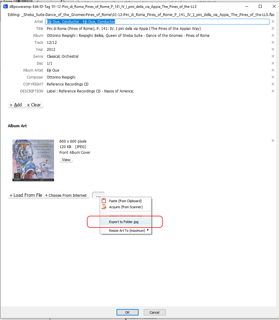

You can also use dBpoweramp to export the cover art tag from a WAV file to create a Folder,jpg of the cover art in the album folder. Roon will definitely see these.

Dylan, thanks. I should clarify what I really need. I know from trying that putting a .jpg in the folder with the audio files will work for Roon. But since I have, by my estimate, some 400-600 albums with missing or incorrect art, I’m looking for a process that is most amenable to batch processing, so I don’t have to drop in new art for each one. It sounds like using dbpoweramp to convert wav files to uncompressed FLAC may fit that bill, if it also achieves the goal of making it visible to Roon. (As a side note, Mark Jenkins at Antipodes alerted me to the fact that FLAC has some sort of built-in error correction against the inevitable degradation of magnetically stored binary info. wav does not, according to Mark).
So I am going to investigate that. I will keep you posted. Thanks. – David
Well Geoff, I think you have put me on the right path. I converted 2 albums that were in wav (with no art displayed) to flac. Sure enough, Roon displayed the art correctly with the flac files. Now here’s the weird part - Roon no longer “sees” the wav files, which are named exactly the same as the flac files, even though the wav files are still in the same directory. I thought I’d have duplicates. I’m guessing Roon has an algorithm that defaults to the most recent file when dupes are loaded. Thanks for your help. David
